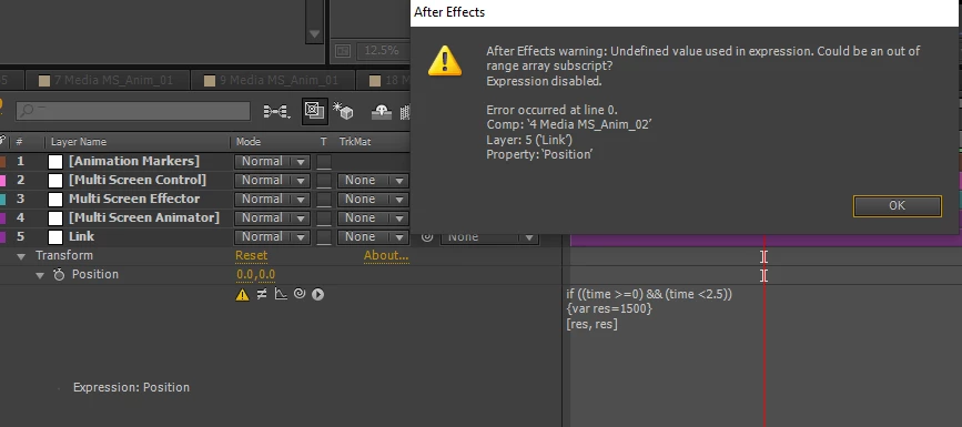

I run into a weird issue and something non intuitive:
I applied this simple simplified expression to a property, however I get an unexpected error message.
if ((time >=0) && (time <2.5))
{var res=1500}
[res, res]
"Undefined value used in expression. Could be an out of range array subscript?"
I wonder what's causing this issue, aren't we allowed to compare the "time" variable to other values and use in a conditional statement?
I appreciate your help, if you can point me on how to correct this, or how to use someting else to get the same result.
Thanks for passing by this post.
Correct answer Mylenium
Well, the code does not have an else() statement or any other fallback, so naturally the expression will break if the time is larger than 2.5 seconds or similar conditions. I suggest you brush up on generic JavaScript syntax and expand your code. You can't be sloppy with these things.

Mylenium
MyleniumCorrect answer
December 23, 2021
Mylenium

Abdelkrim Ibrahim
December 23, 2021
Yeah you're absolutley right about the else statement.
I figured it out, there should be defined values all over the time of the composition, leaving some parts of the compositions's time without defined values will cause such error.
This is the solution that came up with.
var markerIn = thisComp.layer("Animation Markers").marker.key(1).time;
var tStart = markerIn-1/2 ;
var tEnd = markerIn+1/2;
var markerInA = thisComp.layer("Animation Markers").marker.key(2).time;
var tStartA = markerInA-1/2 ;
var tEndA = markerInA+1/2;
var valueMin =thisComp.layer("Multi Screen Animator").effect("Position 01")("Point").value;
var valueMax =thisComp.layer("Multi Screen Animator").effect("Position 02")("Point").value;
var valueFin =thisComp.layer("Multi Screen Animator").effect("Position 03")("Point").value;
var res = valueMin;
tVar = time;
if ((tVar >=0) && (tVar < tStart))
{res = valueMin}
if ((tVar >= tStart) && (tVar <= tEnd))
{res=ease(time, tStart, tEnd , valueMin, valueMax)}
if ((tVar > tEnd) && (tVar < tStartA))
{res=valueMax}
if ((tVar >= tStartA) && (tVar <= tEndA))
{res=ease(time, tStartA, tEndA , valueMax, valueFin)}
if (tVar > tEndA)
{res = valueFin}
res
Thanks for you help.
