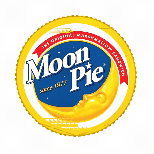

I can't figure out how to remove the glitching. It appears on both the image layer (top) and the solid color layer behind it, but only when it is facing the front, the back side is fine. The ony layer the glitching does not affect is the bottom solid color layer (the ribs of the coin). Does anyone know why it is doing this, and how to fix it? Thanks in advance.

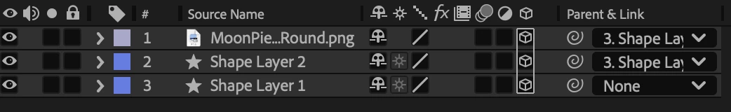

Try moving the logo layer in Z Space by at least one frame. Select the layer and grab the Blue handle and drag. Refer to the screenshot.
Let us know how it goes.

Do you have two 3D layers?  It looks a lot like the glitching that happens when 2 layers occupy the same 3D space.
Sep 22, 2025 9:46 AM UTC
Hello and thank you for your reply. Yes, all 3 layers are 3D layers.
