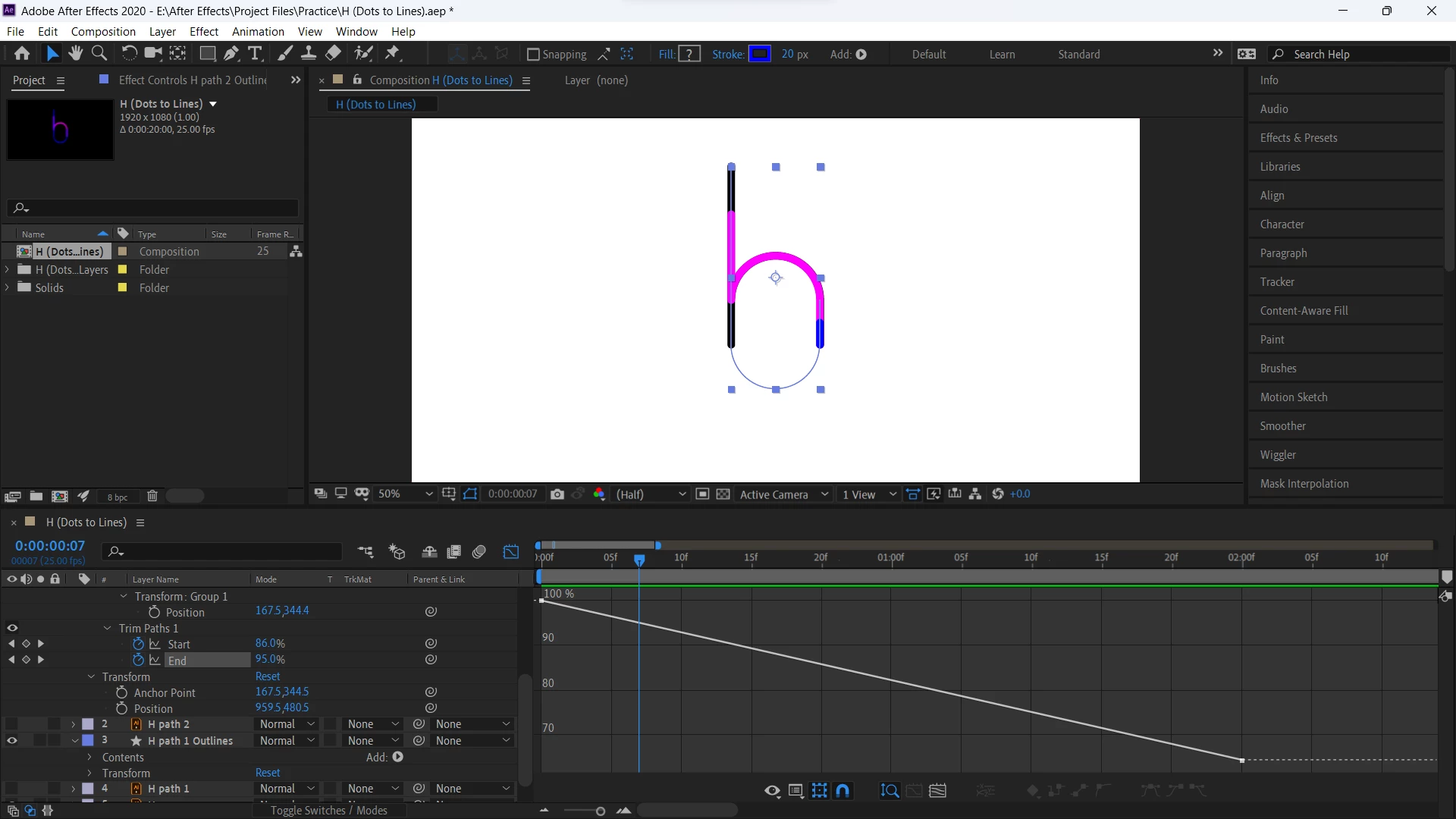

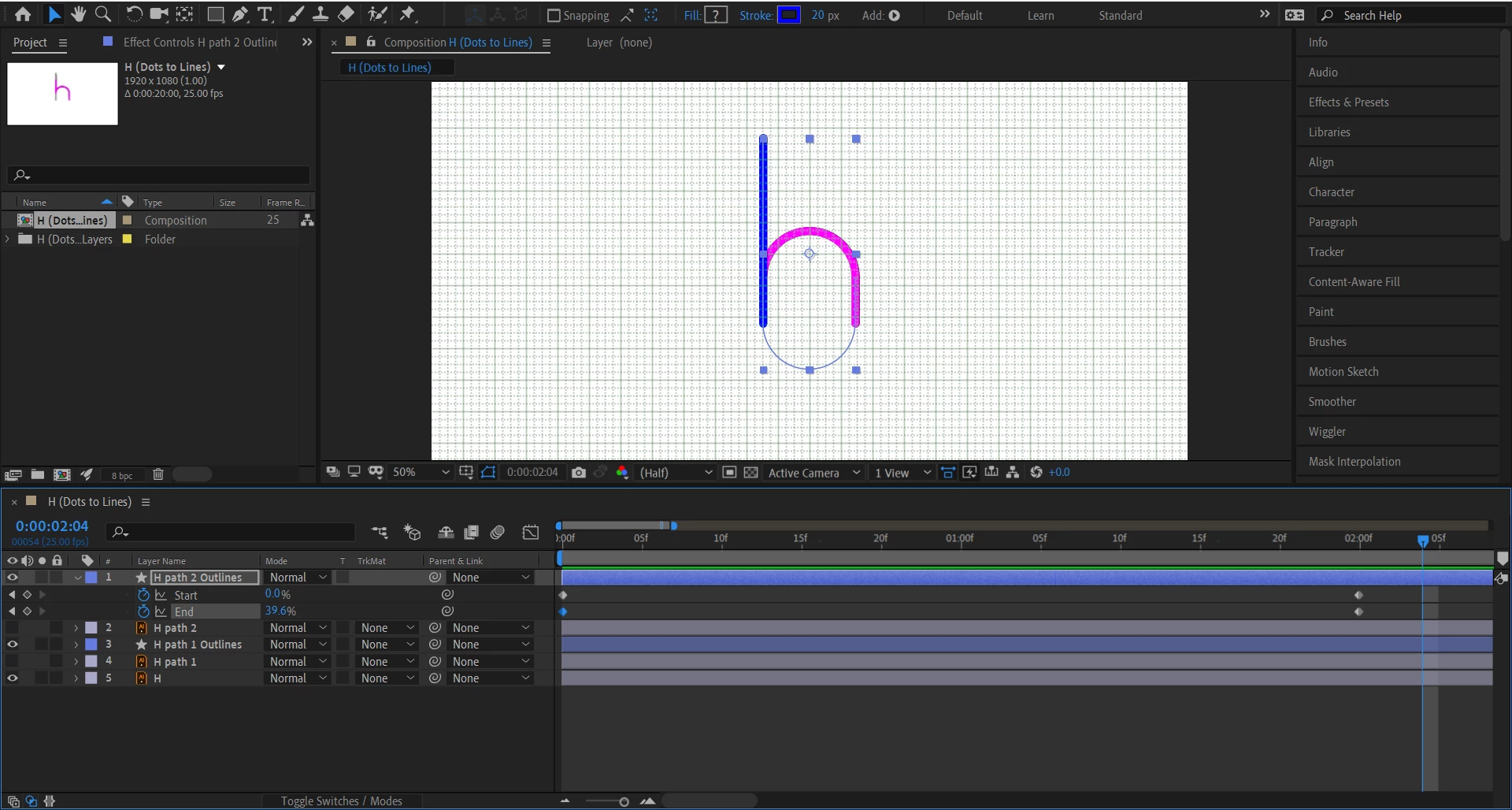

I am trying to make a very simple movement of a line from point A to point B. But there is unwanted movement between keyframes. There are no keyframes in between yet it is moving. I have attached screenshot of the timeline as well as the video. Please help.
Also, when I try to do spatial interpolation - linear, my spatial interpolation option is greyed out,
Please help. Urgent!!

Thankyou for replying. I have set temporal interpolation to linear. Still it is moving. Can you help me solve this issue. I request you to watch the video if you don't understand my problem.
I am even attaching the graph below.

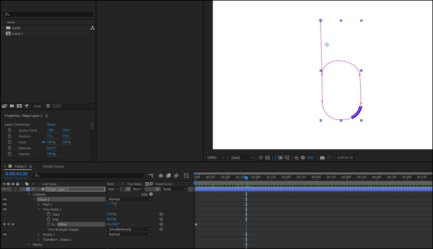

I think what's happening here is that by animating both the start and end properties at the same time, you're effectively changing the length of the blob so that it appears to move backwards.
It might be simpler to set the lengths for Start and End and keyframe the offset instead.
