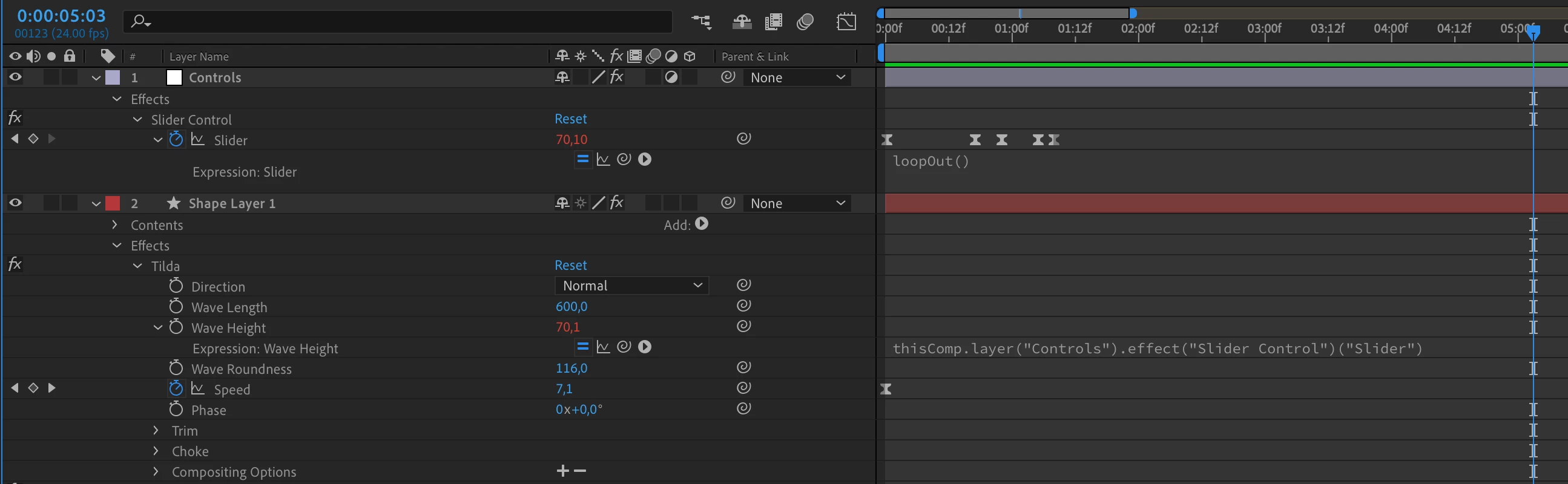

I have a few layers that use an effect to create waves (it's called Tilda, but that's not important).
On top of those layers, I put an adjustment layer with a slider control, linked all the 'wave height' properties of each layer to it, and created some keyframes on that slider control to make the waves bigger and smaller. I've looped those keyframes using the loopOut() expression.
So far so good. Waves are going up and down until the end of time.
Now, I want the effect of that slider control to grow over time / I want the waves to become bigger and bigger. At first I want it to have no effect, at the end it should be at 100%.
Can I use a second slider control to manipulate the impact of the first slider control?
