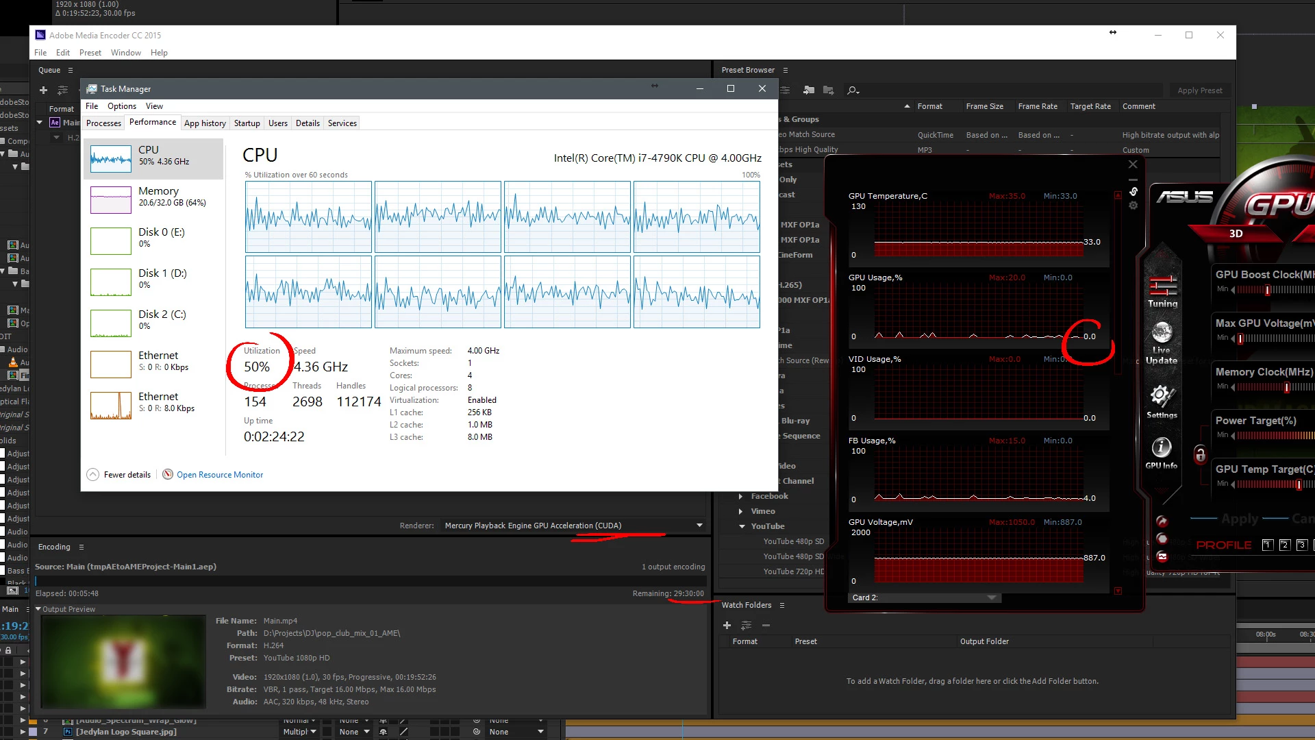

I am trying to export a 20min video I made in After Effects. It has a few Particle Effects and a few Audio Spectrum Effects. When I start a Render, it shows between 20 to 30 hours to complete. If I had multiple machines I would have no problem with that, but I dont so.

I have noticed that AME does not use all the power it could. It uses around 50% CPU but I read that may be because it does not have the time to ramp up before getting to an other frame.
I have also notice that even using CUDA acceleration, AME does not use the GPU's power AT ALL. I have two GTX780 and I am pretty sure that if it was using them it would speed up a lot, but I dont know if it can use them and if it can I dont know how to activate it.

Specs:
  • i7-4790K
  • 32Gb RAM
  • 2x GTX780

The GPU is not used for rendering 99% of everything that AE does. If you use the AME to render a comp from AE then AE runs in the background so AME has to leave some resources for you to do other things. Using AME is always slower than rendering with the Render Cue if you are going to the same format but for most of us this is not a problem because we don't sit around and wait for renders, we work on the next shot or move to another project. That's the advantage of the AME, you never have to stop creating - the stuff you get paid for.  If it's a rush to get the project out then render with AE's Render Cue to a fast rendering production codec and then run that through the AME because AME is much more efficient and faster at transcoding video to another format.
As far as general AE stuff goes, temporal effects take the longest to render, Particles also take a long time to render. Ray-traced rendering with CUDA acceleration is absolutely not supported in the AME even if you have a properly configured NVIDIA GPU. I don't know any professionals that use Ray-traced rendering for anything. There are much better solutions even without 3rd party effects.
I hope this helps. The fastest way to get something out the door is to render to a standard production format using the Render Cue and a fast to render format making sure that you are using standard production formats for all of your assets in the project ant that any images used in your composition are at 100% scale at some point in your comp (lots of folks try and make slide shows in HD with 20 MP images from a DSLR and all of them are scaled way down). Once you have your standard production format master rendered drop that in the AME to generate your deliverable.
Currently AE will not use 100% of your system resources when rendering HD or even 4K video because AE only looks at 1 frame at a time and any modern CPU can easily process that one frame using a fraction of it's power. Then it has to start calculating all over again. Certain effects will use up more memory an temporal effects and particles can quickly fill up memory but until the basic architecture of AE's rendering engine is completely overhauled we're stuck with slow renders.
