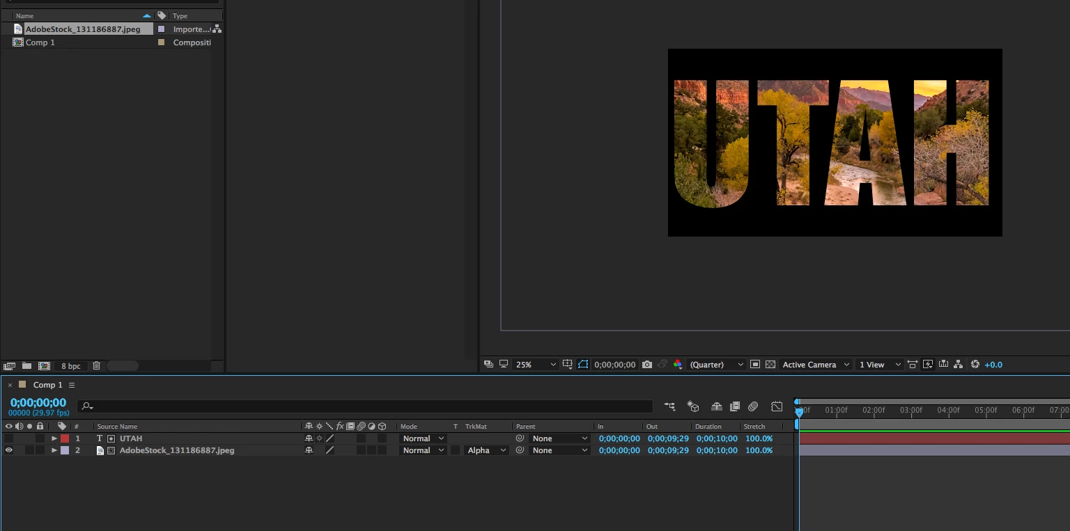

DigitalSpatula
Oct 25, 2017 8:59 PM UTC
Here's an exmple of where the text layer is revealing the image below it using Alpha matte un the Trkmat column pull down menu.

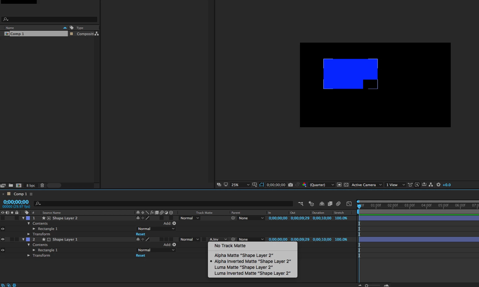

Oct 25, 2017 8:56 PM UTC
Hey
There's a couple of ways to do this. The most common is to use the layer above to mask the layer below by using the TrkMat pull down menu. Alpha matte uses the shape above to reveal the shape below. Alpha inverted matte uses the shape above to cutout part of the shape below.
Hope this helps.
