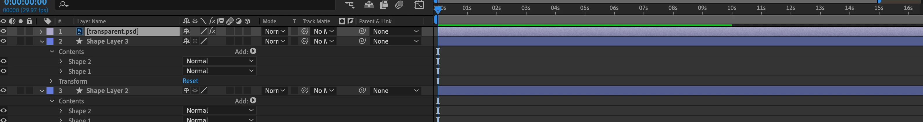

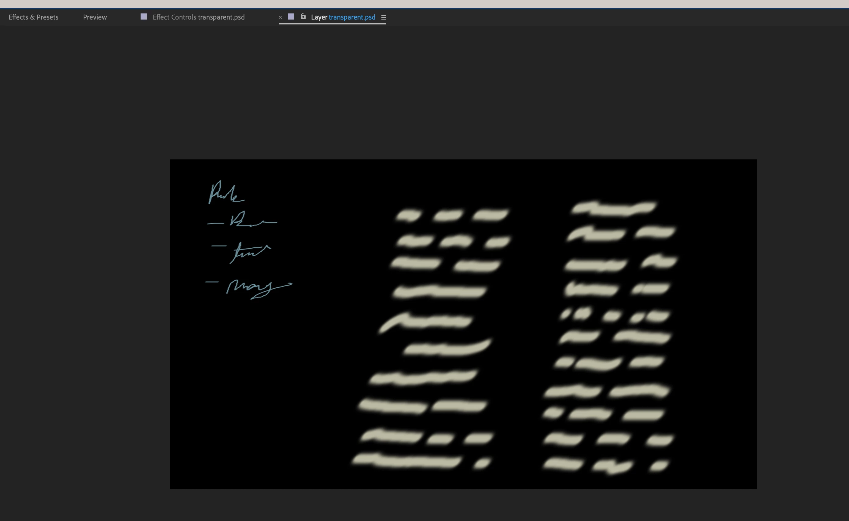

    I think I was trying to do something similar to this comment. This is probably too little too late but under the LAYER >> NEW menu ther is the ability to create a new phot shop layer which will open photoshop with a transparent composition that is already the aspect ratio of your current timeline. Save it and it will create the layer in AE and you can double click it and paint on it in the composition window.

    This answer is so close lol, I want to be able to see what Im drawing over the footage Im using, so I can animate over it.
    When using this method, or the Green solid mentioned above, Im blindly drawing over either a transparent grid or a green solid and have no access to view the layer underneath while I draw in the composition window.
