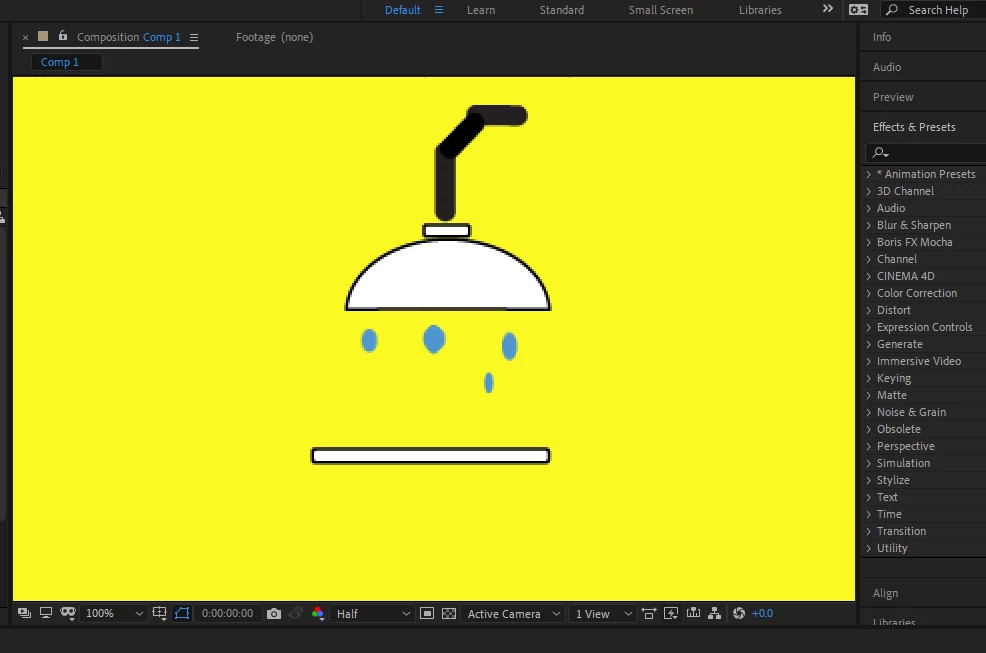

    So here's your screenshot:
    Which by its self is almost completely useless in diagnosing the problem. The clue is that I can see the actual pixel grid. That tells me that the Magnification factor is probably 800%. It might be 400%.  The Comp Panel display is always pixels, never vectors. If the Magnification ratio is 100% or 200% for HR or Retina displays, and you scale a vector image up 2000% and have Continuously rasterize turned on it will always look sharp. With CR turned off it will look aliased. My experienced eye can tell the difference between Aliased and just looking at pixels. Check the corner of the comp Panel. Here's a shape layer, which is always vectors @ 1600% and the view is perfectly normal.

    Hi Rick, Thanks for your reply. Apologies if my image offended you with helping find a solution. Here is another screenshot.
    From what I can see the magnification is at 100%.

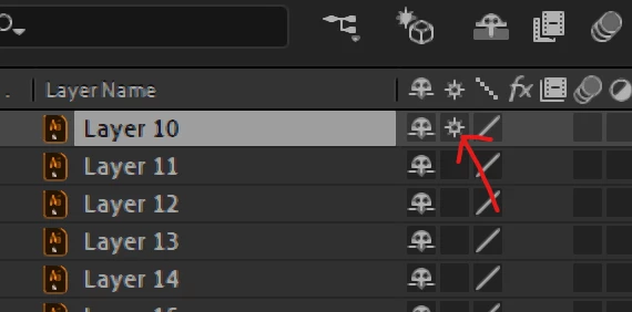

    I have also continuously rasterized as per my "Third Image".

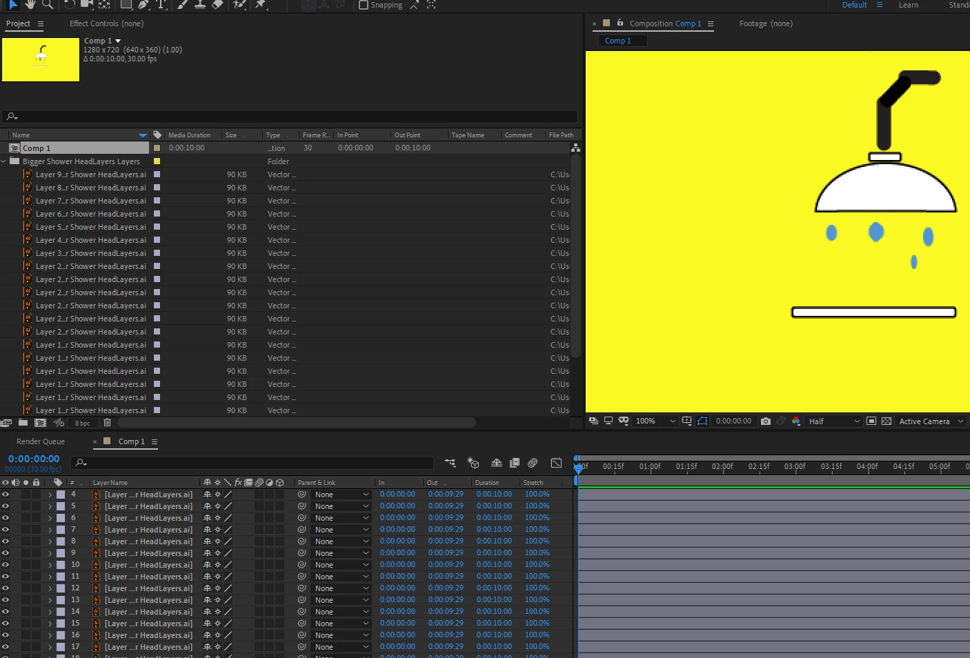

    The comp resolution is set to Half. It should be Auto or Full.

    As Rick has explained above, it looks like your comp is probably too small and zoomed up in preview. Please post a screen grab of your entire UI so we can see your viewer settings and timeline.
