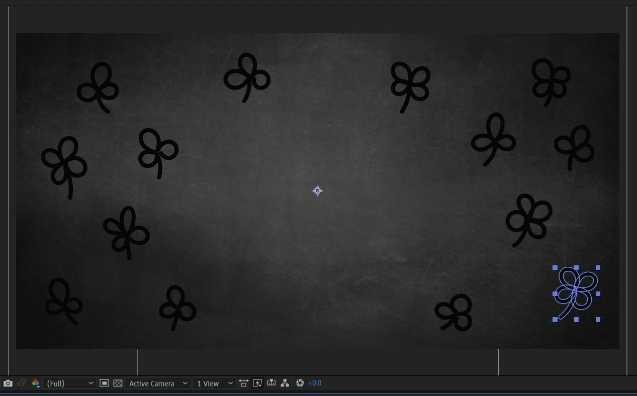

I'm currently working in After Effects, I have imported an illustrator file (all divided clearly into layers). Each layer in the Ai file has a vector path of a clover with a stroke of 5 - it is not a closed shape/path. I have brought the layers into my composition in After Effects successfully and now I would like to convert the shapes from my vector layers so that I can animate the path. BUT:
My trouble is that when I "right click > create > create shapes from vector layer" (with my vector layer selected in after effects), my vector path is automatically outlined so instead of a path, I get an outlined stroke (filled shape). See image below. It's holding me up from finishing this project and starting others.
How can I have the path remain a path so that I can edit it as a path in after effects?

In Illustrator, make sure your stroke is centered. Could be a probleme in AE if your stroke is outside or inside the shape.

Please show your entire interface as well as the layer in question with any modified properties displayed. To reveal all modified properties: select the layer and hit u twice (uu)

If the path created in Illustrator has anything other than a simple stroke applied to it the path will turn into a shape. Check your AI file. Make sure no brush or effect has been applied to the path. Your paths look like they have an almost round brush applied to them in Illustrator.
