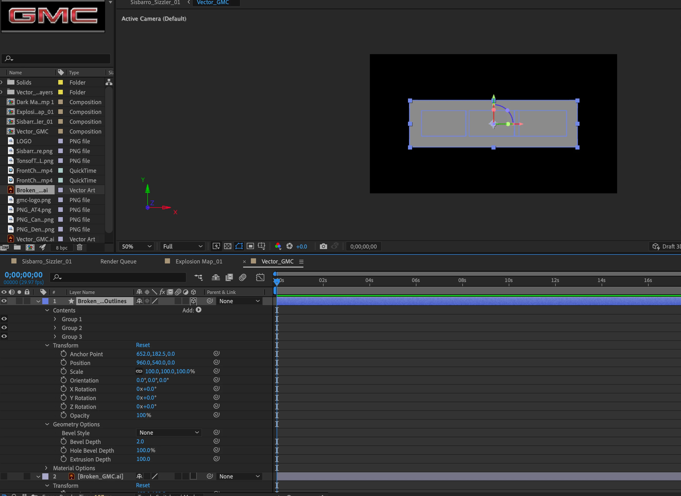

I am trying to create shapes from a vector layer. When I hit the "create shapes from vector layer"option, all I get is a bounding box, with bounding boxes of each shape, all filled. I cannot see the logo at all, and I cannot spin or manipulate the logo in any way that I can see. I have followed instruction to a T, but no changes have occurred. I have looked closely in instruction videos, and I do not think I have skipped any instruction steps. It is not a blending option, and my compostition is set to 4D. I've selected the 3D object box.
I cannot figure out why I have this outcome. I have endured a gap in my After Effects work, but I usually have a lot of success through the normal troubleshooting avenues.

Your AI artwork clearly contains gradients and an inset bevel/ stroke. AE has no way of re-creating those as shape layers, hence the grey box. Clean up your artwork. I suggest you read the online help on what's actually supported by shape layers instead of blindly following tutorials that may leave out such critical info.

Hi craigs80700828,
Thanks for writing in.
Does your logo have a background with gradient filled in it? After Effects turns a gradient into gray color if you covert a vector to shape.
