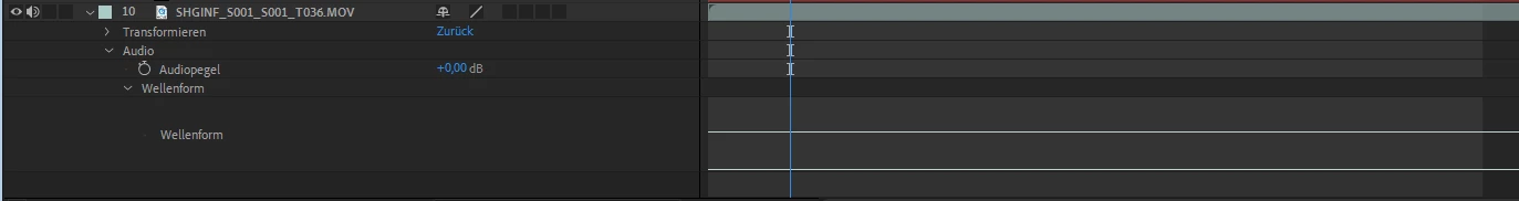

- We have no audio if played on the timeline (audio preview is activated)
If we use an mp3 file on the timeline, it can be heard. Project and composition seem to be OK.
If we use the ProRes recording of our Atomos Shogun, a waveform will be shown in the list, no waveform will however indicated of we use it on the timeline.

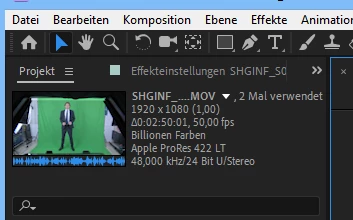

If you select the clip in the Project tab and look at the Poster Preview at the top, do you see audio information as well as picture information?

#1 yes, if you add the video file to the project, audio will be recognized, there is however no waveform on the timeline. An MP3 generates waveform also on the timeline.

Your source video has multi-channel audio and it's recorded in tracks 3, 4, 5 and 6.
Switch to recording to channel 1 and 2 in the future and you should be good to work with the files directly in AE and hear the audio.
For your current MOV files, you can export the audio as a stereo mixdown pretty quickly by importing the MOV into Premiere Pro, creating a new Sequence from the clip (Premiere should default to a Stereo Mixdown for the Sequence Audio Settings) and then do an Audio Only export.  Add the resulting audio file to your corresponding Comp in After Effects and you should be good.
