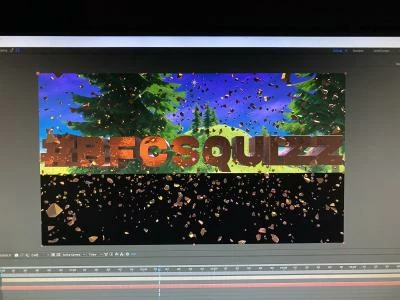

(Sorry for my bad english)
I have a problem with Element 3D in After Effect, in the last 3 month I did a lot of 3D text and logos with shadows and I had no problems, but now when I create a shadow a black plane appear, and I don't why cause I didn't change anything in my application, I tried to uninstall and install the app and the plugin and it didn't worked...
When I oppen my old projet with shadows, the same thing replace the shadow...
So all of my old work is corrupted.
If somebody have the solution please help me, or there is no solution can someone explain me how to restore all my settings and presets of video copilot to see if it change something, because I thing I activated something who goes in all of my project and now I can't add shadows....

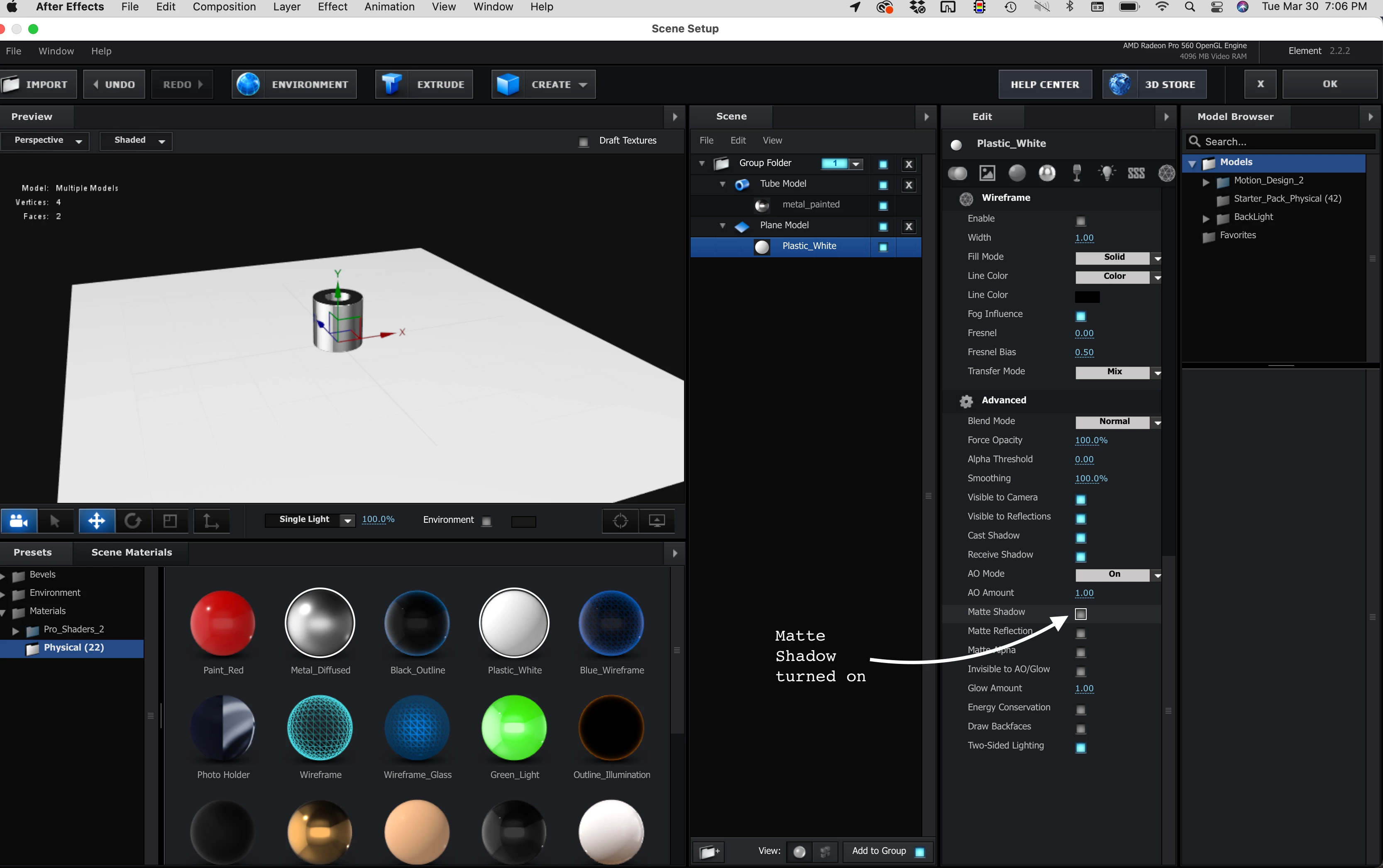

These are the basic settings required for getting a shadow to appear when using Element 3D. First, inside the Element UI you have to add a plane below the object you have added to cast the shadow and Matte Shadow must be turned on in the Advanced Materials section of the Shader panel. You go from this:
To this:

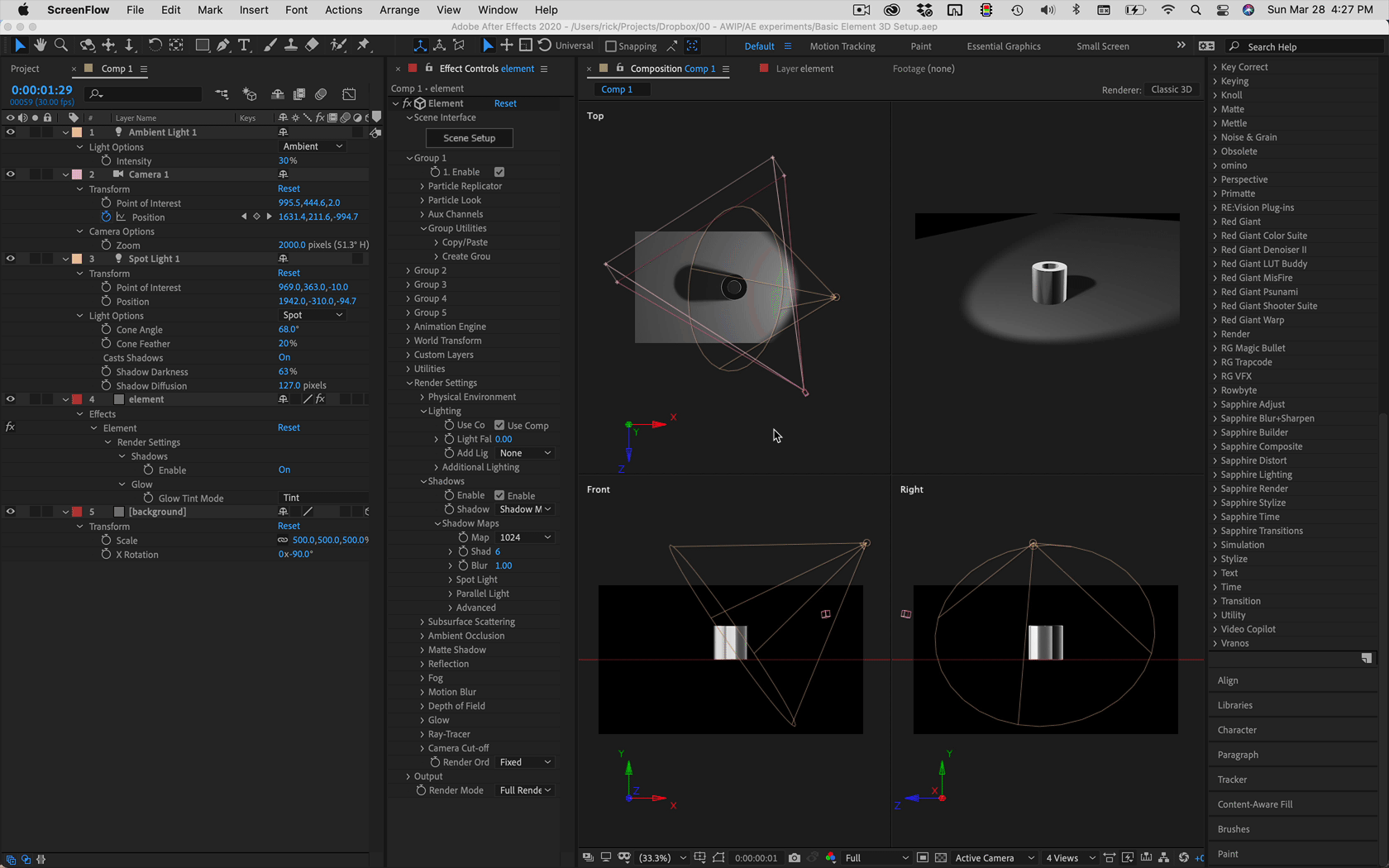

Then in the Effects Control Panel, you have to set Element/Render/Shadow to Enable.
The last screenshot shows you everything that was modified for each layer. Here's a project file for you to try.
If that does not work check your GPU settings in the Project Panel and your GPU drivers.
