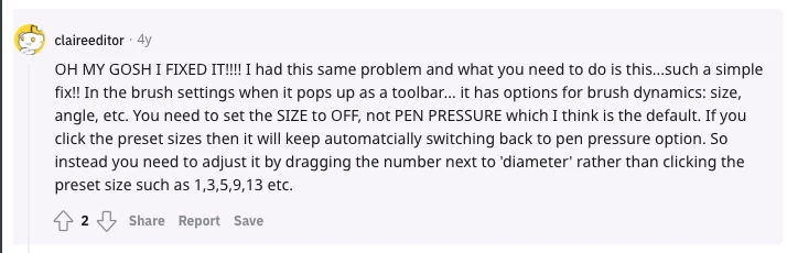

Hello! The same thing happened to me, at first I thought it was my wacom but when reading this forum I realize that I was not the only one. Surfing the internet I found a person who had a similar problem, the solution they gave him also worked for this problem that we are presenting.
This is the link Solution on Reddit
I have not presented the problem for more than 2 hours. I have not updated driver, firmware, nothing, I just followed the steps of "claireeditor"

Hi @voodoopop
I attach a screenshot of the post
