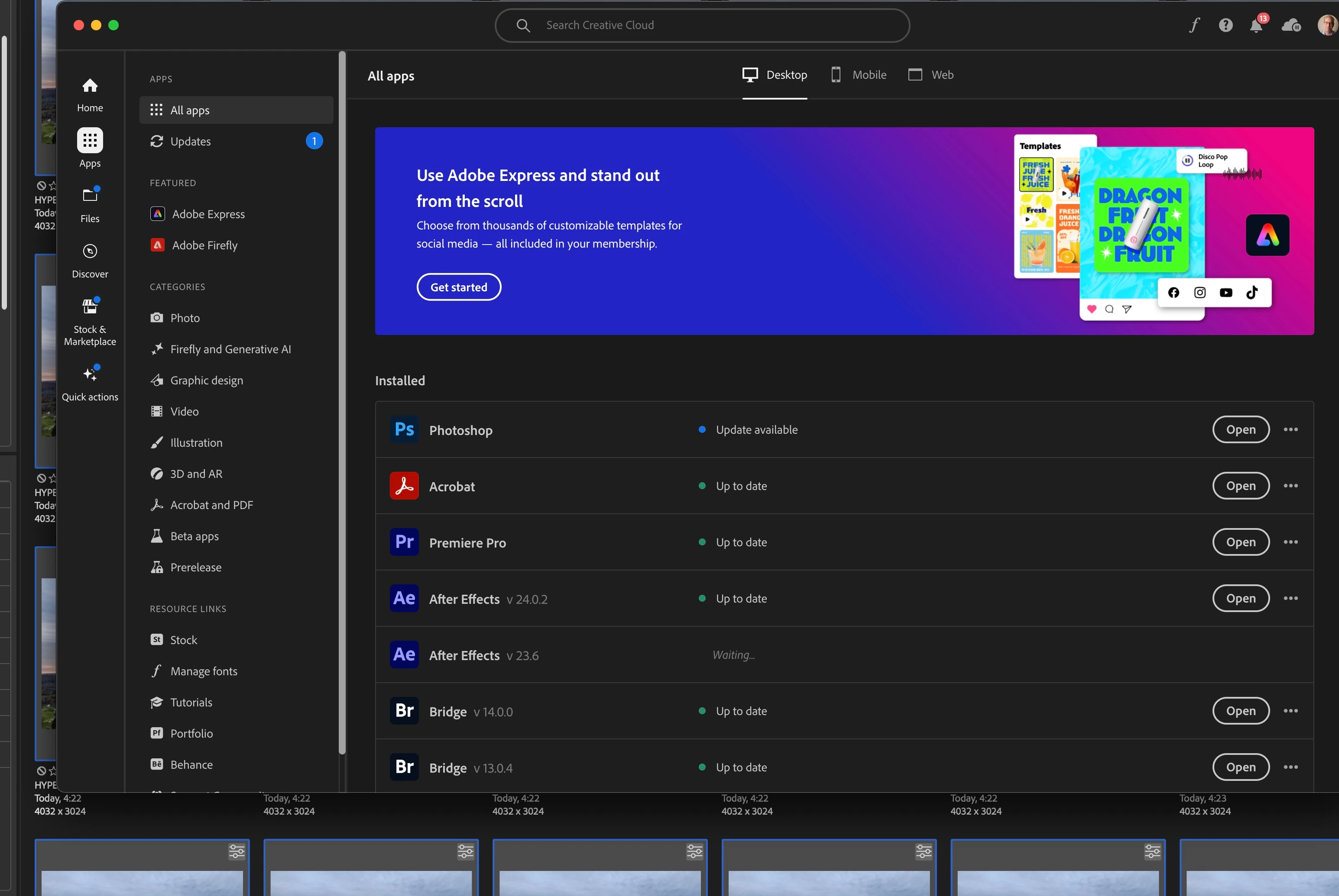

I continue to have issues sucessfully completing Warp Stabilizer analysis with my projects. Sind AE does not crash or freeze, I have enable logging to see if that helps with troubleshooting this ongoing and very frustrating issue. I a have had issues with this with both Intel and Silicon Macs. Screen recording shows that I using latest versions of OS X and AE with a Mac Mini M2 Pro.

Sure enough, I had two versions of AE installed and I was loading the older version from my application dock on my Mac as that doesn't get updated.
warp stabilizer has worked without freezing on two different jpg sequences now. Thanks!

is the 24.0.2 only available as a beta? I should be getting automatic updates unless I've accidentally had two AE versions installed and the one I have in my dock is not the newest version (that has happened before).
