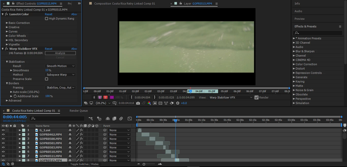

To start off, I am extremely new to after effects so I'm not entirely sure how easy/difficult this is. However, I applied the warp stabilizer to a video clip in a sequence and set the amount of stabilization to 30%. I did this with the rest of the clips with no problem but for some reason after effects crops one of the clips and makes it very skinny and adds really big borders. What can I do to stop it from cropping the video so far?

    Hey, I had the same problem and finaly found the solution!
    Go to Effect Controls, warp stabilizer settings, select Borders, Framing and select Stabilize Only on the right window.
    There are other options as Stabilize, Crop - Stablilize, Crop, Auto-Scale and Stabilize, Synthesize Edges.
    September 14, 2021
    You can also edit the scale with the Aditional Scale option beneath.

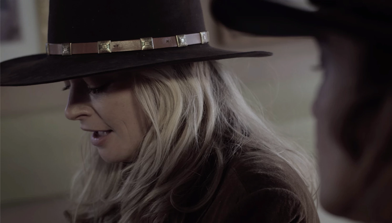

    It is also important to understand that Warp Stabilizer will not work on all shots. For example, a handheld closeup shot with shallow depth and details in the background and foreground like this one from a film I recently produced will not respond well to Warp Stabilizer.
    Can you guess why?
    As the camera moves in and out and left to right there is a huge shift in parallax between the back wall of the saloon, the in the middle and the actor closest to the camera. Warp Stabilizer does not know what is most important in the shot and it will try and reduce the movement of the part of the scene with the most detail by warping the other parts of the scene into different positions. This makes the foreground, the background and even the top of her hat and her shoulder look like they are made of jello.
    The camera movement almost completely destroyed a great performance so the shot had to be fixed. In all honesty, I admit that I tried Warp Stabilizer first and ended up with a complete mess. The solution was to motion stabilize the shot using the corner of the picture frame on the wall so that it stopped moving. Except for the edges of the frame that kept appearing it now looked like the camera was locked off. This gave us a place to start. The shot was scaled up enough to hide the edges of the frame and just 3 keyframes were needed to smoothly hide the left and right edge of the frame as they crept into the shot. A jerky nearly unwatchable handheld closeup was transformed into what looked like a skillfully executed camera move that slowly moved from profile to 3/4 and made shot work well. Warp Stabilizer, the tool that most inexperienced VFX artists would choose, was actually the worst tool to choose to try and repair this shot.

    I think it may be because you clip is to shaky and to counter it the software crops it in. Can you take a screenshot?
    sierrabailey
    June 12, 2017
    I tried lowering the percent of stabilization and the crop didn't change. Thank you for any help!
    June 12, 2017
    Hey,
    So under framing try changing that to stabilize only. See if that fixes your issue.
