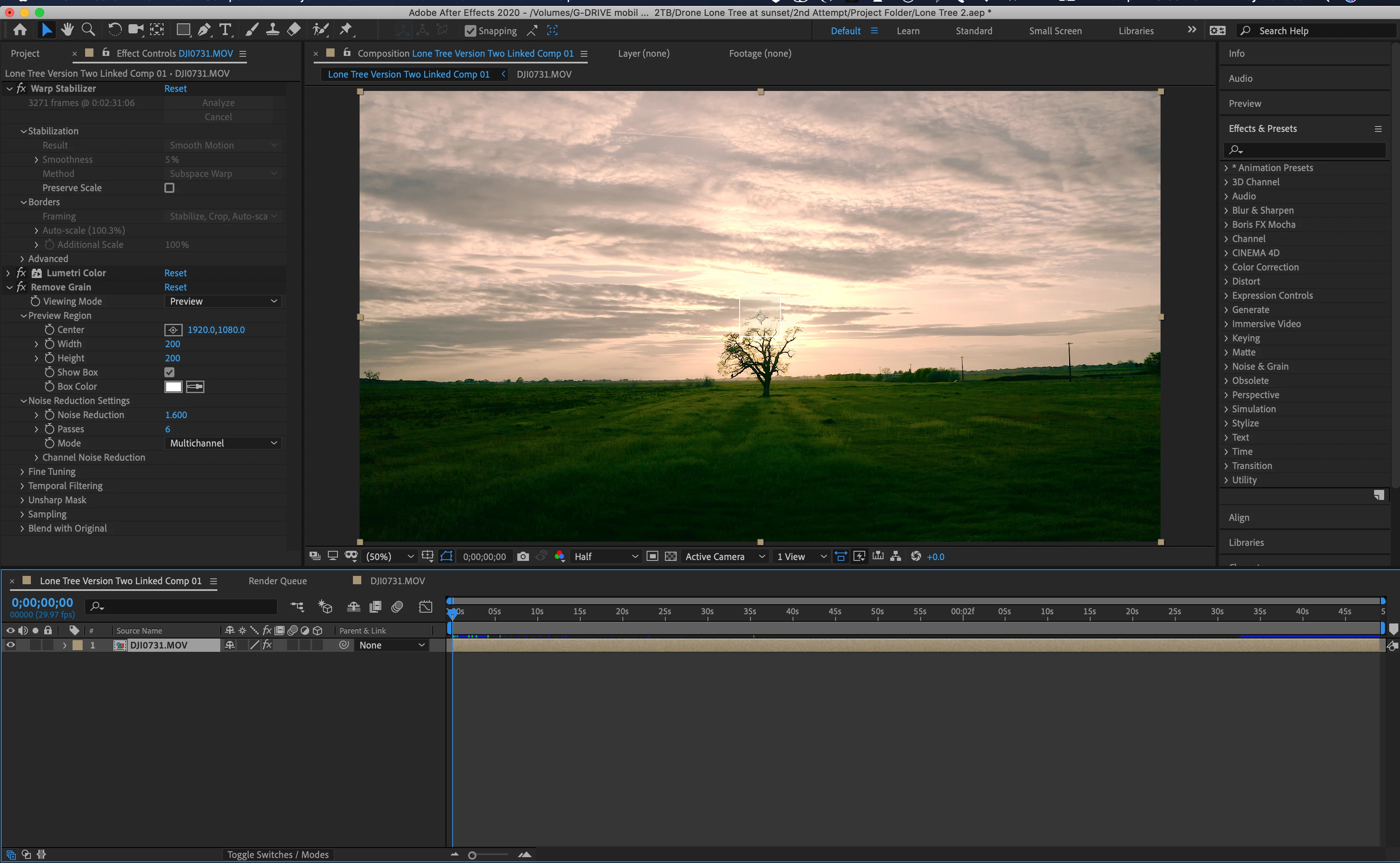

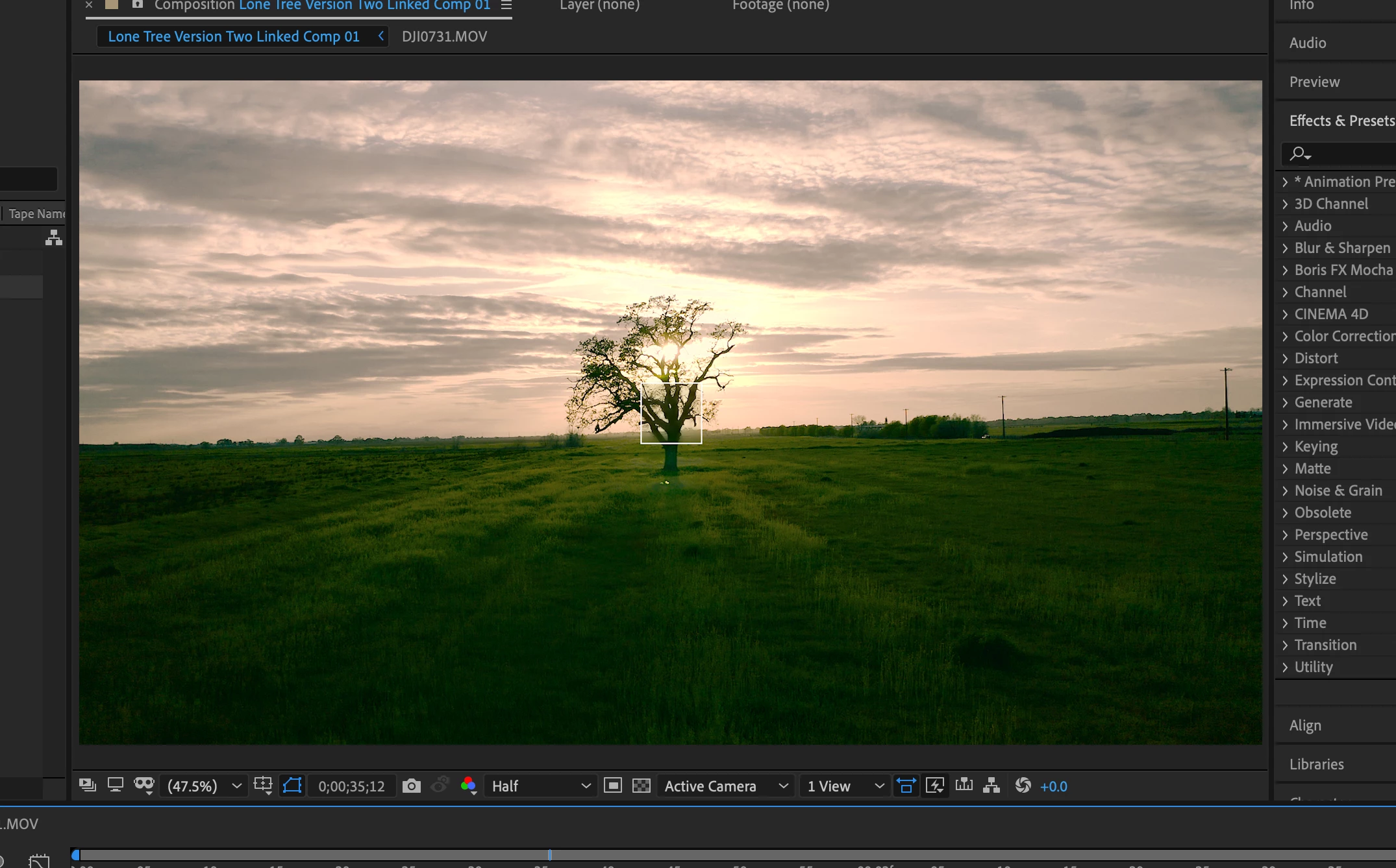

what is this white square in center of my frame
Can anyone tell me what this square is on my footage that burns in when i export and render out? Im not sure if this is something that was put on in adobe premier or affter effects as I am using adobe dymic link so its on my footage in both platforms.
Rick GerardCorrect answer

You have shown the Effects Control Panel, but if you select the layer and press the U key twice you'll see everything that you changed. All the Lumetry changes will show up as well as changes to  Remove Grain. If Remove Grain does not show up in the timeline you didn't make any changes so pressing "e" will show you all effects added to your layer.

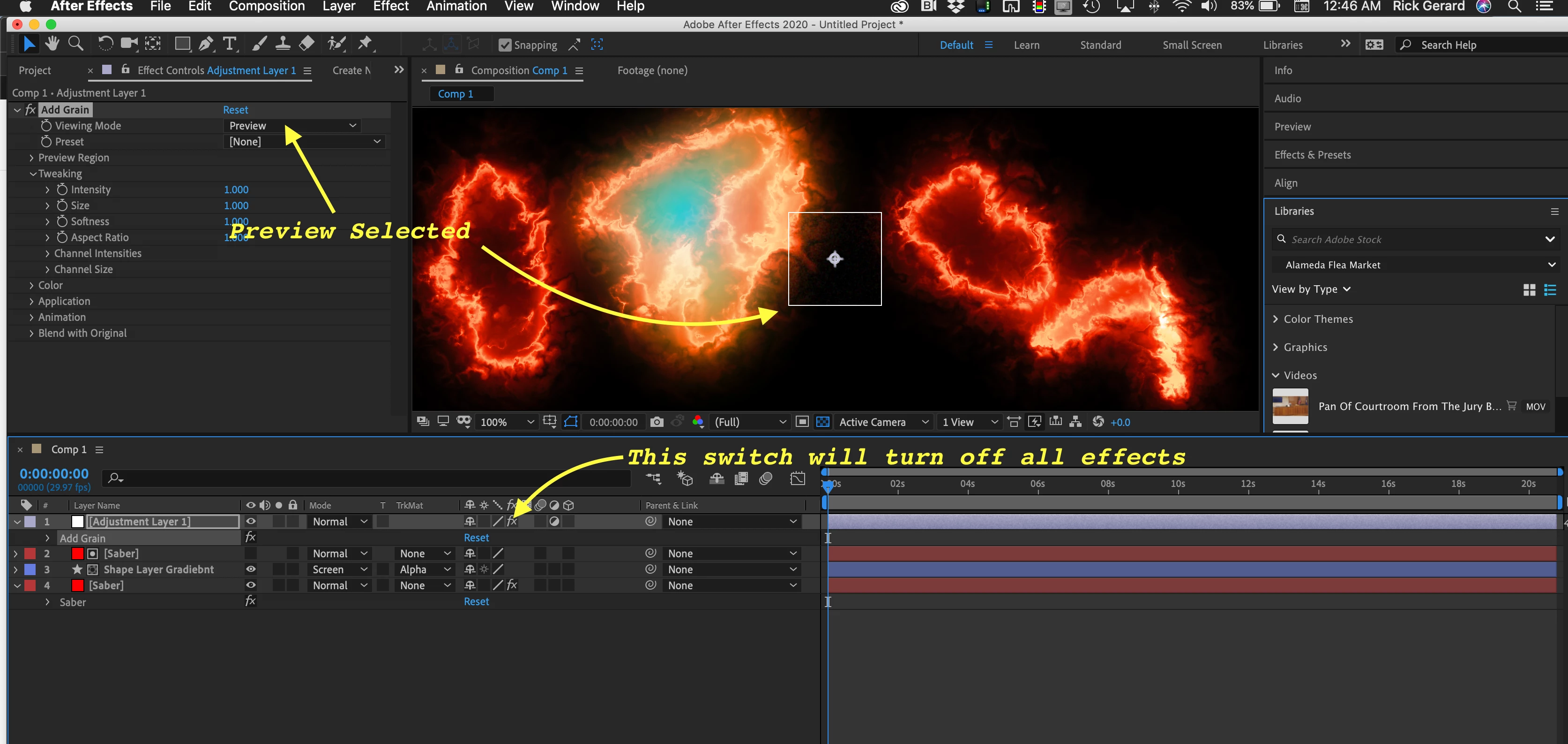

That screenshot tells us absolutely nothing about your composition. We need to see the layers. The small rectangle looks like it might be the Preview Ares that is the default when adding grain to a shot, but we cannot be sure until we see the modified properties of the layers or the effects applied. You can find it yourself by deselecting all layers, pressing the 3 key to reveal all effects applied to all layers, then start soloing layers or turning things off or soloing layers until you isolate the problem. If that fails to find anything press the "u" key twice to show all modified properties in the comp.
I added an adjustment layer to this comp I am working on and added Add Grain with no modified properties. There's the white square.
If you can't find the problem post screenshots showing us all modified properties of the layers giving you problems and describe your workflow and what you expect to see in detail.

Thank you Rick this is exactly what happend.  I did try to removes sone grain.  You will have to excuse me, I am very new to Affter Effects.  Just a camera guy with a lot of time on his hands these days attempting to edit material that I would normally hand off to a more qualified editor.  I have attached a screen shot of my layers and its properites I think.  Im happy with the way it looks I just want to get rid of that square.  Not sure how to?
Rick GerardCommunity ExpertCorrect answer
Apr 3, 2020 5:18 AM UTC

My guess would be that you used Remove Grain or a similar effect and forgot to change the settings from preview area to actual full frame. if that's not it, you have to provide more info on what you are actually doing in your project. Just throwing a cropped screenshot of the UI at people is never particularly helpful without explaining what's going on.

Thanks Mylenium and I apologize in advance for any silly questions as Im very new to using AE.  I thnk your onto something however, both you and Rick said the same thing.  I did apply the remove grain effect to this one clip and just need to figure out how to get rid of that box so that it doesnt show up when I export the final comp.   I tried scrolling through the differnet options of how to preview the the remove grain efffect but that didnt help me any.  Is there a way to just turn it off?
