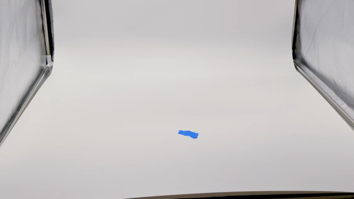

What's the most realistic way to replace the background of a recorded falling object so it appears to be landing in different scenarios?
We recorded an object falling at 60fps that lands on the blue tape. It bounces slightly when it lands. I've rotoscoped the falling object out, but it occurred to me that it's not as easy as just swapping the background out with an image. The angle of the ground, shadows, etc. all factor into making something realistic. What's the best way to approach this?

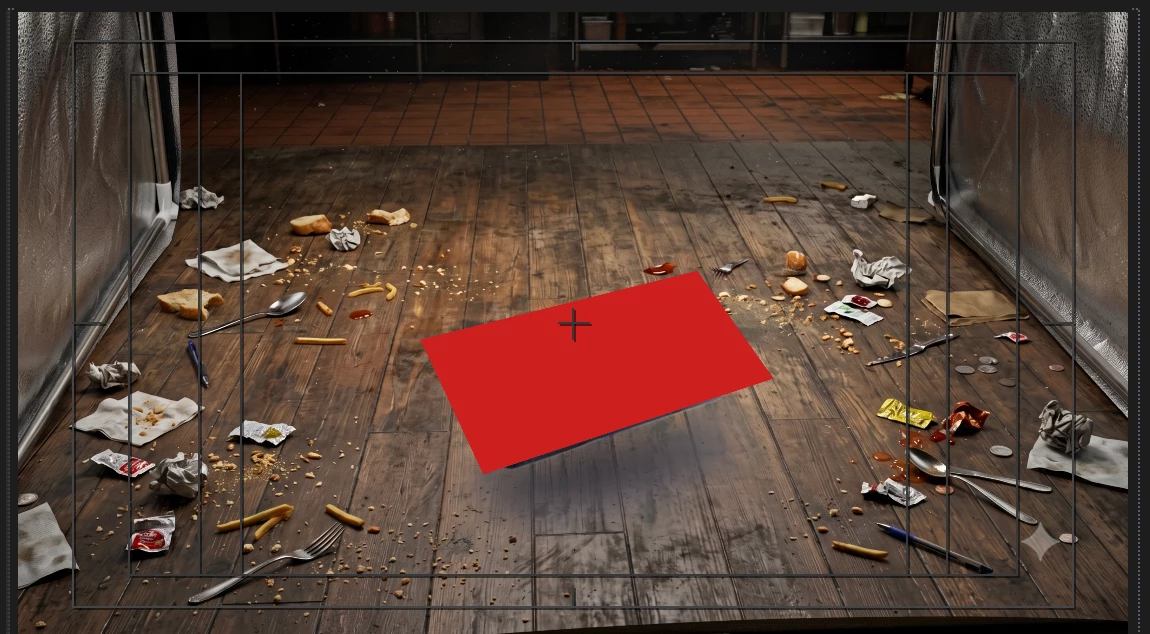

    Appreciate your help so far. Just to chime in to answer some of the questions. The camera was on a stable tripod. I created a garbage mask around the shadow, blurred the hell out of it, and scrunched the white out with levels. I created an AI slop background for now just to see the results. It’s definitely better than it was before but still very fake. This does not need to be major motion picture level quality, but ideally better than something that looks like it was thrown together in 5 minutes. The rotoscope of the falling image isn’t perfect. There’s a lot of motion blur, which when combined with a fake background, makes it rough. The dropped object is also black which makes it hard for both the rotobrush and myself to distinguish between the shadow at the bottom and the actual object.  What settings would you recommend for the rotobrush? Would it be best to slow the footage down?
    Nonetheless, I think the most difficult aspect of it all is the angle. My original idea was to turn a picture 3D to match the angle of the ground. The issue with that is that the 2D perspective in 3D looks extremely flat. Do you think it would be easier to create a 3D model of the dropped object and animate it falling in a 3D scene?

    It’s hard to tell from the picture, but I wonder if the scale is playing a part in the effect not working.  You could try a 3D model, using the video as a reference to help match speed.  That would give to the option for a shadow catcher layer.  But I think that would be a lot of by-hand work and you might still feel the shadows don’t match.
    What's the red thing, if the object itself is black?
    I’d be interested to see a still with the object in it too.  Something like the Color Link effect might help match it to the scene.
