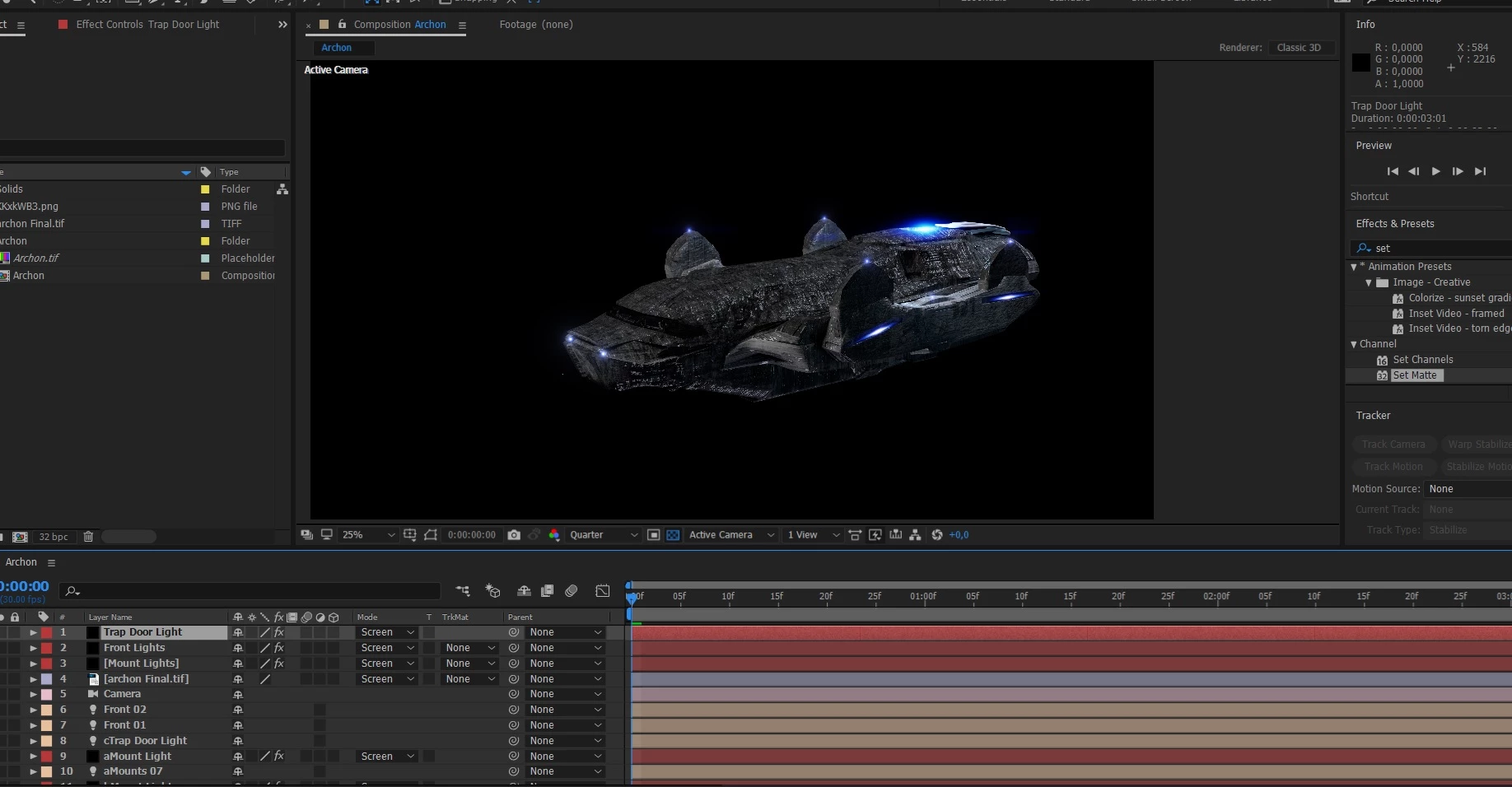

When I pre-comp, the background turns black!
Hello guys, I am slowly trying to learn after effects and there is a big question that always bugs me and I can't figure it out.
Say I have this comp, which is too cluttered, as you can see.
So I want to pre-comp it in order to clear the space, and of course in order to animate the whole spaceship at once.
The problem is that, when I pre-comp and then try to add a background image, the image doesn't appear and the new composition background stays black, no matter what I do.
Blending modes don't help.
And I don't know what to do. I have tried the shift channels effects and the linear color key effect, but i can't get them to work. Also, transparent grid is checked as the images show.

    May 19, 2018 3:43 PM UTC
    In your original comp the spaceship layers are all in screen mode. When you precompose them, they remain in screen mode but ONLY in the context of the pre-comp (where there's no longer anything underneath them, hence black). The PC's layer in your main comp reverts to normal mode, so that black background is displayed. By default AE doesn't care what's inside a PC, it just treats it as a chunk of video footage.
    Click the second-left toggle switch on your PC's layer, that looks like a sunshine icon. It's called Collapse Transformations, and it tells AE to look at the properties of each layer in the pre-comp before deciding how to render it into the parent.

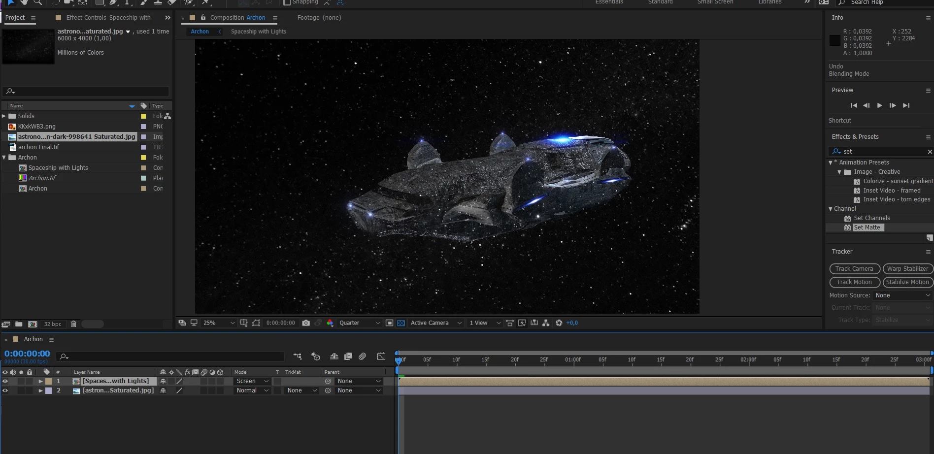

    Antony1991
    May 19, 2018 4:09 PM UTC
    Thanks for replying Dave!
    I was aware of the Collapse Transformations button, and indeed when I press it, the layer gets fixed and the background image is shown.
    However the problem doesn't get fixed: if I apply ANY effect on the pre-comped spaceship, the black background returns. Collapse transformations seems to work only if you don't apply any effects on the comp.
    This kind of defeats the purpose, because why pre-comp something if I can't add any effects to it...
    Maybe I am doing something wrong before I pre-comp?
