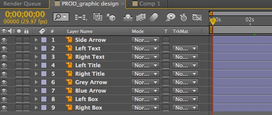

I want to use this switch on my vector graphic layers but can't find it anywhere, and nothing comes up when I search it in help. Can anyone please tell me where I might find it?

    You need to show the Switches column.
    You said that you tried to search. What did you search for, exactly? When I did this search, I found the information that I linked you to above.

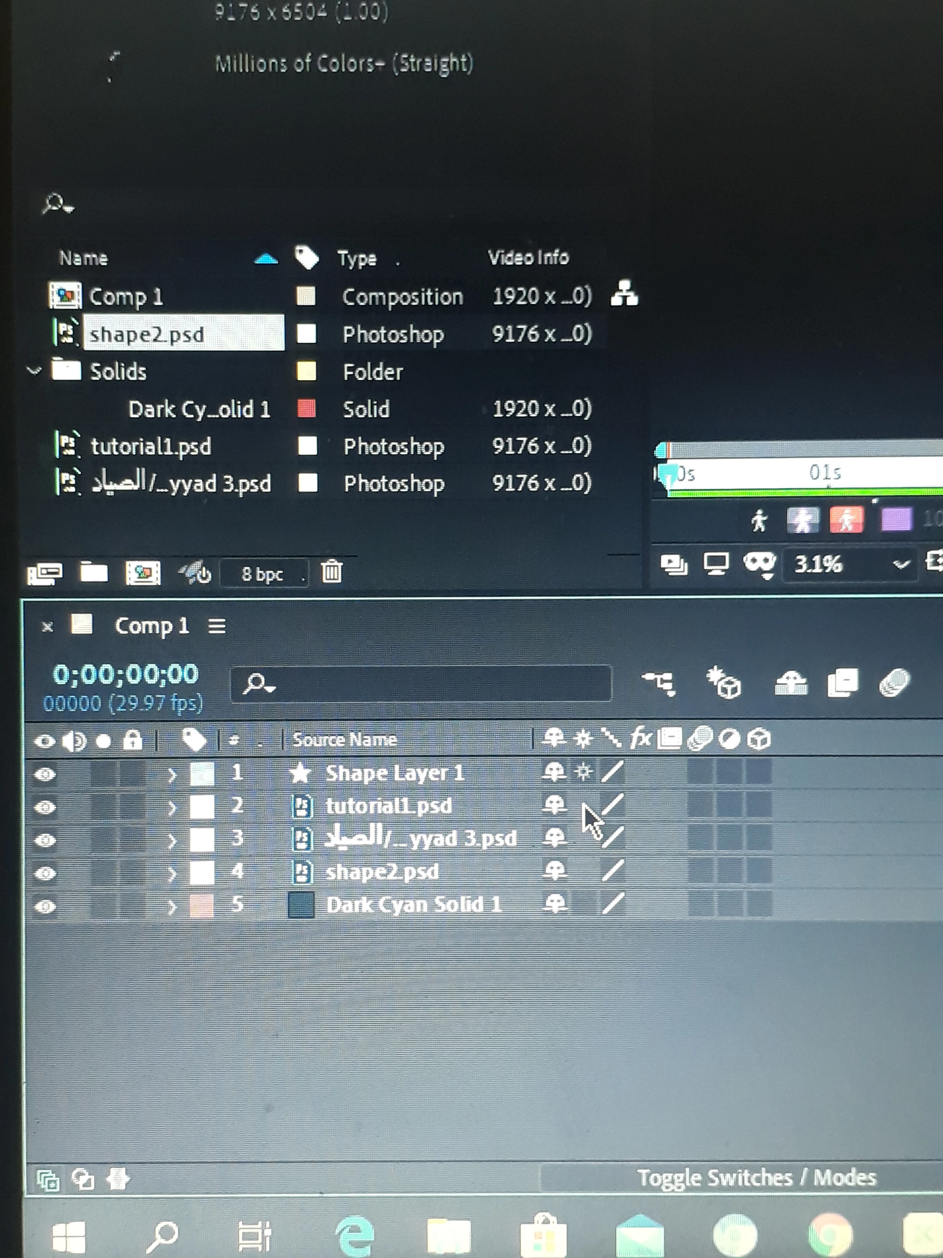

    1.  I try to resterized this project but AF tells me that ig can't open continuously resterized layers...
    2. Anyone can help me please ?!

    Perfect, thank you! I had just searched 'Continuously Rasterize' in the help menu of AE to see if there was a place I could find it in the menus. Thanks again.
