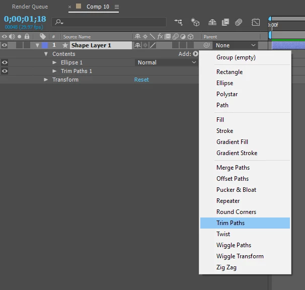

Where is "Trim Path" in After Effects?
I was trying to follow a tutorial elsewhere for animating the drawing of a circle using a trim path on a hand-drawn vector circle I drew. The tutorial only says, "add a Trim Path from the Add menu." I typed in "trim path" into the help search bar in AE, and I cannot find any "Trim Path" option anywhere. Can someone help me find this? I'm using After Effects version 14.2.1.34 on a Macbook Pro running OS X El Capitan.

Here's a visual cue:

- Select a shape layer.
Go to the ADD MENU on the layer contents;
- Select TRIM PATHS;

To find instructions on how to use trim paths or any path animator simply type Trim Paths in the search help field and read the instructions. You will remember it better that way.
Just as with Text animators, shape animators are found in under the Add button in the Modes or Switches column.

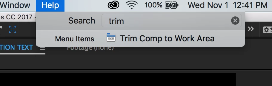

Unfortunately, I tried this, as I described in my original post.
For example, even when just typing in the basic term, "Trim," yields no options, as does "Trim Path:
Results for searching only, "Trim" :
Results for searching, "Trim Path" :

Ust the search help field at the top right corner of AE not the Help menu.
Create a shape layer, press the U key twice to reveal the modified properties of the layer, just to the right of the Contents row in the Switches or Modes column you will find the Add button.
