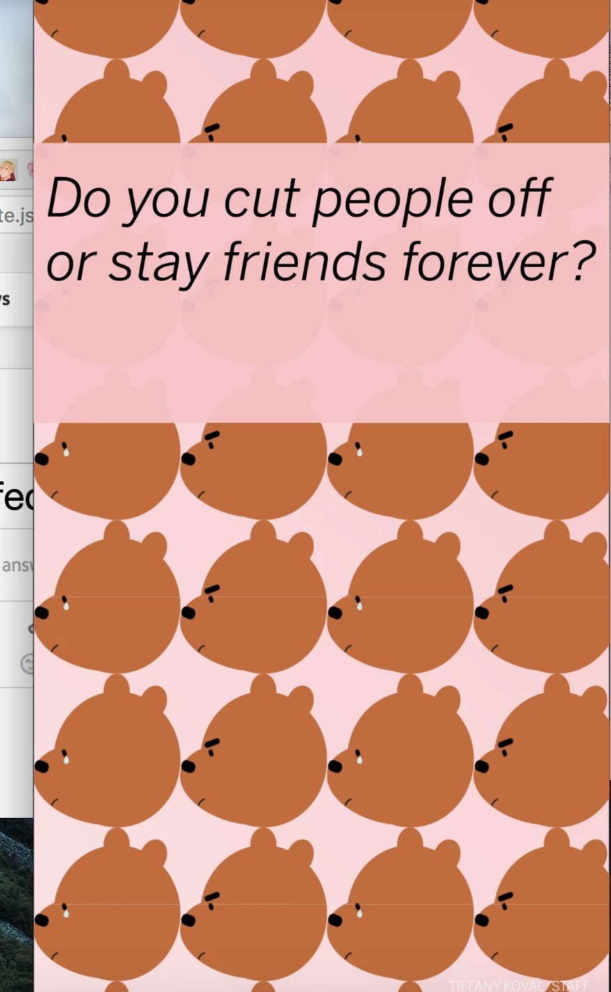

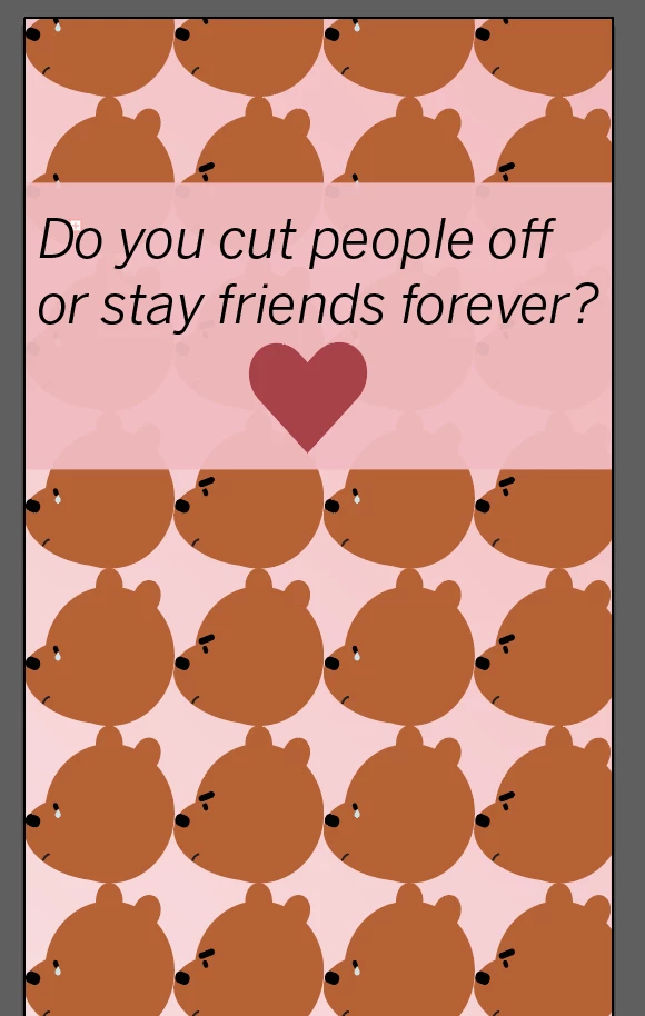

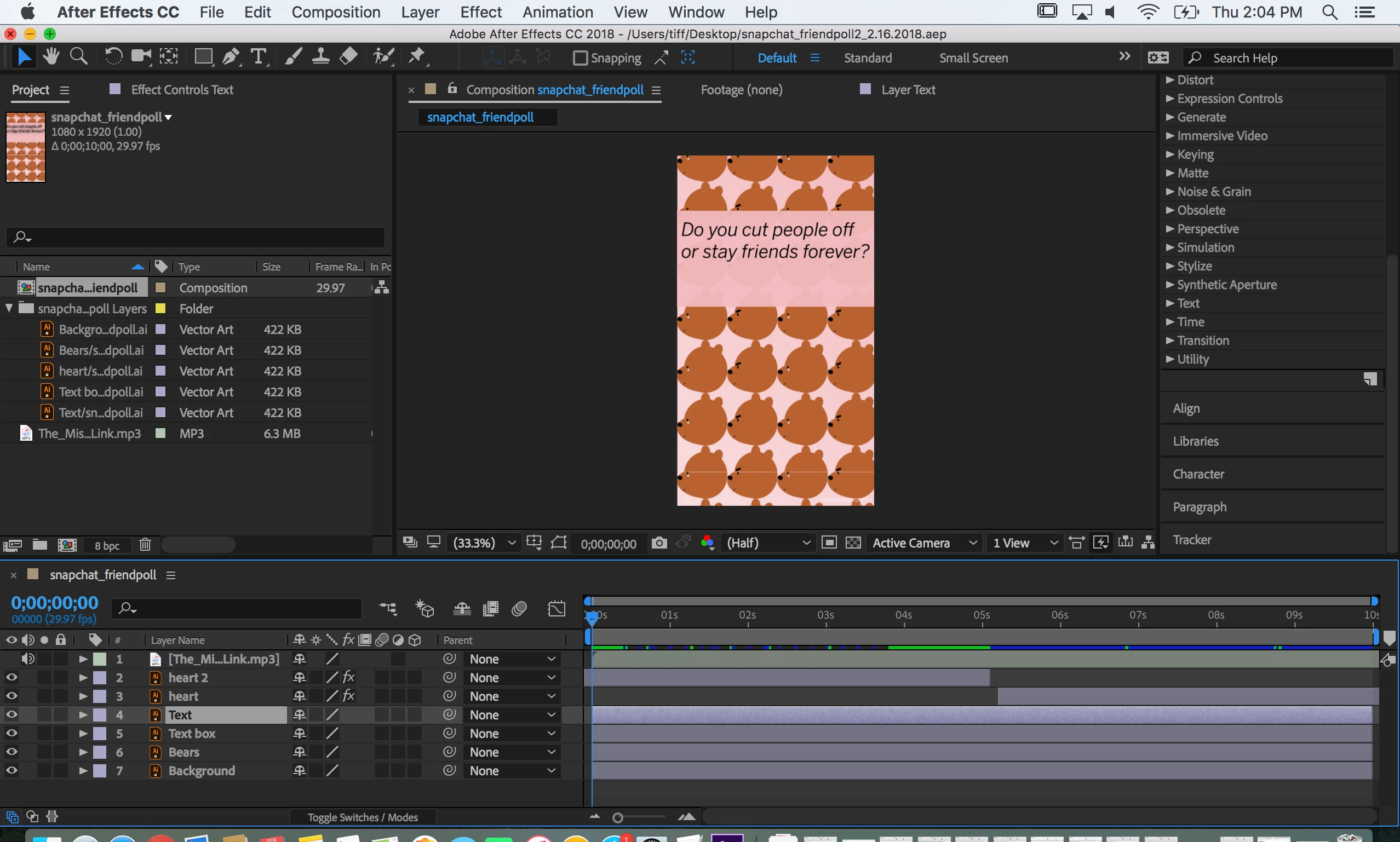

I noticed two white horizontal lines in the composition that weren't there in the AI illustration file. It also persists when I export the composition into a mp4 file. I've tried rerendering it, playing around w/ the composition, and checking for updates but nothing seems to be working. What are your guys thoughts?
Illustration file:
AE file:

Feb 16, 2018 1:22 AM UTC
Hi Taropuffgirl
Probably some funkiness from the AI file that you cant see except in AE.
I would first turn off and on each layer to see which layer has the white line, Then you can just mask the layer so the white lines disappear.
Hope this helps
Steve
