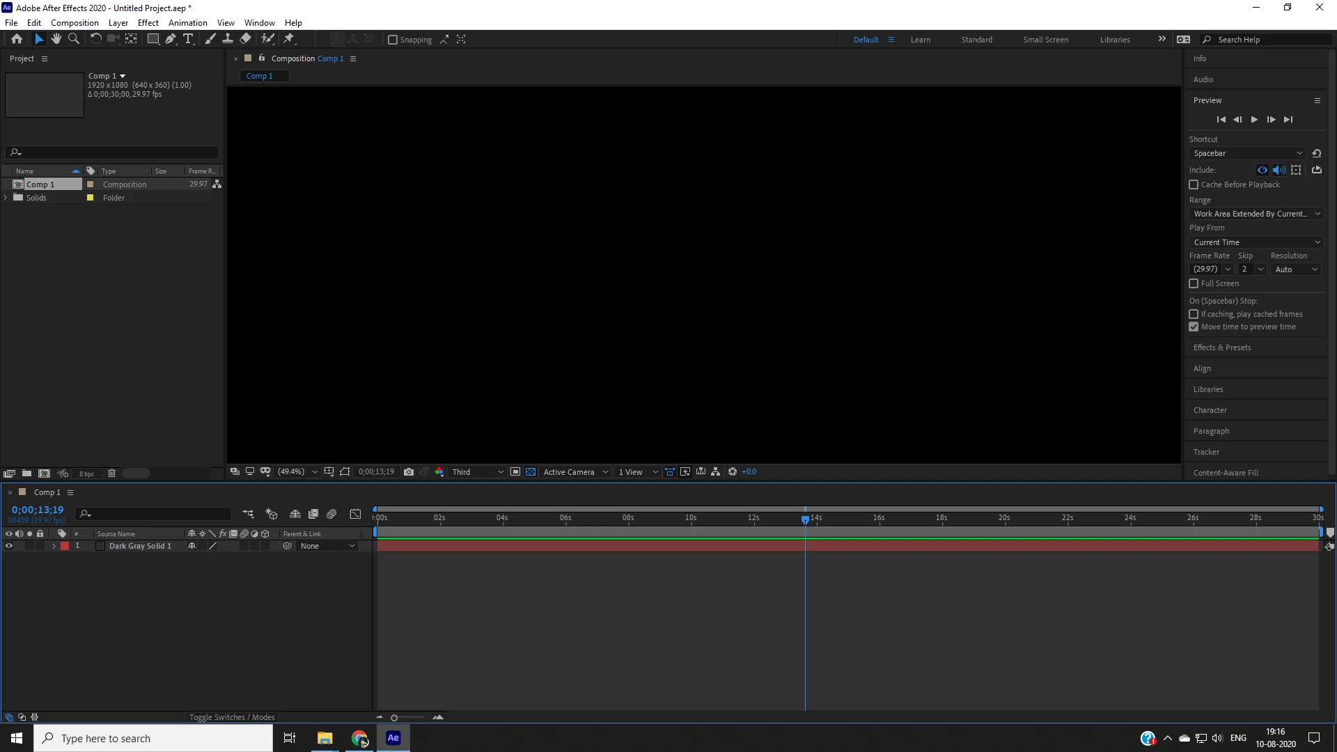

Aug 10, 2020 1:48 PM UTC
after effects compositing preview is black

howdy -- 10 yrs later-- if you've see. little dot in one of your layer in the left part of your timeline (near all the eyeballs) unclick it. i read all these comments and nothing worked until i tried this in desparation and all my stuff came back (thank god!). i had accidentally clicked a shortcut key (i have no idea which key) and it turned this 'black screen on'. it was a brief nightmare.. but this was my eventual fix. hope this helps someone else! (maybe) if all the other stuff above fails.

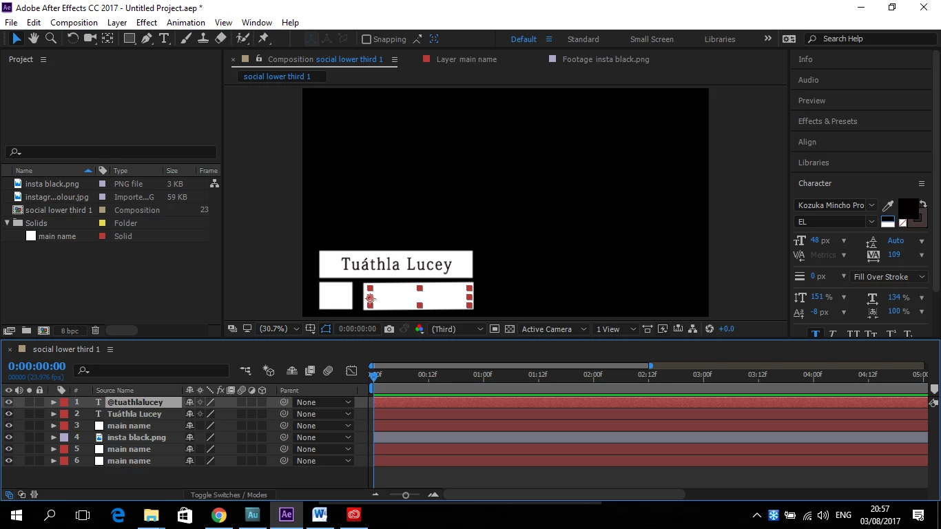

Aug 3, 2017 8:00 PM UTC
Hey, I am also having trouble viewing pics and text I have in my composition. This is my first time using After Effects and I am following a tutorial on Youtube.
Can anyone help me to make the text and picture I imported visible?
Cheers,
Tuathla.
Szalam
Aug 4, 2017 3:56 PM UTC
Choose the reset option on your character palette.

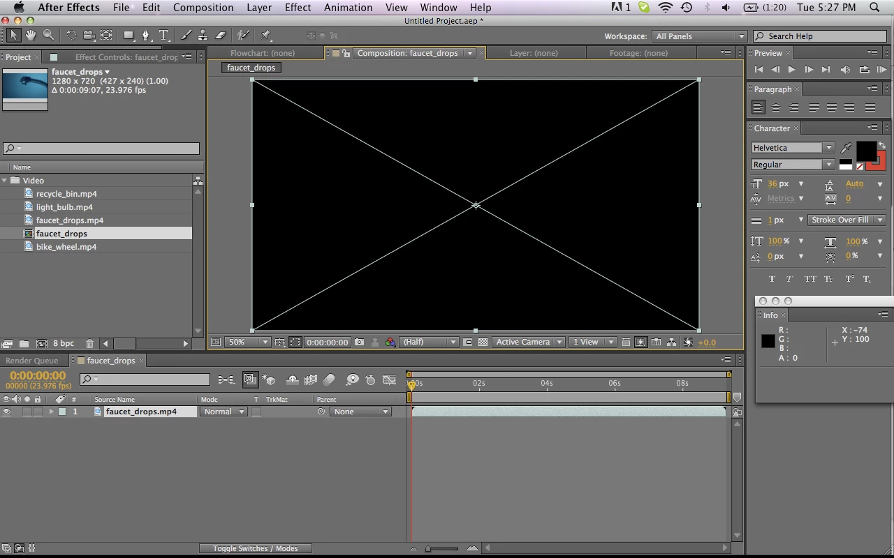

888RazAuthor
Jun 28, 2011 3:41 PM UTC
First. Thanks a lot for answering .
Ok. I have checked my CapsLock and it makes no difference all.
I have also done a screendump as you requested. Hopes it helps.
I have also checked the site that you sent with your reply. It is really good and I totally agree that as a beginner you should NOT do over-complicated stuff.
So what I had done before writing on this forum was to try and follow the absolute first tutorial that Adobe provides. Exactly for the reason that I could learn it slowly and properly, as you point out. BUT what does one do when almost from the beginning you see that the guy doing the tutorial can see his picture of the faucet on his Composition Window and I cannot? It stopped me learning anymore. Frustration set in ...
I really hope I can get this resolved so that I can continue learning. I have also tried to re-install AE with no effect. Hmmmmm
Is there not a way to TOTALLY reset AE? Or is this not necessary? Looking much forward to your replies.
Todd_Kopriva
Jun 28, 2011 8:53 PM UTC
You switched your Composition panel to Wireframe view mode. Don't do that. See this page for information about view modes.
