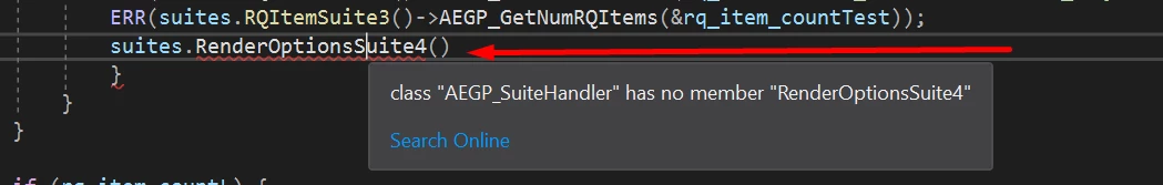

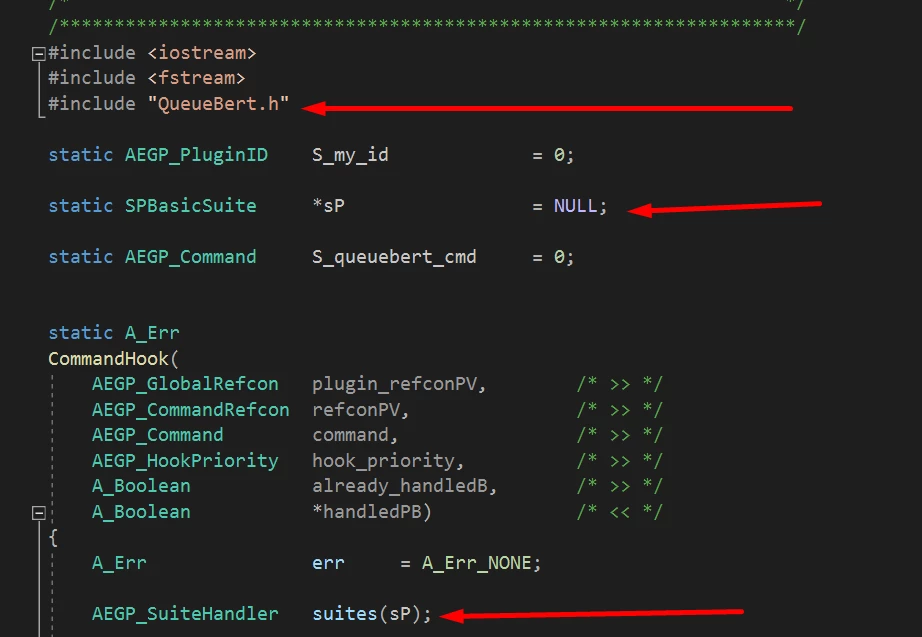

May 19, 2021
Thank you for your response!
Currently I'm running into this problem while using the "Queuebert" project. I've just redownloaded the entire sdk though, so I know it is the latest version and I'm still running into this issue.
Not sure exactly what you mean by SDK in the pre-processor definition, my apologies, I am still learning how to work with plugins.
In the Queuebert project, this is how I am trying to use it currently.
In this picture I've drawn arrows to the pre-processor stuff (from my understanding) and then also when the Suite is declared / assigned. Other than the inclusion of iostream and fstream this is all already done for you in the sample project.
Then when I try to use RQItemSuite4, it doesnt exist.
I tried purging the intellisense but that didn't seem to work. When I looked inside AEGP_SuiteHandler.h, it does mention that it is "deprectated" so maybe that is why? I'm not sure. How are you calling the suite?
Any ideas? I hope this may have been useful!
May 19, 2021
I've just realized after posting this that OP was talking about RenderOptionsSuite4, not RQItemSuite4. However, I tried to use RenderOptionsSuite4 and the exact same issue happens to me as well. I'm guessing it is the same problem for both.
