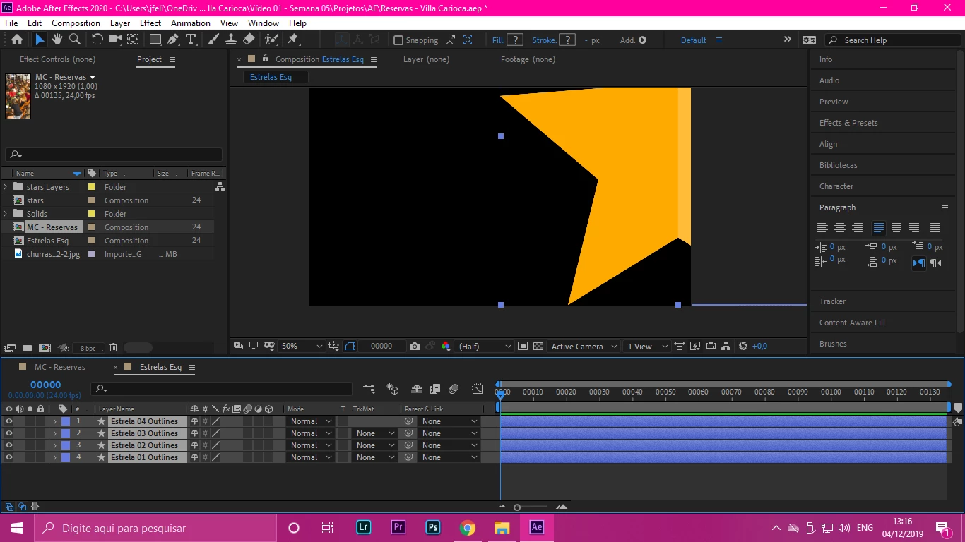

Why does my mask path change position when pasting it on a position parameter?

I'm sorry but I'm about to lose my mind over this. I still haven't found a solution to this problem that works with me (yes, I marked the original post as solved, however, looking back at it now, I can't solve this again).

Sorry, I still have a doubt. Now that I reset the transform properties, what should I do? The star is too big on the main composition. Would I need to create a null, solid or shape and draw a path and then scale it down? Just to make things clear. Thanks

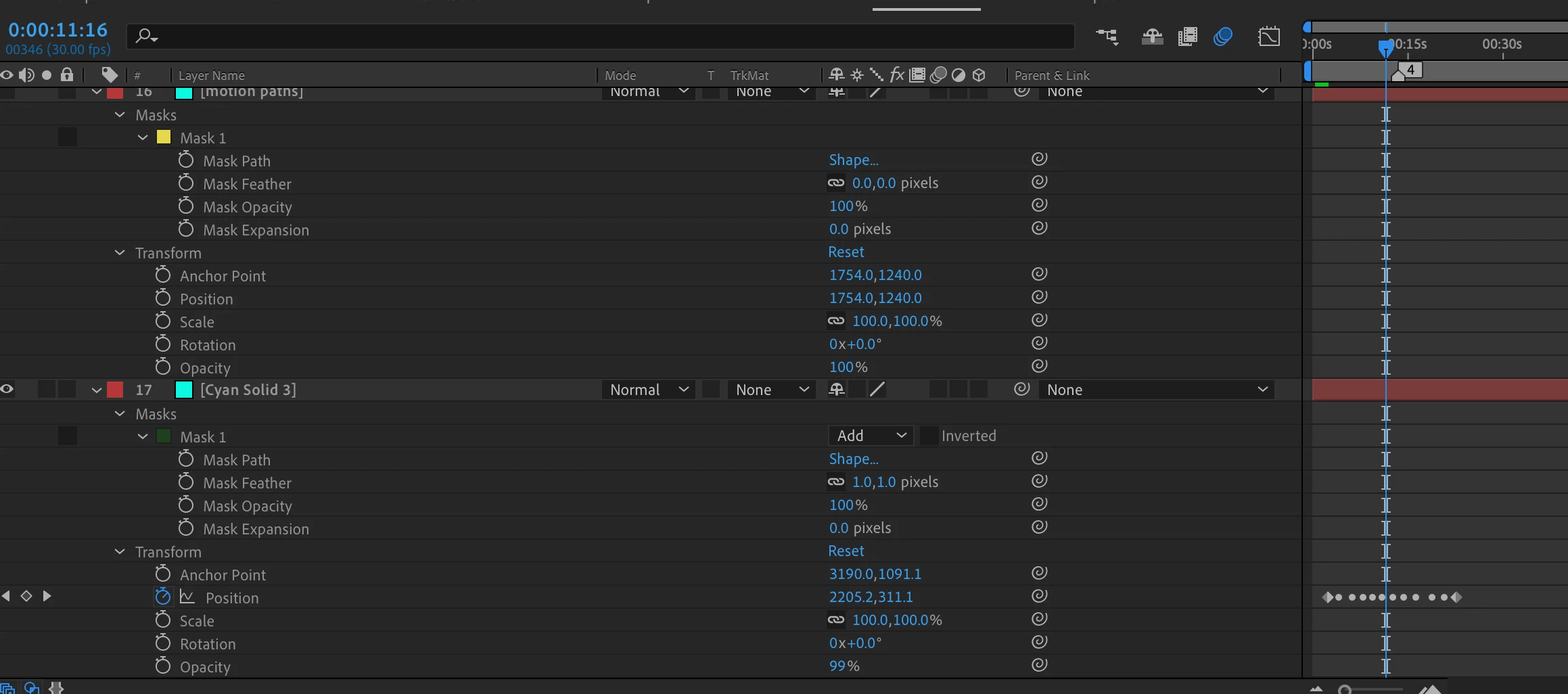

Hi, I came here looking for the same solution - Rick's answer works a treat.
I made a new solid layer named motion paths (which is automatically reset parameters, so I didn't need to change anything about the layer I was moving, which I think is where you're having an issue?) I drew a pen mask path, then copied than mask path and pasted it into the position of my layer that I wanted to move.  I've kept the solid in the project as as a guide layer where I can keep drawing mask paths and cutting them out.
Actually specifically for me, I was animating a mask, so there were a couple more steps (I don't know if this is 'correct' but it worked) I made my mask shape on a solid layer. then centred my anchor point in masked content and moved the shape to where I wanted it to start. This was an important step for getting everything to be where it should! Then I copied the mask path from the other layer into the position of the layer. I like using masks instead of shapes for their feather/expand options.
