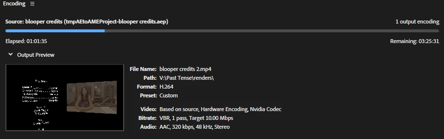

I am rendering a 1 minute credit scroll with an mp4 of bloopers next to it in AE2025 v25.3.2 (build 2). See image attached.
This should not take more than a couple minutes. Why is it taking 4½ hours? It was going so slowly I cancelled and used AME instead, but am getting the same render time.

Thanks for sharing the file. I am getting the same results on my end. I reached out to the devs. They suggested that Advanced 3D is built to perform best with 3D models. For such projects, it's best to use the Classic 3D renderer.
Hope it helps.

I think I figured it out. I noticed my AE was in Advanced 3D mode. When I changed it to Classic 3D instead, it rendered in 8 mins instead of 4.5 hours. Man, that Advanced 3D mode is not worth even having!
