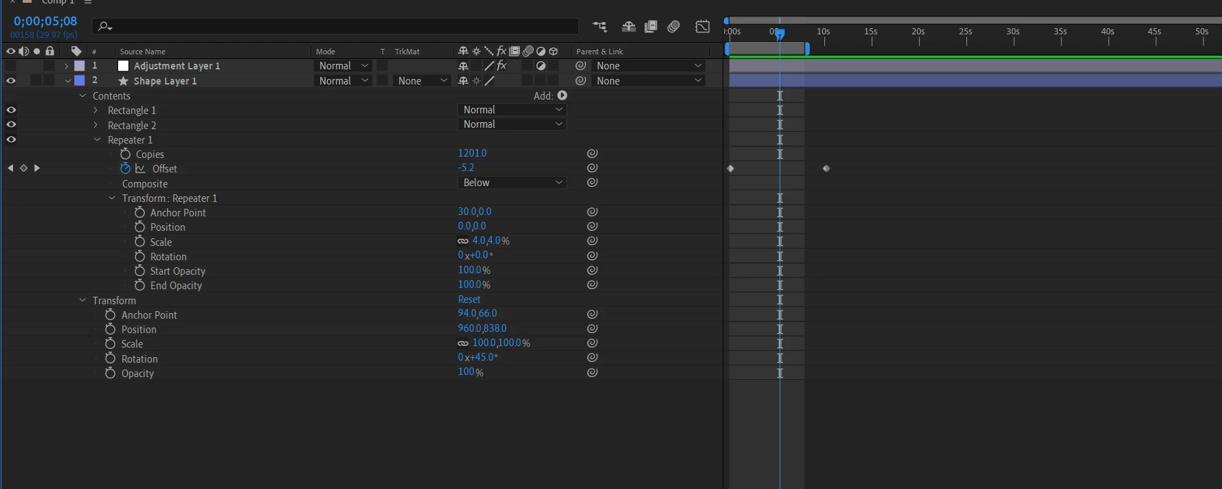

I have the repeater set to 1200 but it is cutting out after what seems about 20 repeats.
It is a very simple comp, just 2 rectangles.
Any help is welcome as it is driving me crazy.
I have used repeaters lots and I haven't encountered this before.
Same with this one, even simpler. I have set the repeater to 4000 so it should go on for quite a while.....but it just stops?
July 4, 2022
You have a math problem, not a repeater problem. If your scale is set to 4% and you repeat a 1000X1000 pixel rectangle three times, the first repeat will be 40 pixels, and the second will be less than one pixel and, therefore, invisible.

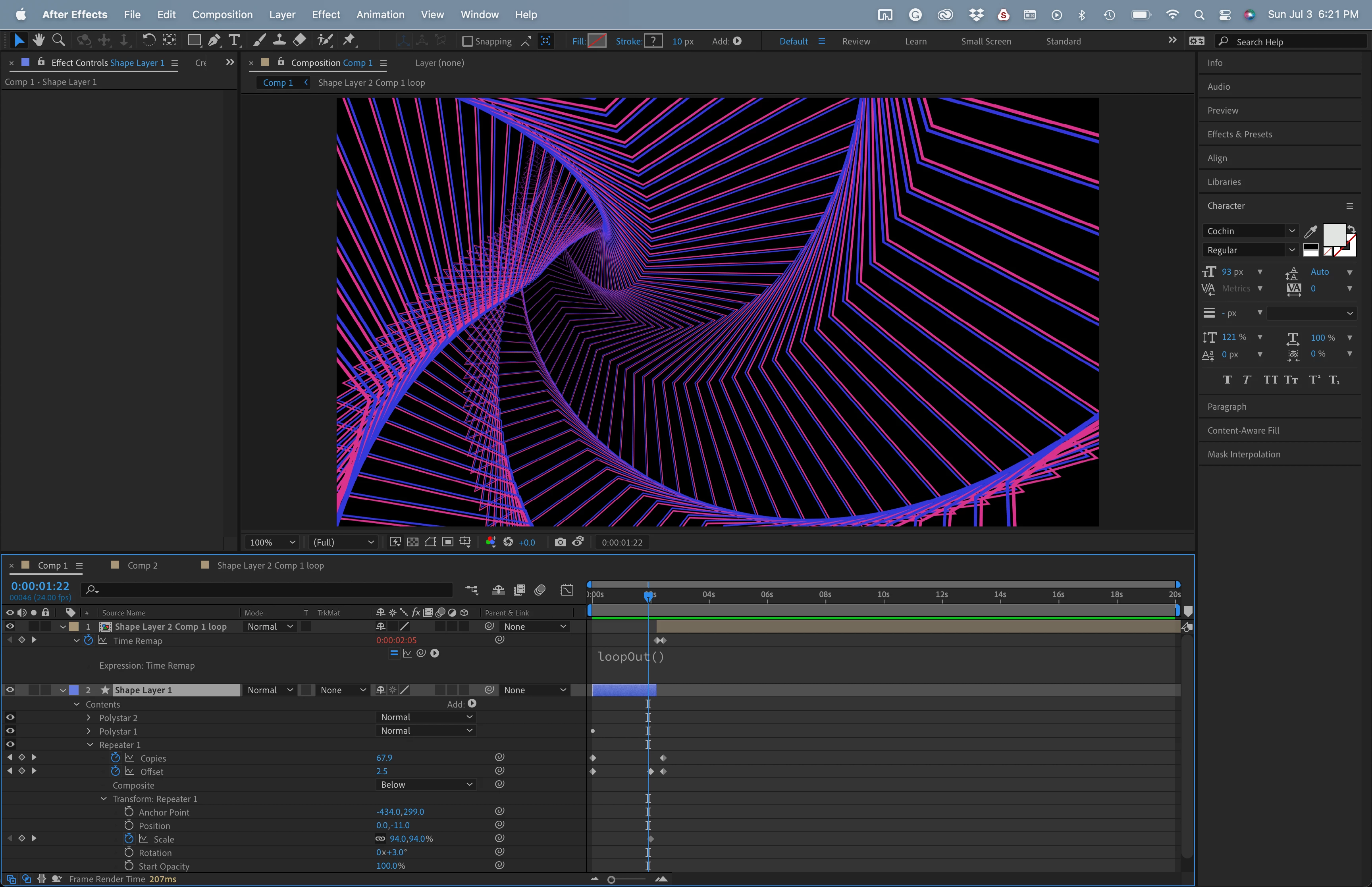

I'm not sure what kind of animation you are trying to produce. If you want a tunnel of shapes to fly toward the camera, the most efficient workflow is to create your tunnel, animate the offset until you get a couple of matching frames, then trim the layer, Pre-compose adjusting the new comp length to the layer duration, then Time Remap, move to the last keyframe, then move back one frame so you can see something. Set a new TR keyframe, delete the last TR keyframe, then add a loopOut() expression to time remapping. You'll get an endless loop of moving shapes that will last as long as you need and render almost instantly.
See the attached comp.

July 5, 2022
Excellent.
The other suggestions of using Echo has worked really well but I will definitely give this a try tonight and see which methods work best for me.
Thank you for your help.

July 3, 2022
I'd guess what's happening is that the accumulated size of all repeater instances exceeds AE's layer/ buffer size limit so they aren't rendering.
