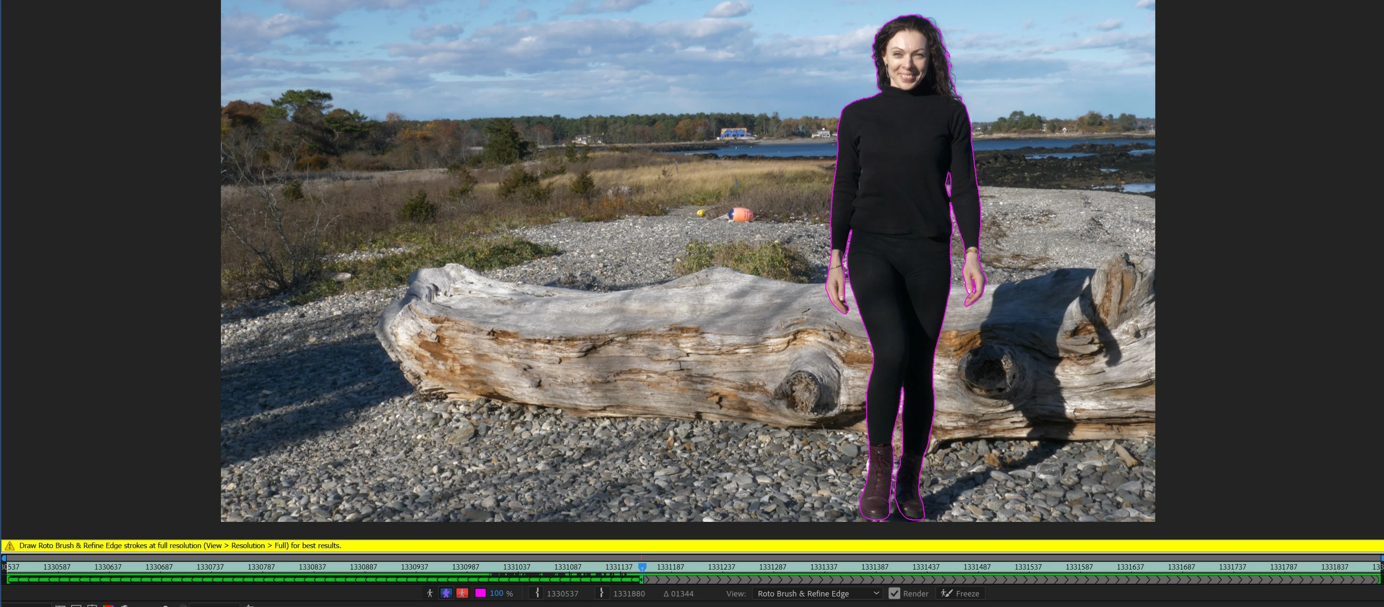

I am trying to figure out how to do a full rotobrush analysis with one click.  In a given clip I have 1300 frames. Baseframe is frame 620. If cursor is at frame 620 and I hit spacebar then I see the clip going from frame 620 to end, and the span bar will become green as it is moving forward.  THen when it gets to end I see the span bar becoming green starting at frame 620 to the beginning.  At the end, it seems the analysis is all done. But only one half of the span bar remains shown in green. Like this:
Why is that? Is this a glitch? The mask seems to have been propogated everywhere, so I just don't understand why there is this visual cue showing the span bar green only for the backwards direction analyzed frames.
Ideas?
November 16, 2024
The gray portion has not been analyzed yet. You need to propagate by advancing the time indicator or pressing the spacebar, fixing any errors along the way, and then Freeze when all frames have been rendered into RAM.

The odd thing is, at first it shows all green to right of base frame, then does the analysis backwards, showing all green to left of base frame, then after that it goes back to gray to right of base frame.  And this is without me making any changes.
