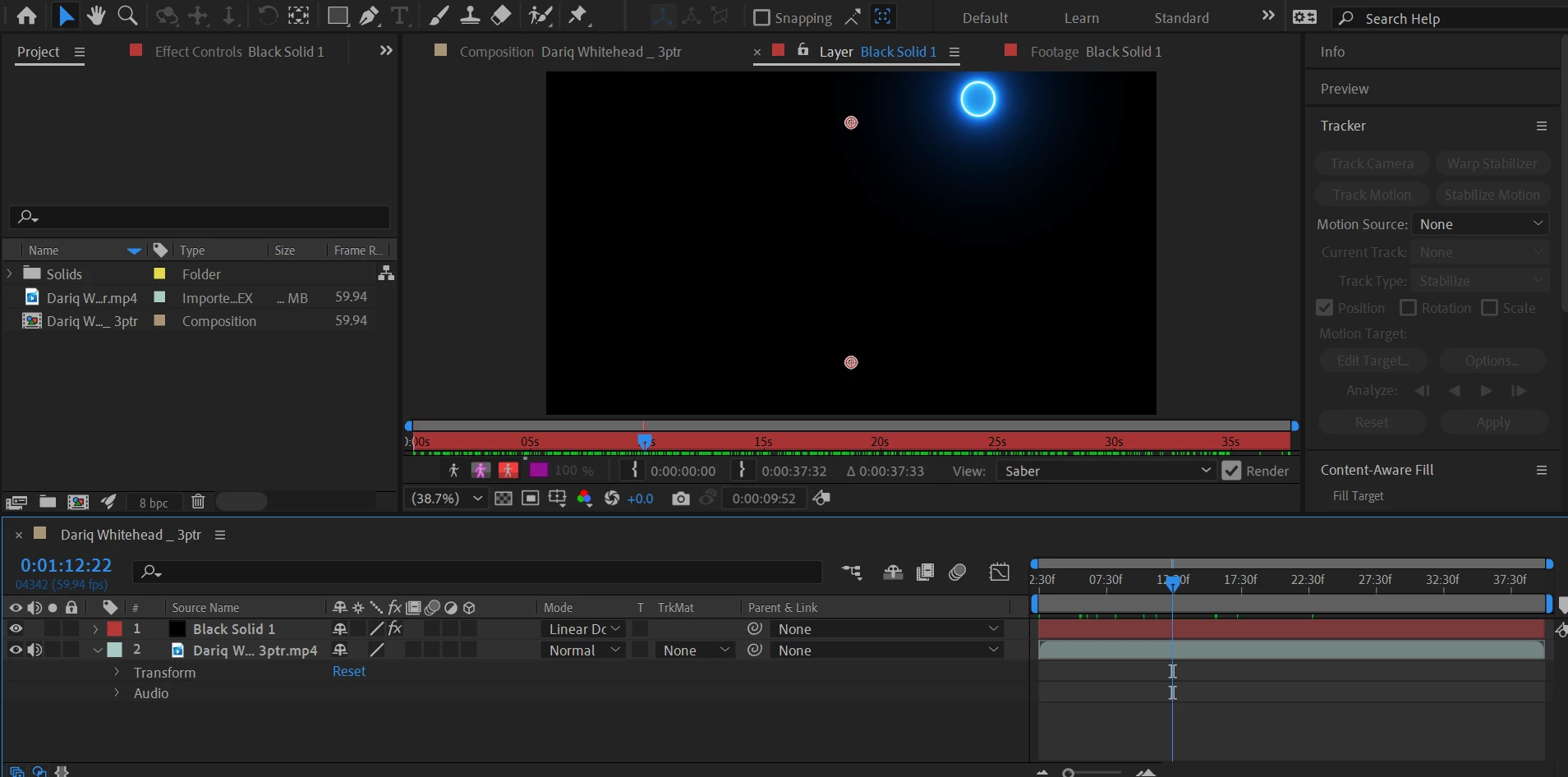

Hello Community,
I just recently started learning After FX and currently in the process of adding Saber affects to a clip. I've watched a Tutorial entitled "How to Use saber to create eric basketball highlights" by Peter Serallas which has been helpful besides this one issue. Once i've attached a solid layer and tracked my video...added the saber affect to a mask layer I cant seem to get ride of the Black Solid when I either click the eye to hide the layer or even when I try to use any blend mode. Due to the fact i'm new am I missing something? Did i forget to turn on or off a setting? I cannot get past this part and its quite frustrating. CAN SOMEONE PLEASE HELP ME!!!
Mylenium
September 1, 2021
Well, you're in the layer viewer, not the comp.

September 1, 2021
Screenshots would tell a lot and of course you've not realyl offered any real info about your system and such. Otherwise this could be as trivial as your hardware acceleration being inadequate, so check the relevant settings, update your graphics driver and/ or switch to software-only rendering by turning off Fast Draft et al.
