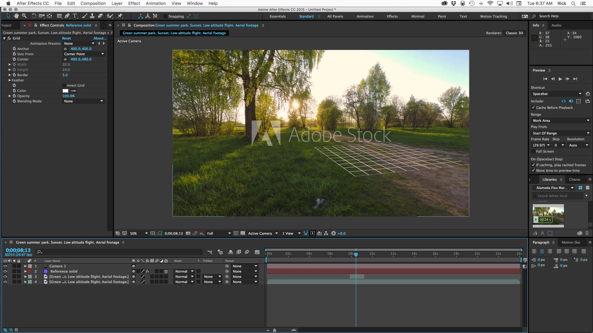

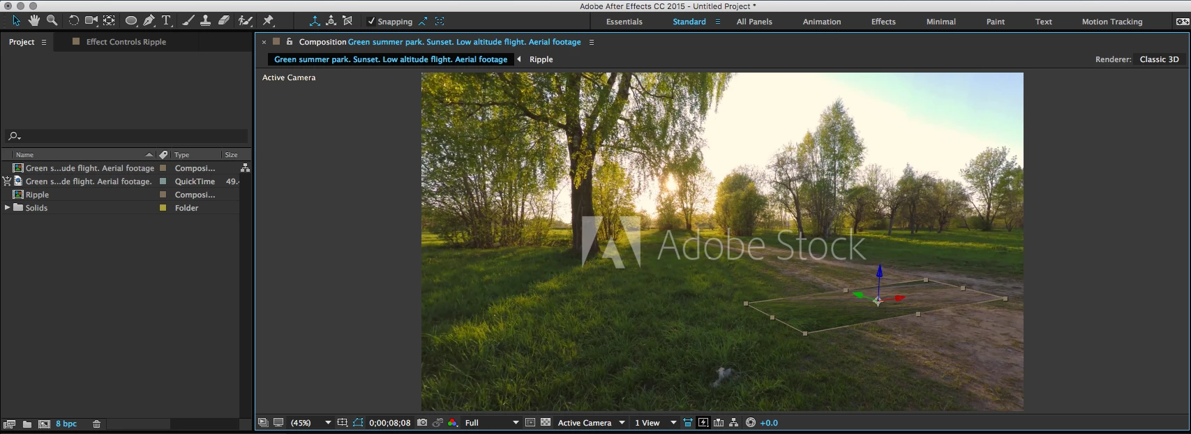

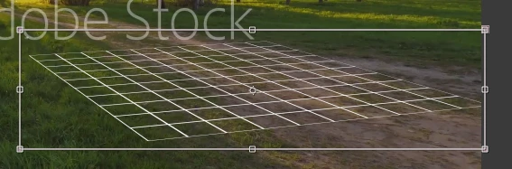

    The easiest solution is to do projection mapping. Another solution is to use corner pin to distort the copy of the footage that you rotate into position. Let me see if I can talk you through the corner pin solution first. It might be the easiest to do and fastest to render. Let's say this is your shot and this short duplicated section is where you want the ripple to be, you have successfully camera tracked the scene and placed a reference solid that is big enough to cover the ripple in the scene. I just pulled the sample footage from Adobe Stock.
    The first step is to mask the trimmed copy of your shot so it just covers the reference grid:
    Copy that mask and paste it to the original footage layer (we'll use it later).

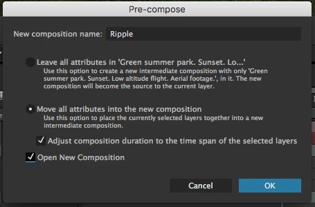

    Now you pre-compose this layer (let's rename the layer Ripple just to keep things straight) making sure that you move all attributes to the new composition, trim the comp to the right length and open the new comp.

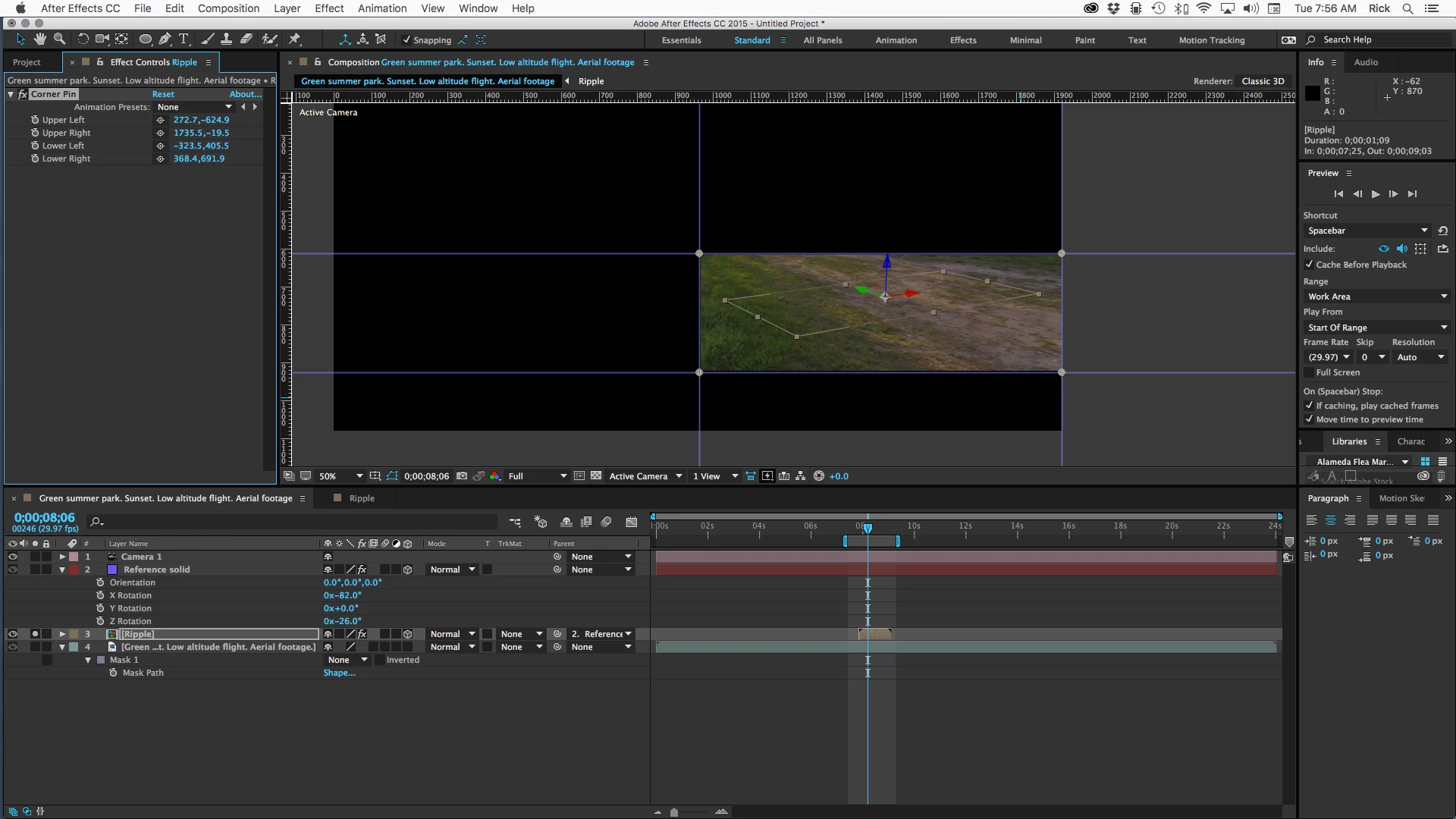

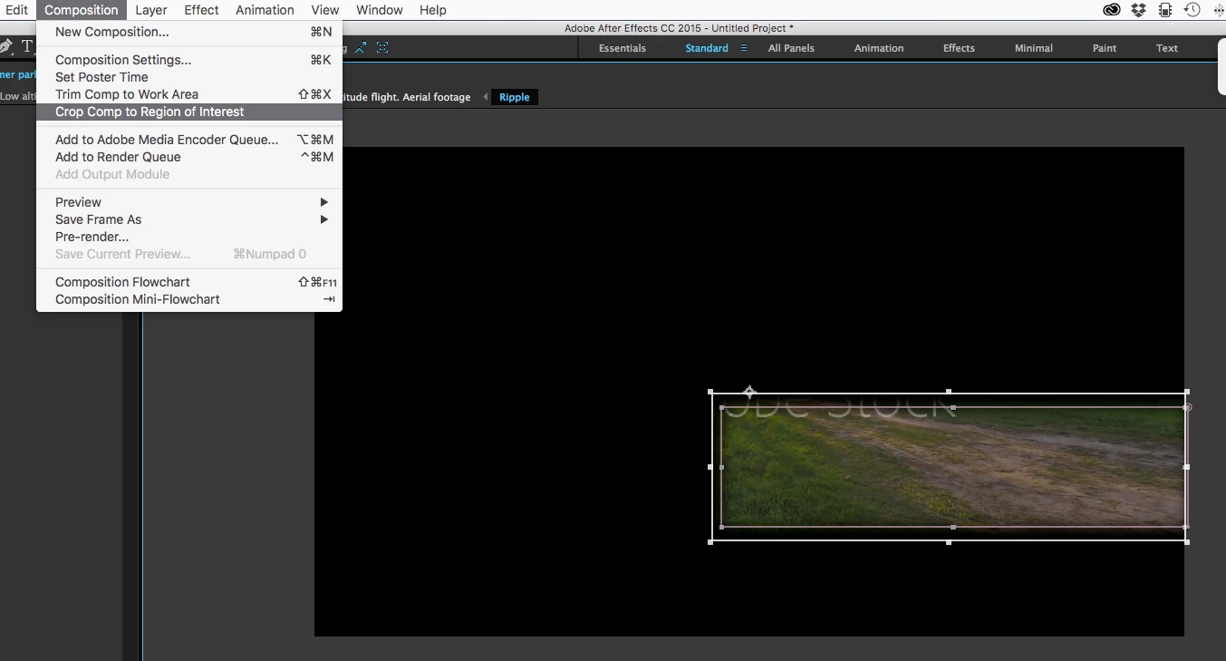

    Here comes the trick that makes corner pin easier to use and the composite easier to make. First press the f key to reveal the mask feather and set it to a value of about 10 pixels. Next, set a Region of interest that just covers the masked area and the feather and crop comp to the region of interest.

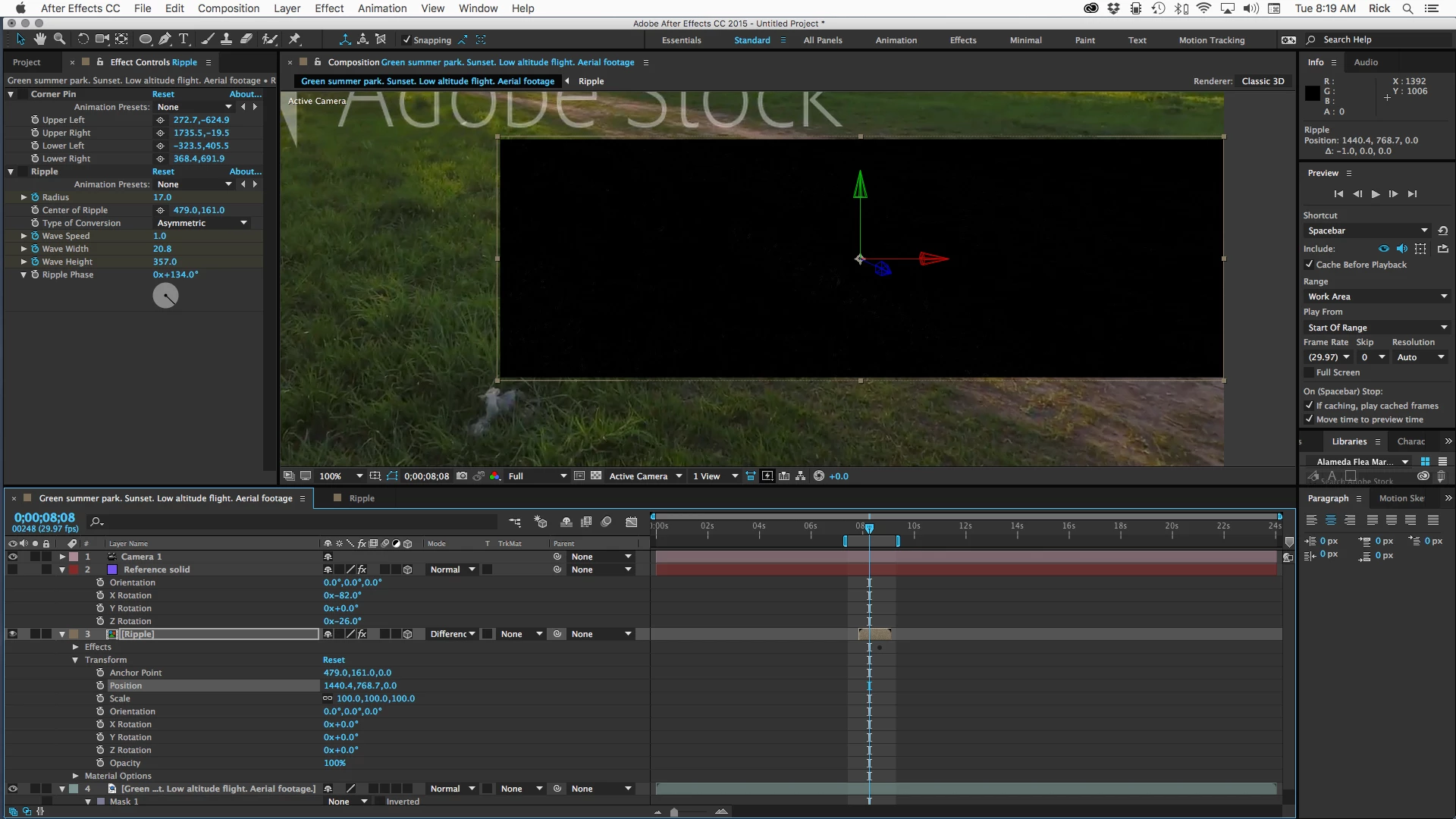

    Move back into the main comp. Your Ripple comp will be out of position. Set the blend mode to difference to help you position the Ripple comp precisely over the original footage. You should see nothing but black. You are lining this layer up just to help you position the guides .
    Now Enable the rulers (Ctrl/Cmnd + r) and drag out guides that precisely line up on the Ripple layer. Turning off the original footage may help. You also can turn off the reference layer.

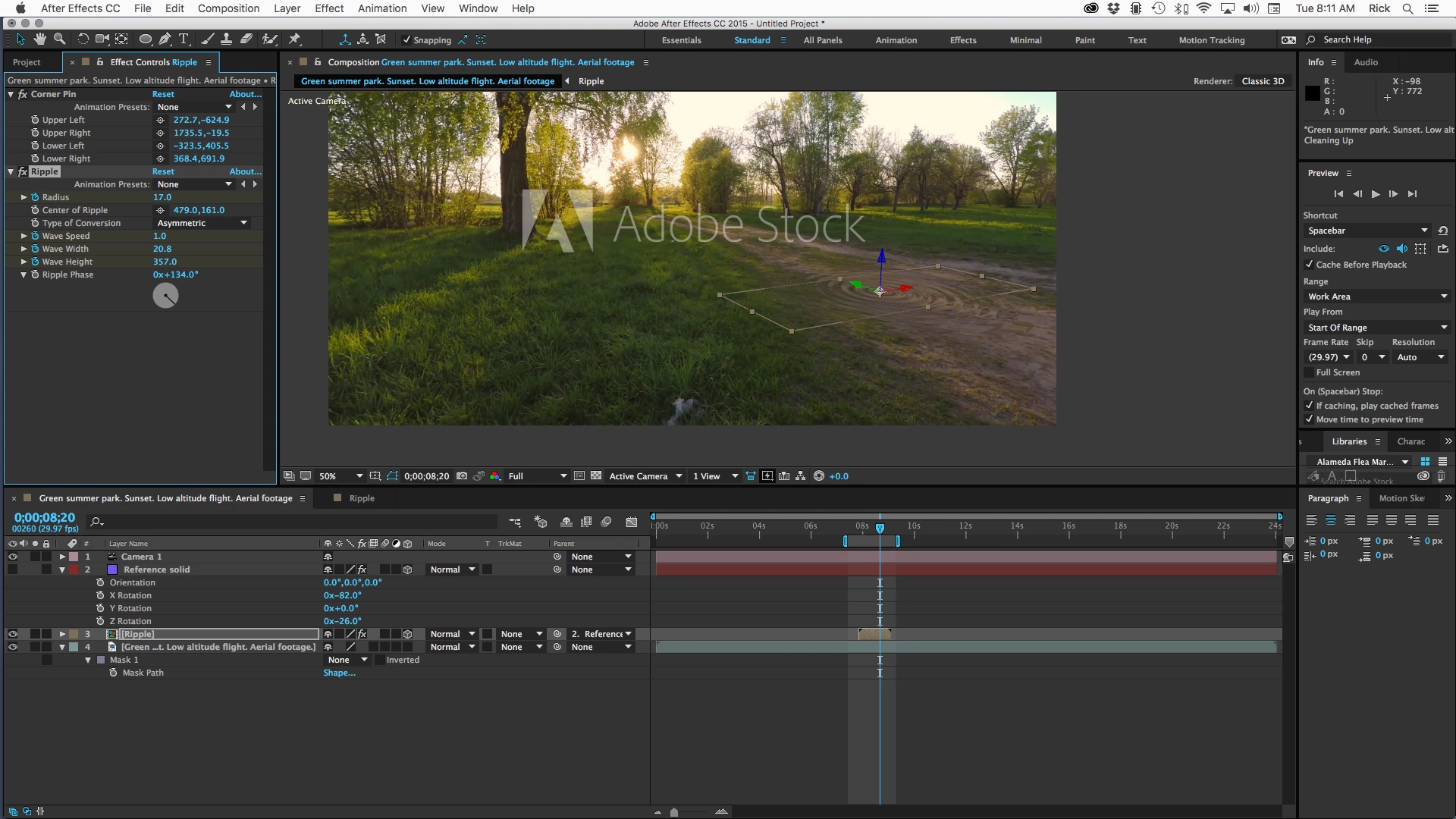

    Now set the blend mode back to normal, make the ripple layer 3D. Here's trick number 1. Hold down the shift key and parent the Ripple layer to the reference layer. This will match the position and rotation of the Ripple layer to the guide layer.
    Now add the corner pin effect and to the Ripple layer and drag the corners to the intersection of the guides like this: I turned off the bottom layer to make things easier to see.
    You should have precisely lined up the 3D layer with the original footage. Turn back on the footage layer and make sure that you don't see any jump when you preview the transition between the shots. To make this preview quicker reset the work area to just cover the part of the shot you are working on.

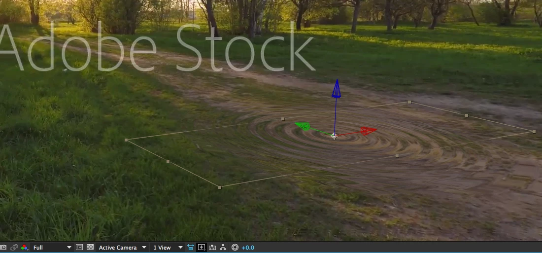

    We're almost there. Turn off the mask on the bottom layer, Turn off the Reference layer and add the Ripple effect to the Ripple layer and make adjustments and animate the effect:
    You may want to add a track matte or do some other color corrections to emphasize the ripple, but that's how it's done with corner pin.

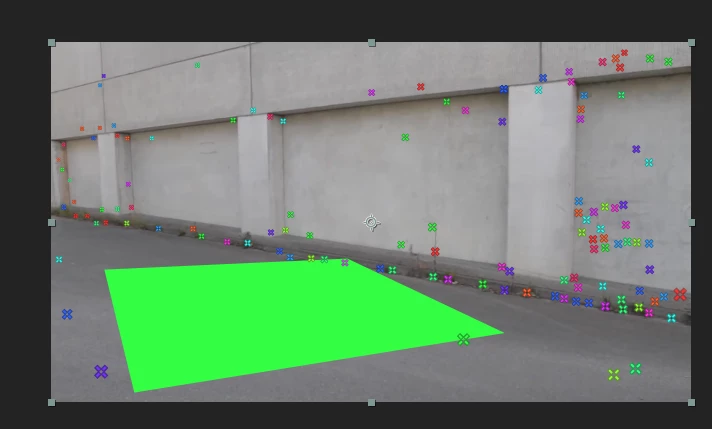

    1. this is my 3d scene. I have tracked the camera and created a 3d solid that correspondences with the floor

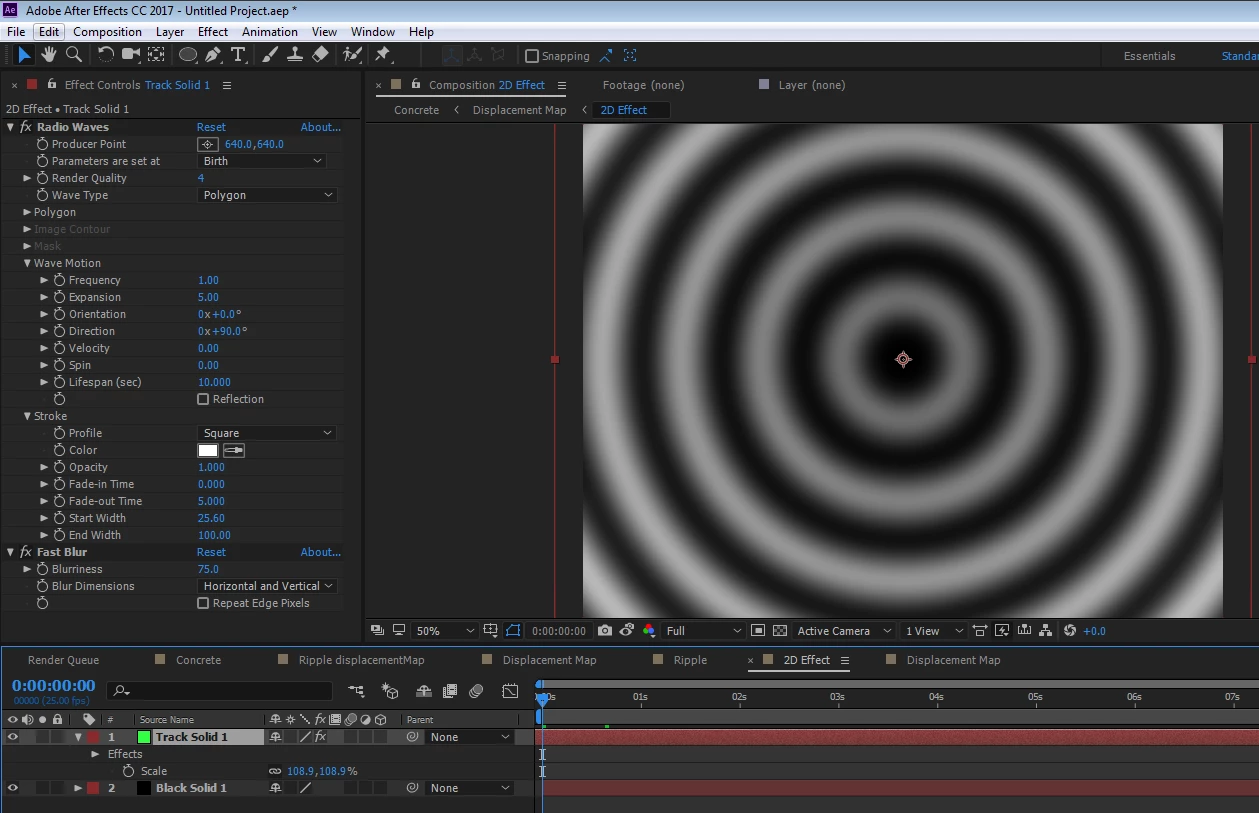

    2. this will be my effect layer for the ripple. I will create a precomp from this layer - leave all attributes. this will be my 2d layer with a 2d effect.
    I can use this type of setup to create my ripple.

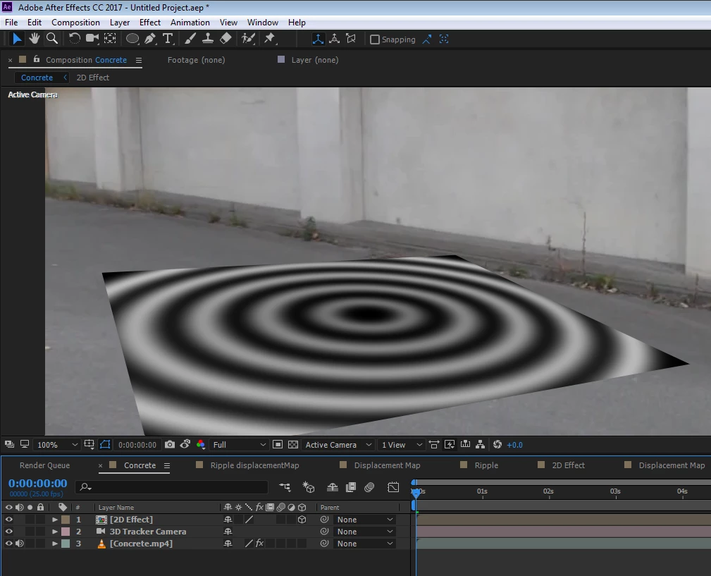

    now I got this in my master comp:

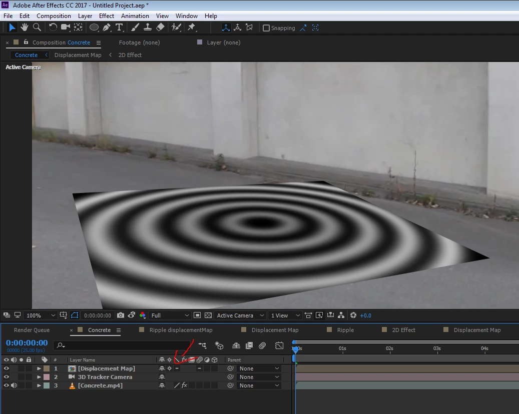

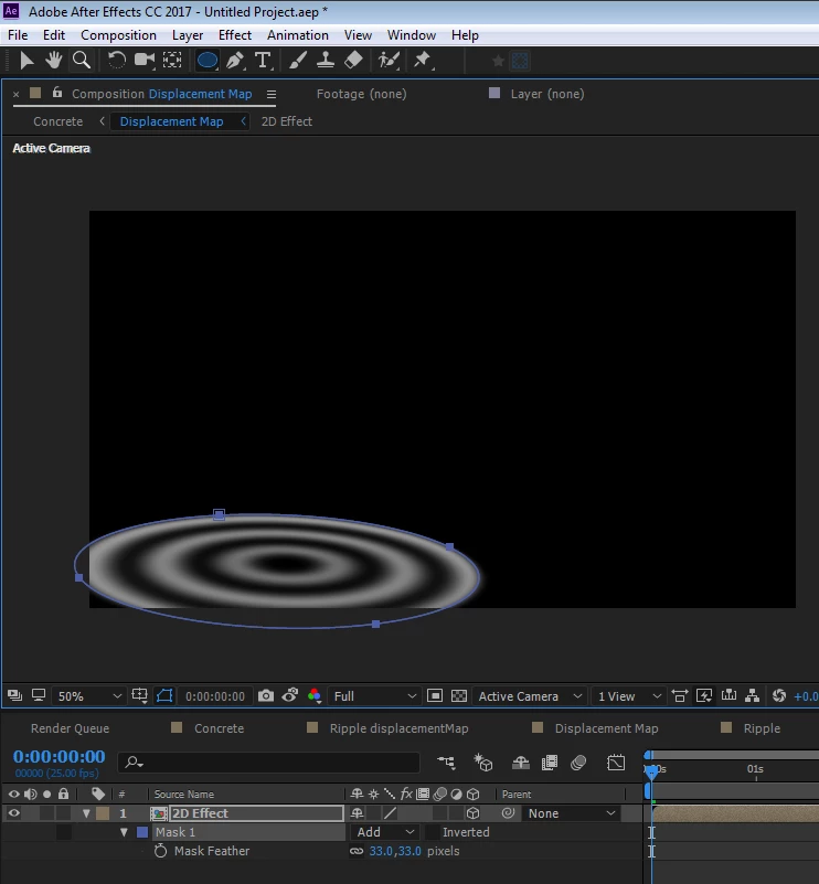

    now I will precomp the 2d effect again. this time - move all attributes. this will be my displacement map layer. I will also click on the collapse switch so that my camera could interact with the 3d layer when it's in a precomp.
    a bit of masking in the precomp:

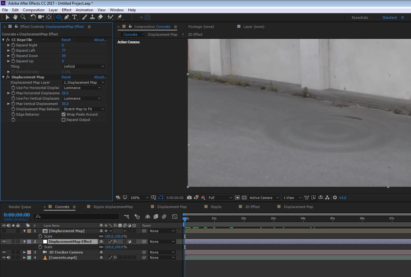

    now In the master comp will add an adjustment layer and apply the displacement map effect and use the effect layer as my displacement map. I also added a tile effect because the layer is cutting off scene. you may not need to do that.

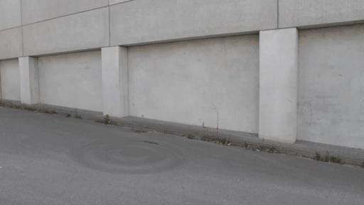

    now I got this:
