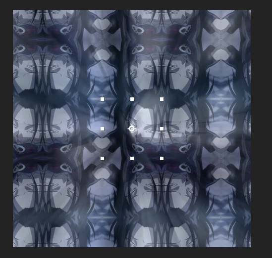

Im a really new editor and edit since 5-6 months. A few days ago i got a new pc (really high end pc ryzen, nvidia rtx 3060, watercooled etc.) And now i have some trouble with my transitions for amvs. Everytime I do a transition with motion blur and rsmb I get at the beginning of the clip a weird Frame:

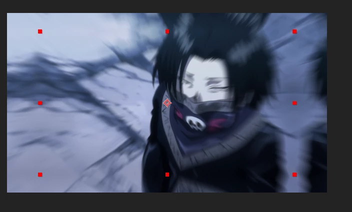

I jsut made a simple 25 scale zoom transition my graph looks normal. Just after this one Frame the transition goes as normal: (this was a different project file but it is the exact same)
idk what to do

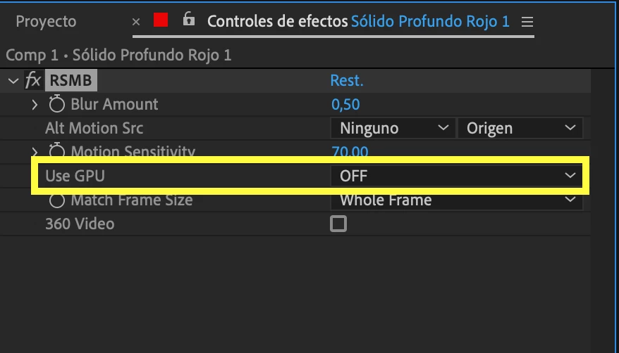

Correct answer Jose Panadero
I have a question for you. It. looks like you have scaled the clip (I've seen the boundaries of your layer inside the comp). Probably you need to precomp.
Anyway, it could be a problem with the GPU. RSMB has an option to deactivate the use of GPU acceleration. Have you tried to set the GPU to OFF? Check attached image.

Jose PanaderoCommunity ExpertCorrect answer
September 18, 2021
