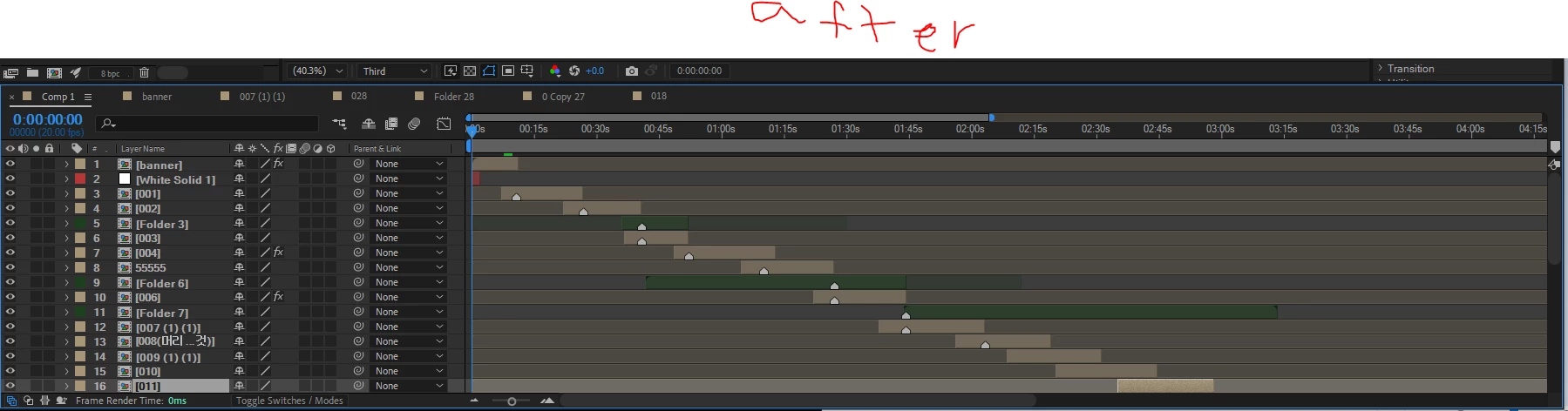

will it be optimized if i shorten the layer like this?
  • July 19, 2022
  • 253 views
Thank you so much for your kind reading in advance

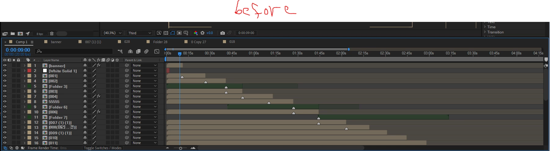

Now, my AE file layers are shown as attached file named 'before'
But there are so much buffer due to many layers
if i shorten the layers like attached 'after' png file, will it be optimized(preview speed improved) and render speed will be improved ?
Thank you !

After Effects calculates every pixel on every frame. If you set an out point for a layer, those pixels are no longer included in the calculations.

Long and short: No. Since AE's render order is stricktly based on teh stacking order and the properties, it is kind of self-optimizing anyway. Yes, you may be helping mnemory consumption by not loading soem content in certain sections and you may also prevent effects from screwing up section where they aren't even doing anything, but otherwise you don't really gain anything. trimming the layers just in the hopes of performance gains really does not do much.
