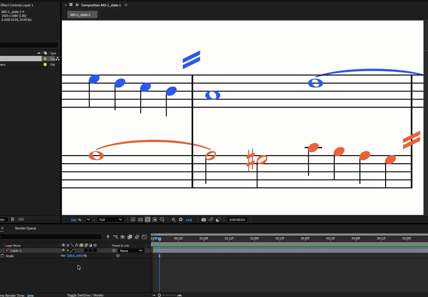

    You can expect crisp vector graphics in After Effects. Check out the GIF. This is your file, and I can scale it indefinitely. Do you mind sharing a screen recording of what you’re seeing? Do not crop the video. A screen recording of the full Ae UI will be helpful.
    Looking forward to your response.
    Nishu
