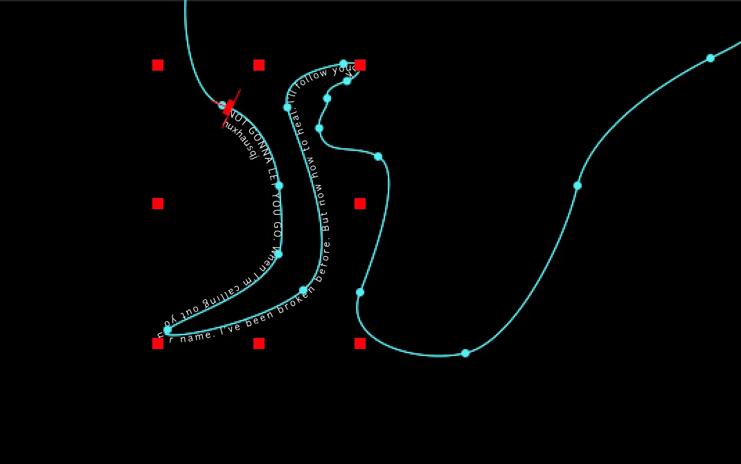

I'm trying to do an animation were text create a bunch of different waves and lines.
My problem is that I create a path to wrap the text on using a mask, but at some random point during the text it creates a line break even when it hasn't finished wrapping the whole path. Does anyone have any idea of what i can do?
I have already tried changing the shape starightening some nodes but it still creates this break.
Even if I turn on force alignment it doesn't help it forces the two lines.
There is also not a break in the text, I haven't pressed enter in between lines to create the break.

I suspect that you created a text box by clicking and dragging with the Type tool before you added the text.
The other problem could have been a carriage return.

JulianaRojas
Oct 19, 2023 2:17 PM UTC
Thank you so much!!! That was exactly it!
