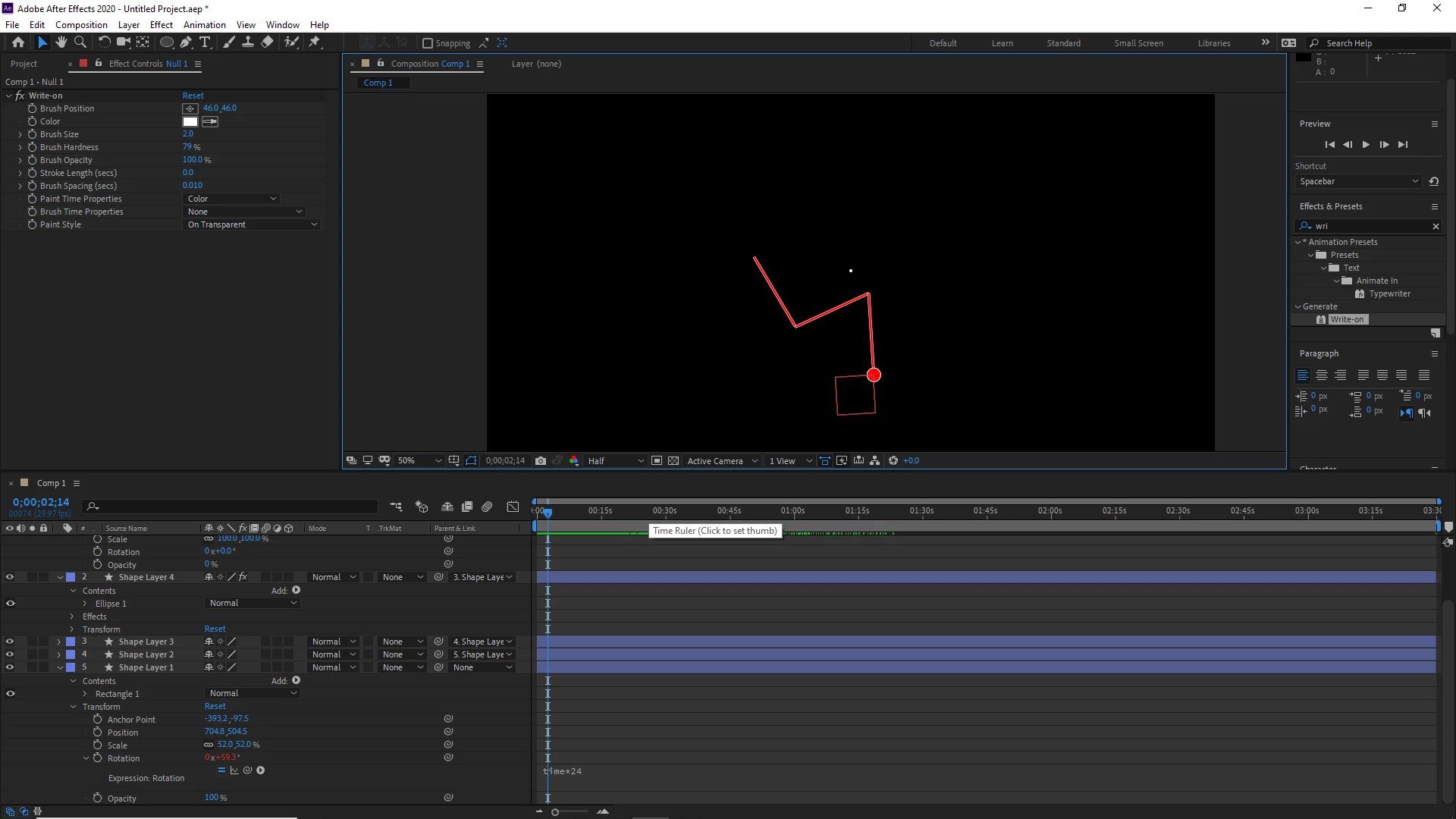

Hello!
I want to use the write-on effect on a robot-like arm that moves in circles, and i created the arm by parenting objects to each other. I then parented an object to the end of the arm and attached the write-on to this. So everything moves when I animate the rotation of the objects but the write-on is not writing. And I assume it's because the move-coordinates of the object on the end of the arm are not changing.
Does this make sense, and is there a way around this??
Correct answer Mylenium
You completely misunderstand. A Null is a non-rendering layer type to begin with and Write-On does not trace the layer motion. You need to apply the effect to a solid covering the entire comp and connect the effect's internal crosshair control with a pickwhip expression. In addition, however, you may need to use a layer space transform like toComp() and additional math to compensate for the positioning of the shape layer groups and the different coordinates used.
Mylenium
Mylenium
MyleniumCorrect answer
March 11, 2021
Mylenium
dose0D45Author
March 11, 2021
Hmm, ok! Yes, the null was a shot in the dark, i just wanted to find something that would change the position-coordinates as it was moved around by the arm so i could control the position of the write-on with that. And pardon my french here, I am indeed learning by doing. But of course, the write-on needs a solid to write on, makes sense 🙂 I will dig abit deeper based on your suggestions, thanks.
