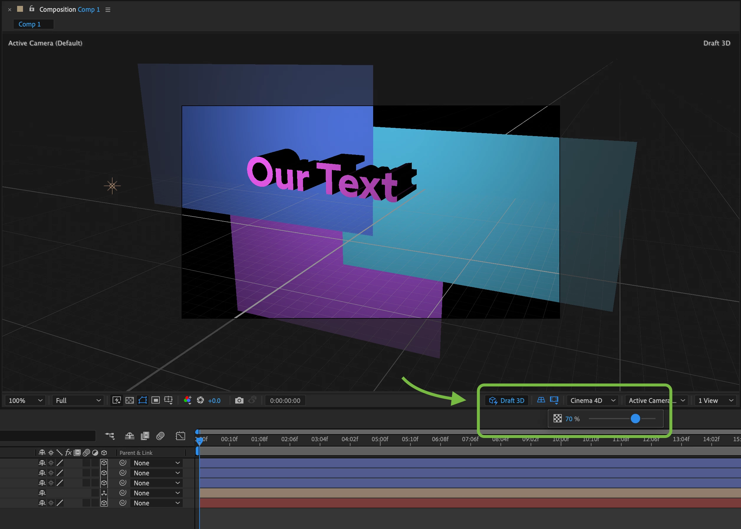

Thanks for mentioning this! A 3D ground plane and extended viewer (outside the rendered area) were added in the 2022 version of After Effects, inside a new real-time Draft 3D engine that allows you to quickly navigate your scene and see how everything is laid out. More details are available here: https://helpx.adobe.com/after-effects/using/work-in-3D-space.html. The Draft 3D engine works more like you'd expect from a 3D package in that it doesn't display "full fidelity" but renders the layers fast so you can place them and create camera moves before switching back to the output renderer for the final look.
Note the ground plane and layer outside the rendered area in this screenshot from After Effects 2022. You can long-click on the Extended Viewer button to adjust the opacity of the display outside the viewport.
You can use it with both the Classic 3D (2.5D) renderer and the C4D renderer, as well as with the new Advanced 3D renderer in the current Beta builds.
