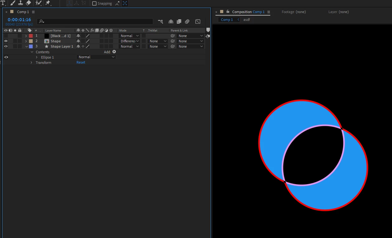

Precomp with simple circle has no internal blending mode / continous raster off / blend mode set to differnece in main comp.

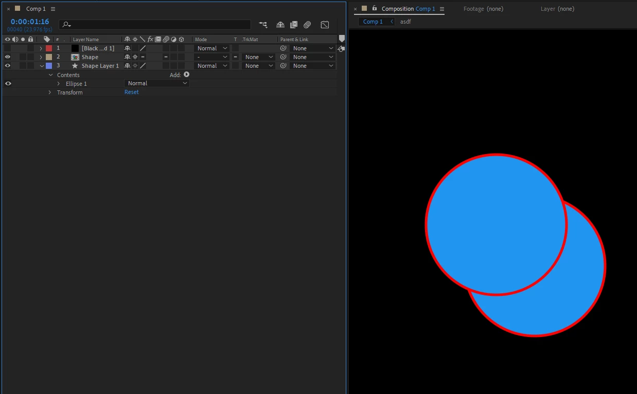

Continious raster switched to on. Blending mode ignored as shown by the (-) in the blending mode drop down.

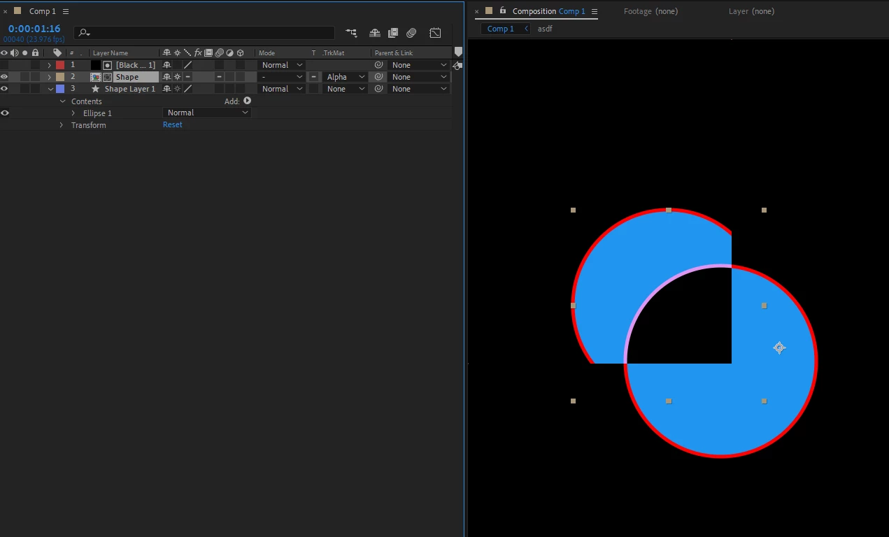

Track matte enabled for layer, continous raster switched on, now using differnece mode again even though AE is still showing pass through blending mode (-).
