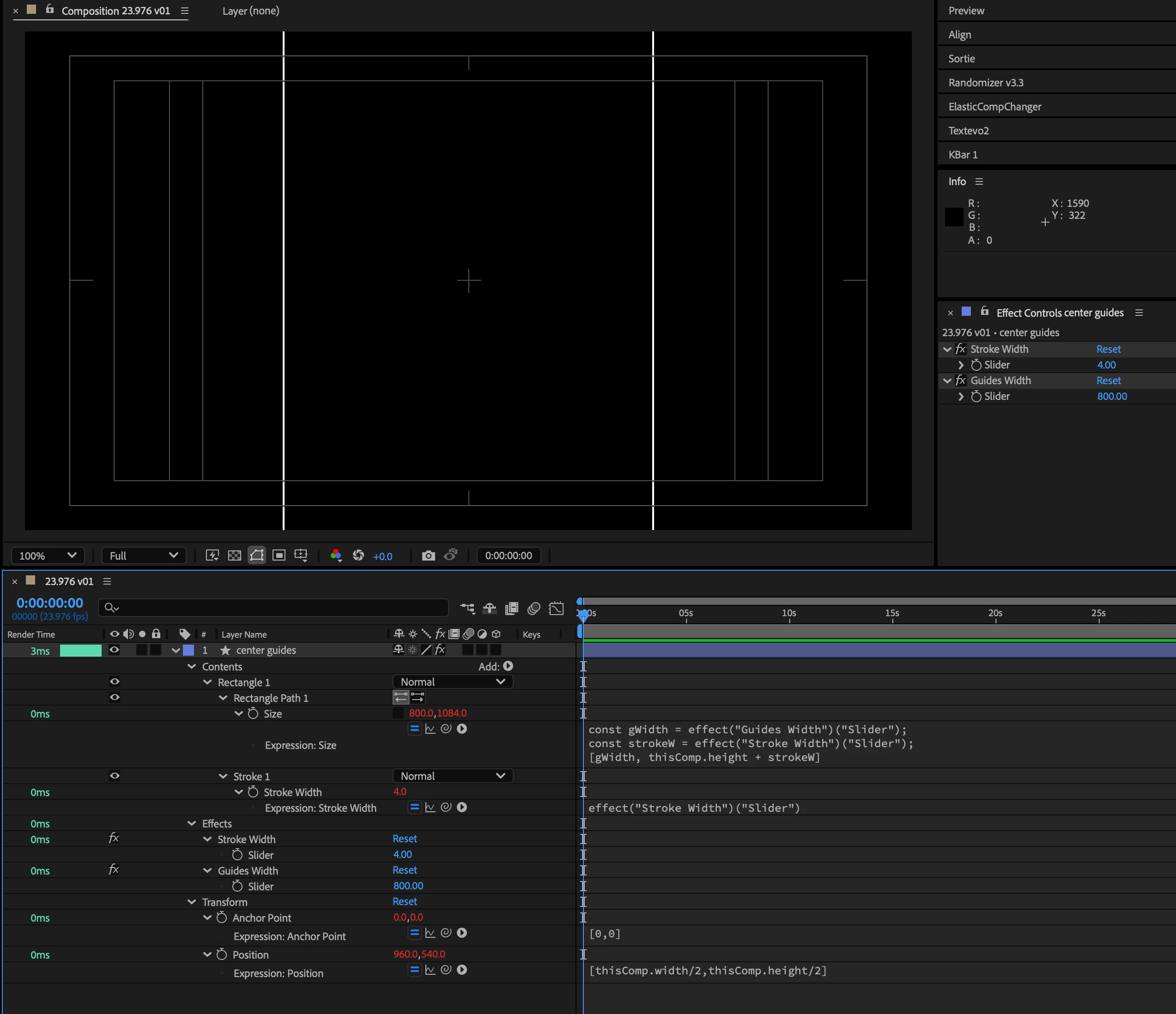

You can make a rectangle shape layer, delete the fill, add a stroke, make it taller than your comp, adjust the size width, and maybe set it as a guide layer. Then make it preset to reuse it. (Presets can’t save guide layer type though.)
I attached a preset, and its sample project, with some extra expressions to make it friendlier: https://we.tl/t-NA5WHMkGHD (Unfortunately this link expires in 7 days)
