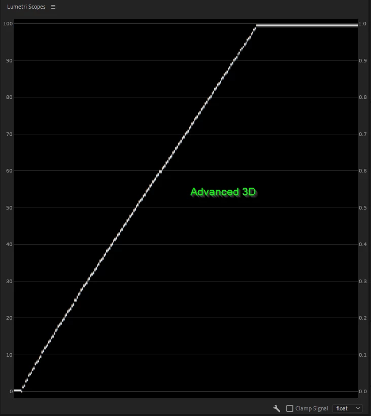

As you may have noticed, as of After Effects 24.1 build 14 (so for a while now), there were big changes to the rendering of non-model 3D layers in the Advanced 3D engine. Imported models have always used physically-based rendering for their materials and now objects created internally within After Effects do too. Any solids, precomps, text, and shape layers with the 3D switch activated are now textured and renderedwith Adobe Standard Material, a Physically-Based Rendering-material format capable of more accurate and photographic looks.
This may have some impact on the way your 2D layers look when you click the toggle to change them to 2D to 3D, but it enables significantly more integrated and beautiful lighting and rendering of your scenes.

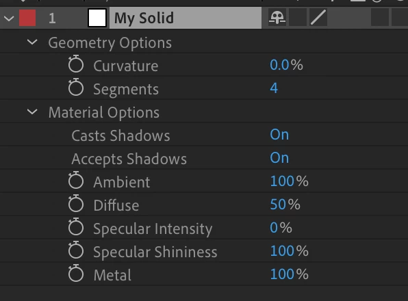

This release adds support for five Adobe Standard Material channels using After Effects traditional material channel names. You can get to them by twirling down your 3D layer to Material Options, or by hitting AA on the keyboard with a 3D layer selected. The default values applied are shown below, but this is a Beta feature and thus, these default values are subject to change.
Ambient controls how much of After Effects ambient lighting is applied to this layer, if any is present (there may not be any). This behaves similar to the ASM emissive property but does not cast light onto other objects.
Diffuse maps to the ASM Base Color channel and will pass through your layer’s inherent color— the one you see when it’s viewed in 2D. Setting this to 100 will help you get the closest match to the 2D version of a layer.
Specular Intensity is mapped to the ASM specular level.
Specular Shininess is most easily thought of as inverted ASM roughness (0 is a very rough material, 100 is a very shiny material). Note that the response is non-linear, and changes may be most visible in the middle of the range.
Metal is the ASM metal channel, which controls how much a surface alters the color of specular reflected light.

- To have more physically accurate lights to go with your new physically accurate materials, set the light’s falloff to Inverse Square Clamped. This will give you a natural and realistic gradient the further your objects get from the light.

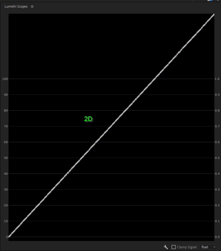

- If you want your 3D layer to match the look of the 2D version as closely as possible, turn Ambient and Diffuse to 100 and turn down Specular Intensity, Specular Shininess and Metal to 0.

- As mentioned before, artwork that was changed to 3D now becomes a full-fledged, first-class 3D citizen, capable of being lit by and casting shadows from the Environment Light. This is different than Classic 3D where 2D art turned into 3D layers was flatly lit unless lights were added to the scene.
- As also mentioned before, you’ll get the closest match to your 2D art by turning Ambient and Diffuse to 100 and turning down Specular Intensity, Specular Shininess and Metal to 0.
