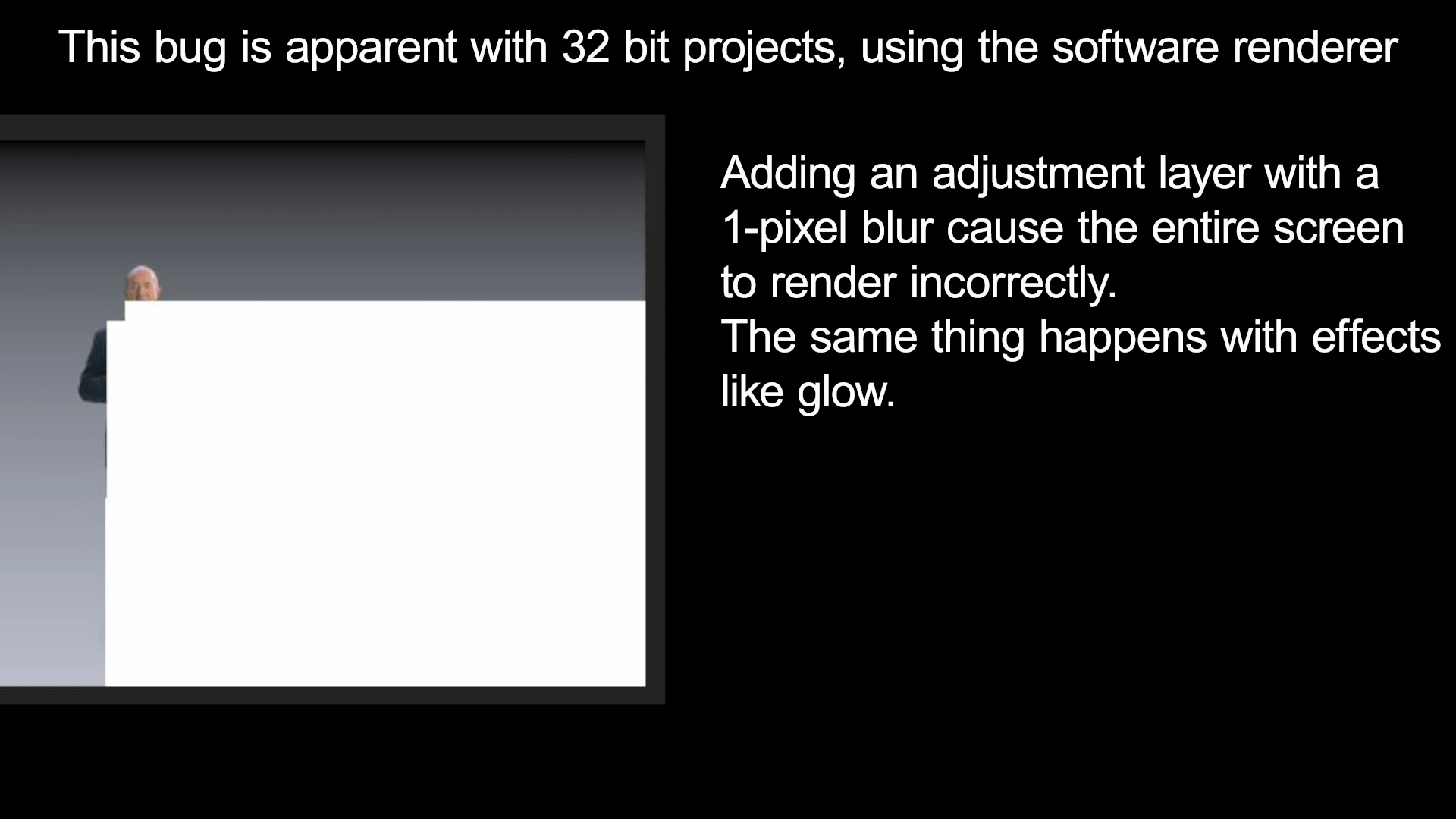

I have a few issues with NaN pixels in 32 bit projects. These problems are still in the latest Beta, but are the same for earlier public releases too. It does look like the problem is different when using the software renderer (worse) than the Mercury GPU accellerated renderer.
I have a project that I have zipped up ready to share, but I don't seem to be able to upload a .zip Contact me to send you the file, it's less than 5 meg in size.

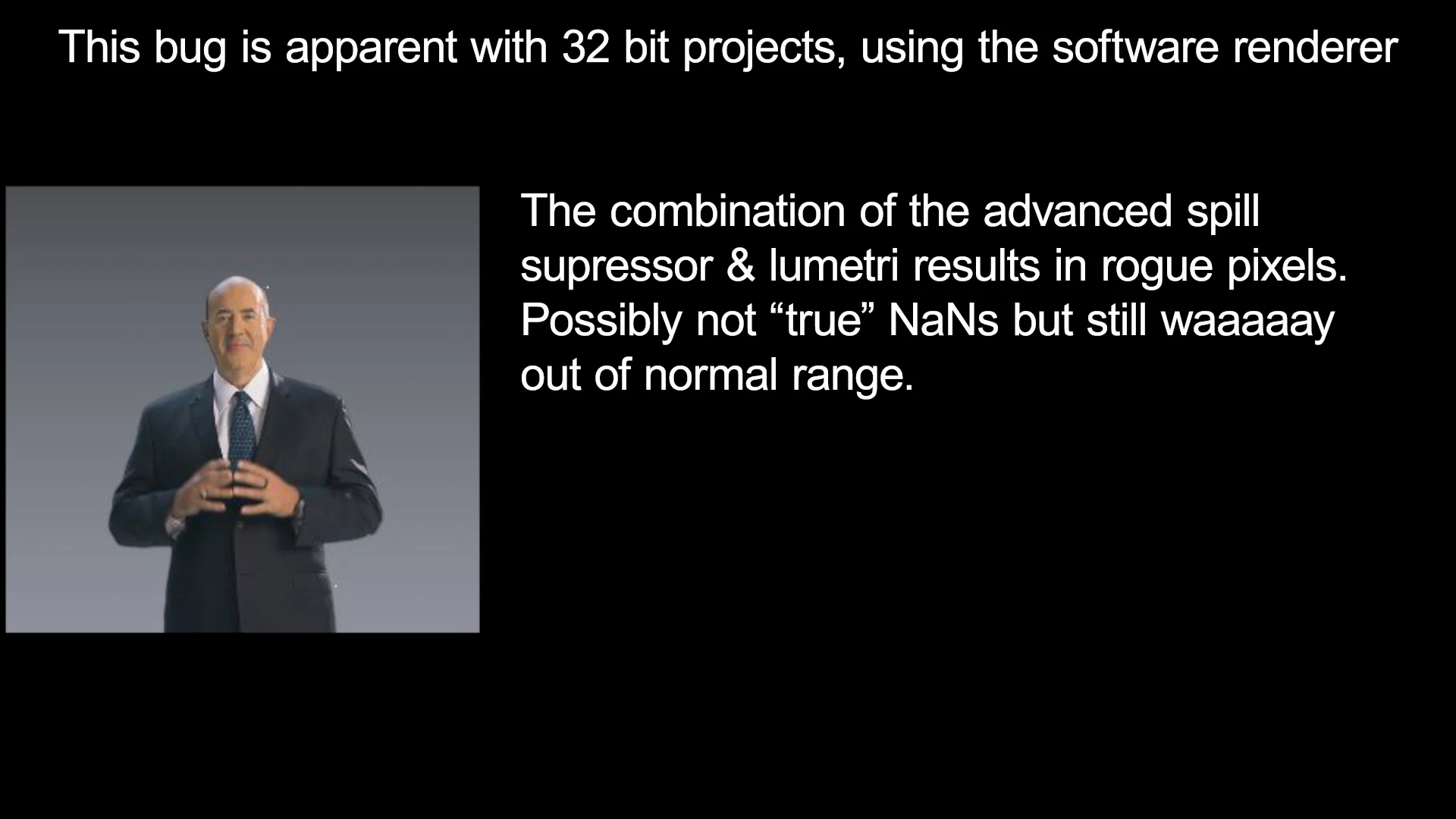

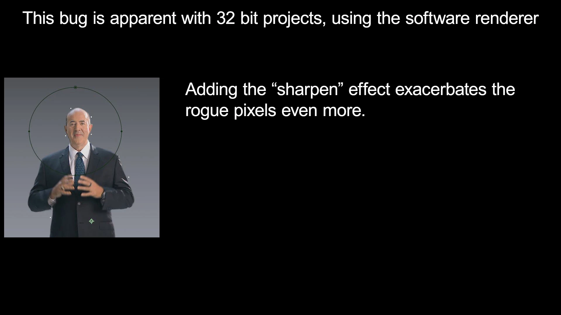

Basically: The combination of the advanced spill supressor and lumetri plugins produces rogue pixels that are way out of range. These pixels then cause more artefacts / corruption when other effects such as blur & sharpen are used.

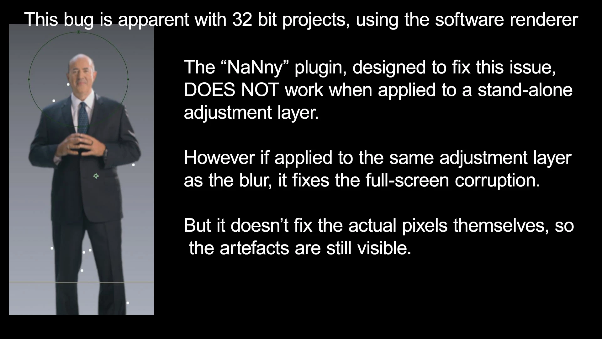

There's a freely available "NaNny" plugin that exists to fix NaNs. Oddly, this plugin doesn't seem to work when applied to an adjustment layer. However it does work when applied in an effects stack.

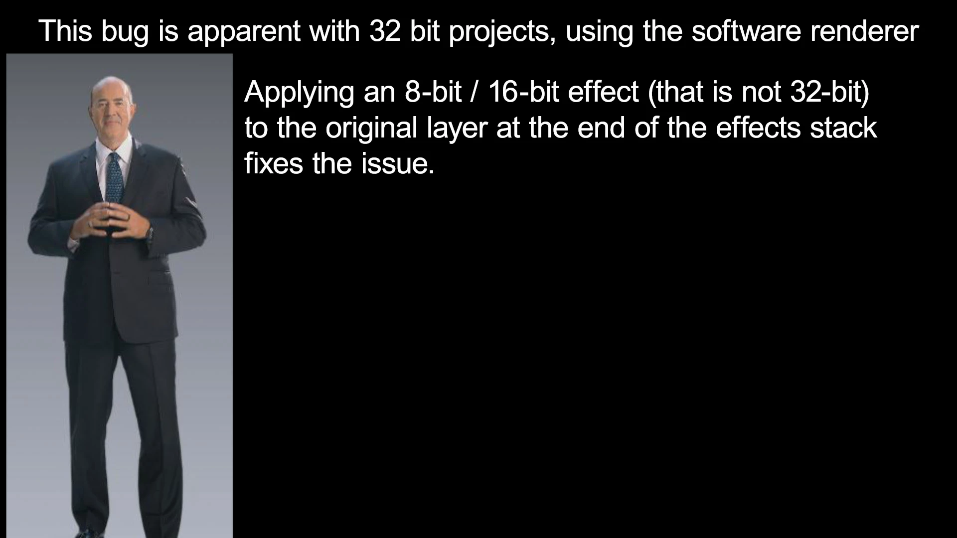

Adding a non-32bit plugin to the original layer also fixes the issue.
