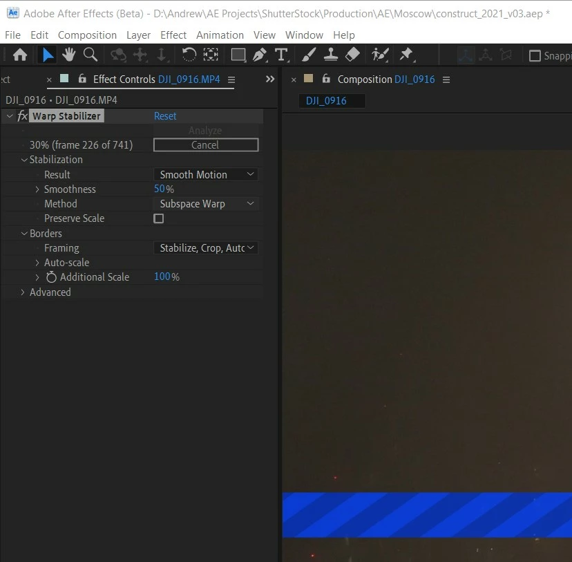

New Warp Stabilizer Freezes at Analyzing
Hello! New warp stabilizer freeezes, when analyzing, % and time are not changing, and if I press cancel  After Effects becomes "not responding".
My specs are: 3x 1080Ti, Windows 10 20H2, Threadripper 3960X, 128Gb Ram, 1Tb NVME SSD, 14Tb HDD.
Input file is from DJI Mavic 2, h265 mp4.
https://drive.google.com/file/d/1UtBoIXGWlfHlPxU6qT9dZd09CjoYD7W4/view?usp=sharing

Hi, thank you for reporting the issue and sharing the project and media! This is extremely helpful for us. We will investigate this issue, and in meantime can you to try few things-
1. In Advanced section, turn off "Fast Analysis". See if it fixes the issue for you.
2. In Advanced section, turn on "Detailed Analysis". See if it fixes the issue for you.
Also I tried stablizing your footage in latest Premiere Pro (Beta) v15.0.0 (27), and I am able to get good results without any issues. So you can try this workaround as well. I used the default settings in Warp Stabilizer.

Feb 11, 2021 11:50 AM UTC
Here is a project file:
https://drive.google.com/file/d/1hWMAkwbvciQxf0-syONIALdBOSBQvAz_/view?usp=sharing
1 of 5 tries analysis was finished, others stuck at different frames.
