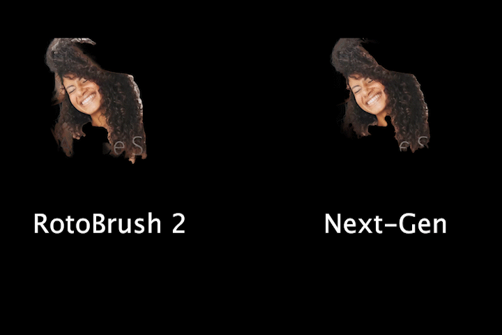

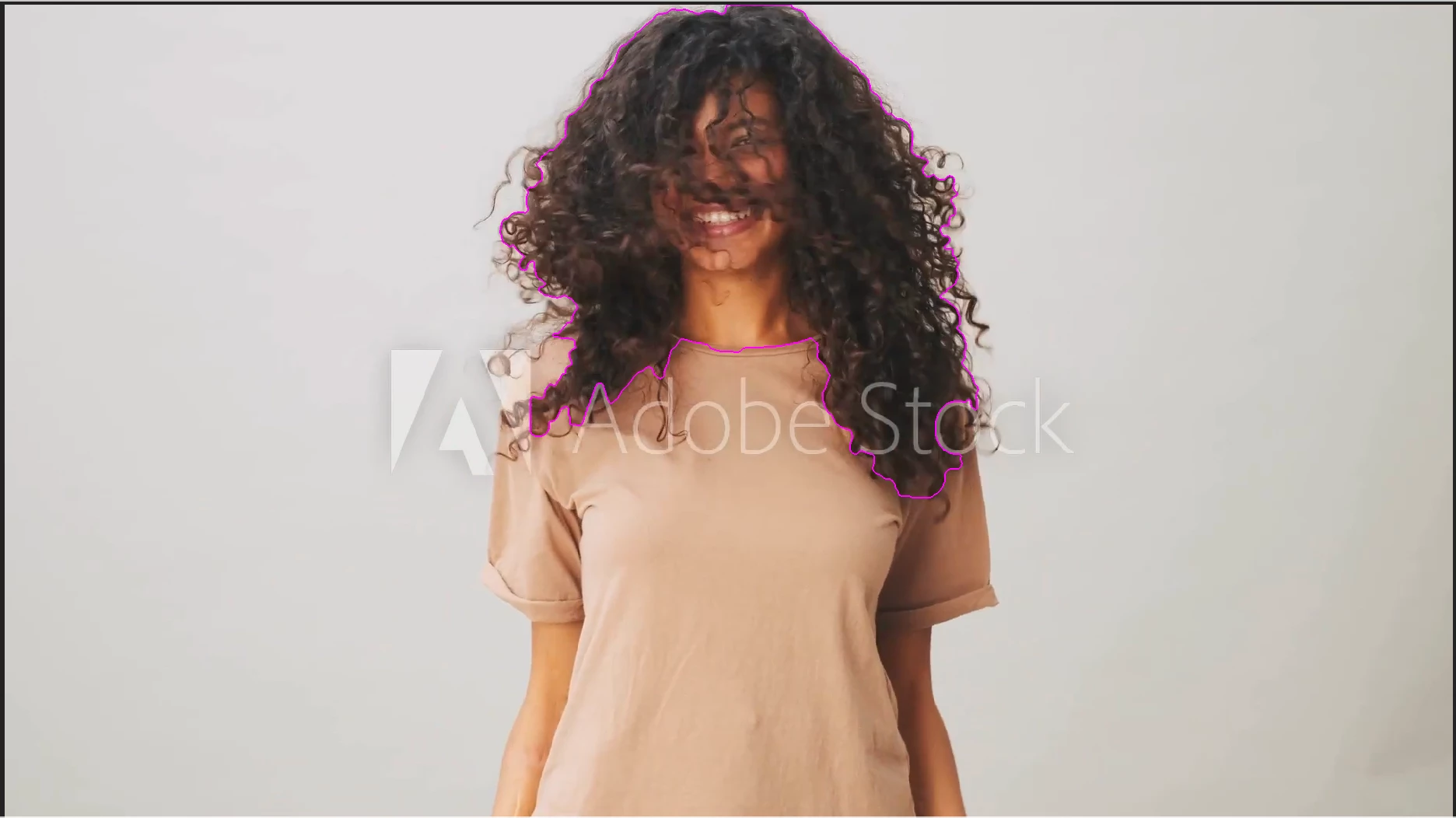

Here’s a quick comparison with RotoBrush 2 (this is raw footage with no refine edges work). Both examples use this frame and selection as the reference:
And here are the results:
And here’s a side-by-side with refine edges work. Both examples use this frame and selection as the reference:
And, once again, here are the results:
To get started, select RotoBrush in the toolbar, double-click an existing layer in the Composition panel and select a frame to start from. Make sure you've selected version 3.0 in the Effect Controls panel and paint a green foreground stroke on the subject you’re attempting to roto and refine as needed.
