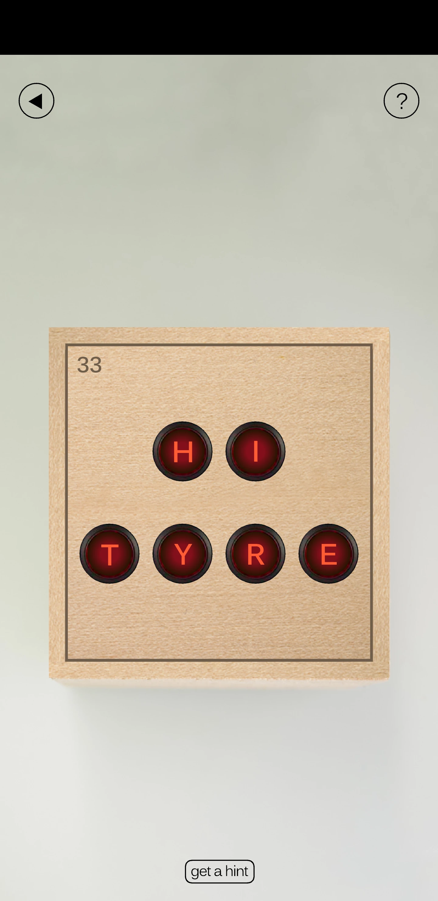

Android phones with a notch: fullscreen starts below the notch so bottom part is cut off
I have reports and screens from users with Android phones with a notch like the Pixel 3 XL, that my apps are no longer fullscreen: there is a black bar on top, the screen starts below the notch, so the bottom part is cut off.
See this example:
How can I solve this? Preferably without using an ANE.
I'm using AIR29 and <fullScreen>true</fullScreen>. Or is this just a question of migrating to the last AIR version?

I think you would need to manually confirm that your app supports "cutouts" for the notch. Have not implemented this myself but it should be the cause of your black bar:
Support display cutouts  |  Android Developers

For your app XML file, are you using a "max_aspect" tag to allow for the extra-tall devices like this?  We had similar issues with devices that were larger than 16:9, and that tag usually fixes the nudging and black bars we were getting.  Here's how ours is set up, within the "android" section of the XML file:
<android>
     <manifestAdditions>
          <![CDATA[
               <manifest android:installLocation="auto">
                    <!-- other tags here -->
                    <application android:hardwareAccelerated="true">
                              <!-- this lets you support devices larger than 16:9 ratio -->
                              <meta-data android:name="android.max_aspect" android:value="2.16" />
                    </application>
               </manifest>
     </manifestAdditions>
</android>
Different values work as well, but you'd need at least 2.06 for the Pixel 3 XL's ratio of 18.5:9.
Dec 7, 2018 7:47 PM UTC
Thanks for the answer Flipline! I was using the max_aspect but with a 2.0 valiue. This has always worked before, but seems like it is now indeed causing the incorrect letterboxing and bottom part cut off problem on recent models.
