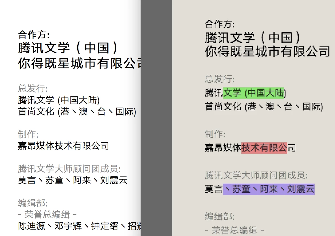

I use Htmlloader for hybrid with as3 displayobjects.  I intensively use jquery, and other javascript libraries to build epub reader.
Even if Htmlloader does not support <video> tag, this way, at least can replace to custom video player by tracking html element's bounding rects.
My current biggest unsolvable problem is HTMLLoader's poor crappy rendering.
Since retina display is now widely spread all over, people's expectation on visual experience extremely high compare to before.
One thing that I can't not bear is that there's nothing I can do about it, such as showing crisp font rendering as other native platform does.
Decision makers in company they don't care why it is not possible to show crisp font rendering, but they just keep asking whether I'm capable to do it or not.
Any solution or any updates on roadmap when it can be done?  I just need to show HTMLLoader text and image as clear as native app.
FYI, rendering comparison between HTMLLoader and Safari. (using css and ttf font)
