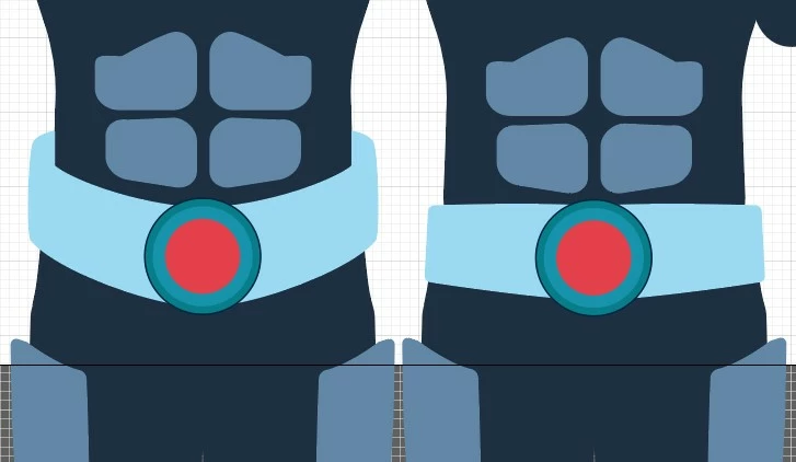

Which brings me to my humble request for advice. I'm in the middle of making some characters for teacher demo's. My background is in 3D game design, so still wrapping my head around 2D flash/animate characters. Just how flat do you make everything? For example, a detail like a belt? Check image I threw together for your convenience. I'm working on a front view currently. So instead of the belt just being horizontal, I want to indicate form by making the belt a little more round. Will this just make things more complicated on the turn around models?  Is is worth the extra effort figuring out the sides when the belt goes in front around to the back? I'm learning edap tools so I know they have a method for welding these objects together, but can my students figure that out? Thanks for the tips you experienced flash pro's can offer. Have a great one. Cheers everyone.

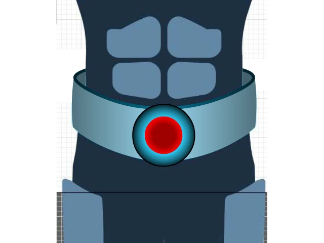

I agree with the consensus that Animate is a cumbersome platform for producing 3D affects. You should consider if it's worth while for your application. However, I can give you a few tips that I use occasionally. One is to use linear and radial gradients. I provide an example with your belt, attached. Let me know if you need instructions.

Thank you for the tips and the image. I will test out the gradients and see how it goes. Thank you for all the advice and the examples.

that said, trying to display a ~3d object by having a figure pirouette isn't (imo) worth the trouble with animate.  you can give some depth by using an oval for a belt as shown in your leftmost figure.

Thanks for the quick reply. Unfortunately, 3D modeling is it's own class, so we are trying to stick to just 2D graphics. No desire to make 3D objects. I just didn't know if it's taboo in 2D. Quick search for flash game characters, it appears like it's normal to give things a little curve. Just wanted to make sure I clarified my intentions and looking for pro's and con's of each style I guess. It seems like a bigger hassle for sure to do curves, because it's got to be mirror reflected majority and dealing with anchor points has been a challenge.
