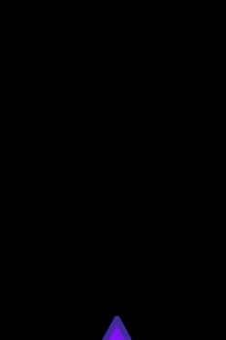

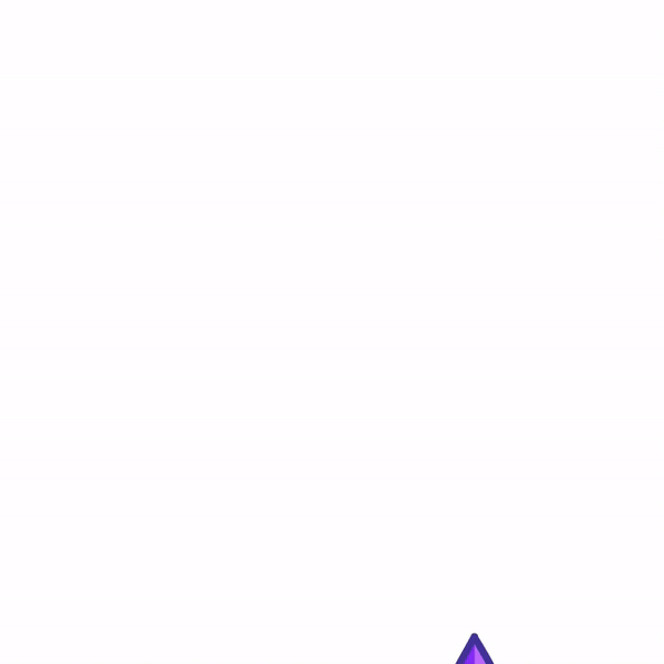

I have an animation with a "shine" overlay which is masked in Animate. I need to export this .swf or video file with alpha channel to After Effects for compositing.
The first attempt to import the .fla file to After Effects resulted in the "shine" overlay blend mode not working and it comes in as opaque.
The second attempt was to export the layers as a QuickTime video with alpha channel. There was a rendering issue and the mask from Animate was not properly handled resulting in the "shine" box being visible outside of the mask. Also, the blending mode does not look the same as in Animate.
Is there a better workaround for this issue? I was thinking to possibly export the bits animation as a .swf and the shine as a .swf and composite them together in After Effects. I will try this for now until a better answer comes around. Thanks.

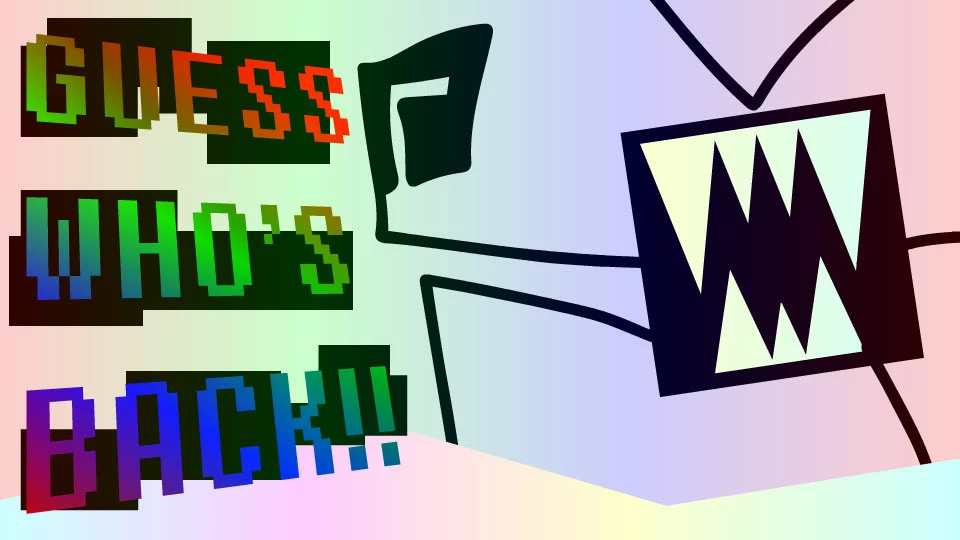

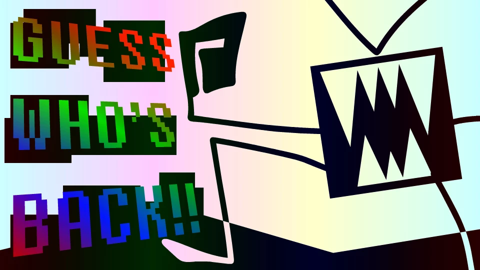

Exporting it to media encoder (file>>export>>export video/media) worked perfectly fine for me when exporting a single image that had blending and masking:
exported from Media Encoder
exported from Animate
