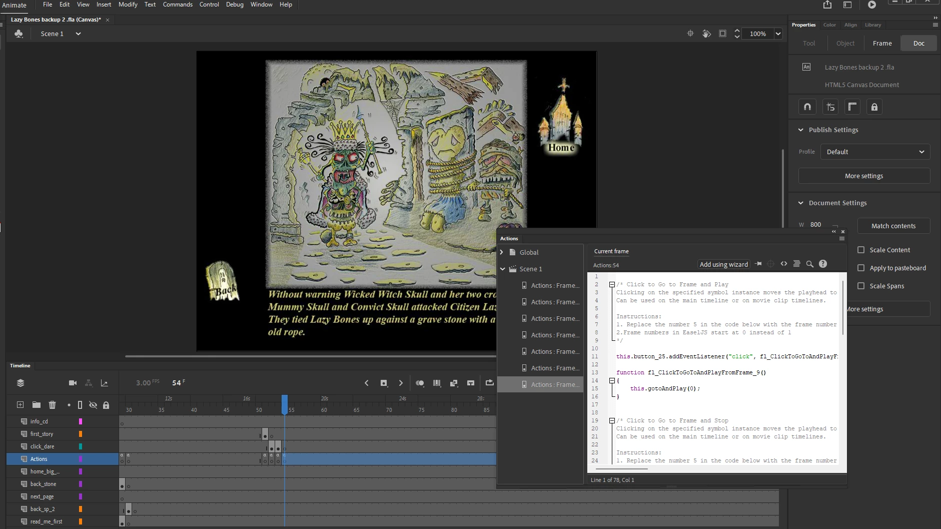

Hi Guys
I have a lot f button in my project. I am making an interactiv book 28 pages in all. each page has on average 3 buttons a back btn, next btn and home btn. Some pages also have buttons for frame by frame animation all working well. My problem is on the 7th frame/page of my book I put in the usual 3 btns back,next and home, they roll over and change colour ok but they dont move to their asigned pages.
Help! Alan Y

    Alan5E07Author
    Jul 25, 2023 2:01 PM UTC
    kglad
    Jul 25, 2023 2:23 PM UTC
    check your button's instance name.
    if that fails to show the problem, carefully copy the instance name from your code, remove your button from the stage, re-add your button to the stage and paste the button name (making sure there are no spaces) and retest.
    Alan5E07Author
    Jul 27, 2023 3:36 PM UTC
    Hi
    Removed the button and gave it an instance name and all working now. I think the problem was i let the computer add an instance name and it just gave numbers whitch caused a lot of confussion because i could not remember what numbers went with the buttons but giving them all an instance name from now on. Lesson learnt!
    ps. Also confussion with program start frame 1 and actions starting at 0 and just add to that if button going forward put one number less but if button going back to frames you need to go two numbers less.  Hope that make sense!.
    Anyway all working well now fingers x.
    Thanks again
    Alan Y
