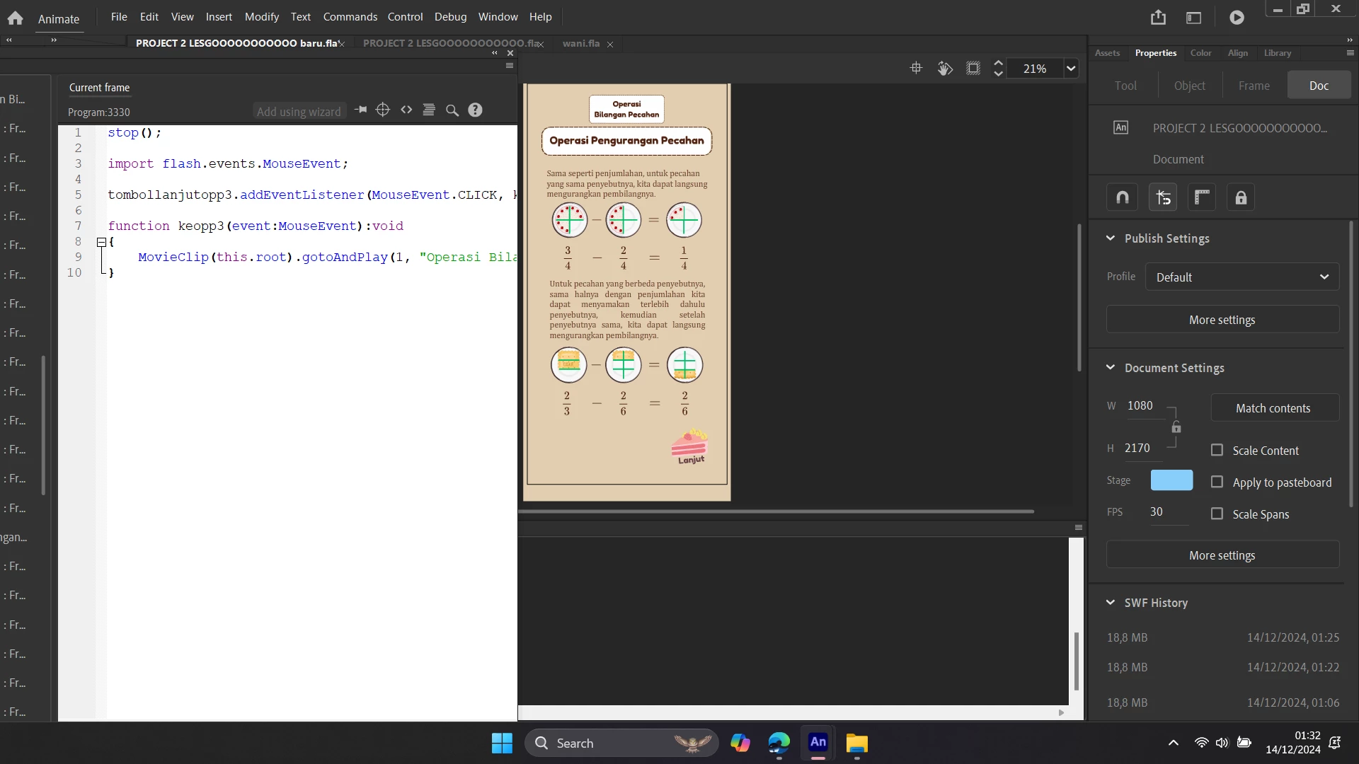

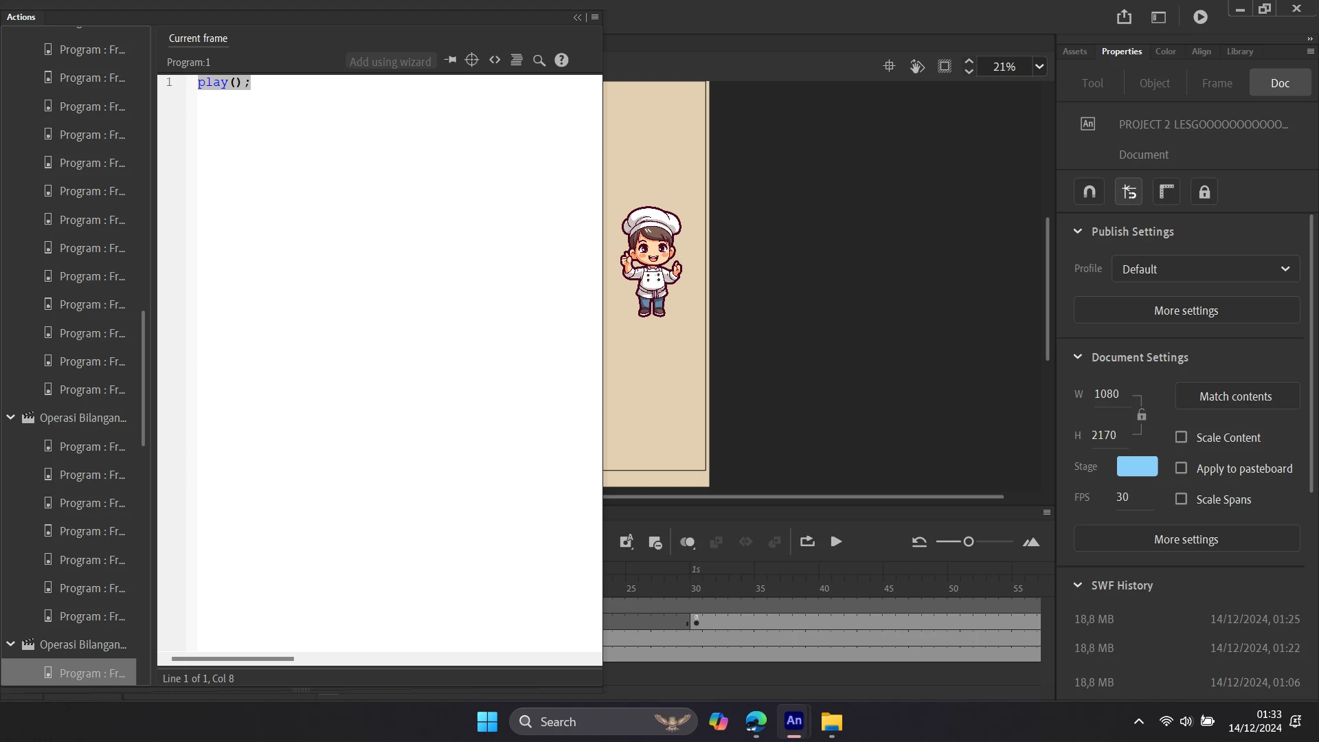

I am currently working on an animate project, but I have a problem that I am confused about. That is when testing swf or publishing apk, when pressing the next button, the animation does not continue. In fact, previously with the same code. It runs normally. What is the solution? I have tried moving the problematic frame to a new scene. But it did not work. Please help me!

    is it possible, if i reduce my frames in one of the scenes with the most frames. Will it run normally because it is less than 16000 frames?
    keeping below 16k should work.

    yes, i have a problem. i have two different scenes and actually many scenes, but there is a scene that is always still not moving during the test movie. when i change the order of the scene sometimes it runs but there is another scene that does not move. my solution is to make it in one scene but limited to 16000. What is the right solution.

    before i had a new scene, initially the 2 parts were in one scene. but in the middle of the scene when pressing the continue button, the scene stopped and did not advance to the next frame.
