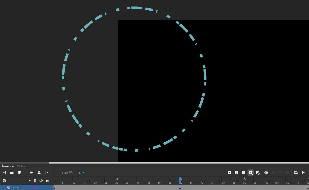

      Thanks your example work on your graphic, I tried to somehow set it in the same way, but my problem is (well if that's indeed the cause) that my dotted outline is non-uniform dashed pattern (some lines are shorter, some longer and same with the gaps) and  when I just set the three keyframes on the main timeline and set the first part to play once and second to play in reverse, the are again not in the same spot so instead of that the circle would seems to stop and turn the opposite way it just totally change its "location" (because suddenly the dots are in way different place) and I'm not sure how to replicate the correct alignment . you can see from the attached screenshot that last frame of the first part and first frame of the second part has the circle in totaly different position
