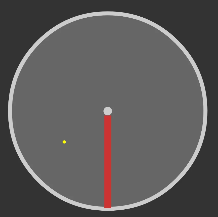

I'm trying to count how many turns the yellow dot (this.area_mc.yellowDot_mc) makes before reaching the center or edge.
The yellow dot goes from the edge to the center and then back. I placed a vertical rectangle (rect_mc) and tried to identify the number of turns made with hitTest, but I don't think I was able to make the coordinate transformation work. The rectangle can be either inside area_mc or outside, but the yellow dot must be inside the area. I tried all localToGlobal, localToLocal, globalToLocal methods but I was unsuccessful. link to the .fla file: https://drive.google.com/file/d/1UPHJDcEc6sps58bExh6dNnwDuAXLwLJ8/view?usp=sharing
I thank you for your help.

Hi.
If you want to stick to the collision detection approach, you just need to change this line:
var pt = yellowDot_mc.localToLocal(0, 0, rect_mc); // instead of ...(yellowDot_mc.x, yellowDot_mc.y, rect_mc);
This method expects internal coordinates.
JC

in general, a hittest isn't going to work for this unless you add constraints and are careful to ensure exactly one + hittest per 2 pi revolution of the dot.

A suggestion: Why don't you convert the coordinates of the yellow point to polar coordinates and compare θ to some predefined value? In this way, it will be clear when the point crosses a given "meridian", despite of the distance to the pole.
function cartesianToPolar( centerX, centerY, x, y ){
	var dx = x - centerX;
	var dy = y - centerY;
	var r = Math.sqrt( dx * dx + dy * dy );
	var theta = Math.atan2( dy, dx );
	return { r:r, theta:theta };

Your solution is very elegant. Congratulations and thank you!

not much is saved by converting to polar.  you can just check the angle (and, if you find it easier, you can change the angle and angle_inc variable names to the ones you used):
var rect_mc = this.area_mc.rect_mc;
var area_mc = this.area_mc;
var yellowDot_mc = this.area_mc.yellowDot_mc;
var tempoDeMovimento = 20; // milissegundos para o listener
var angle = 0;
var angle_inc = .1;  //para incemento ser igual ao índice
var seno;
var cos;
var circRadius = 300; /*raio máximo*/
var flagSentido = 'reduzindo'; /*direção sentido centro ou borda*/
var contarChamadasDeMovimentos = 0;
var contarVoltas = 0;
var count = 0;
createjs.Ticker.addEventListener("tick", fn_Spin);
createjs.Ticker.setInterval( tempoDeMovimento ); /*tempo de atualização*/
function fn_Spin(event) {
seno = Math.sin ( -angle ) * circRadius;
cos  = Math.cos ( -angle ) * circRadius;
// new code
angle = (angle+.1);
if(angle>=Math.PI*2){
angle=0;
count++;
console.log(count);
if ( circRadius < 0 ) {
flagSentido = 'crescendo';
contarVoltas = 0;
console.log(count);
count = 0;
console.log('< 0 ')
} else if ( circRadius > 300 ) {
contarVoltas = 0;
console.log(count);
count = 0;
console.log('> 300 ')
if ( flagSentido == 'crescendo' ) {
circRadius = circRadius + .1;
} else if ( flagSentido == 'reduzindo' ) {
circRadius = circRadius - .1;
yellowDot_mc.x = seno;
yellowDot_mc.y = cos;
