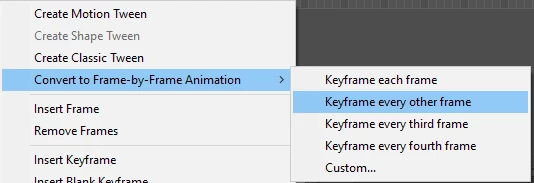

Hi mate,
You should work inside a container where all your tweens are on ones.
On the outside the container should be set to Play Once.
Then you select it and right-click to choose - Keyframe every other frame
When this is done you select the whole range of frames with Edit Multiple Frames and stop them.
The result will be animation on twos, referring to frames 1, 3, 5, 7 and so on on the internal timeline.
You can still keep working inside the container; Main Timeline will always preview on twos.
Very easy...
and quite pointless in my opinion. Aesthetically you will not gain anything.
If you want to do all animation on twos just set your document to 12 or 12.5 fps and then 50% speed in Premiere before rendering the video.
I've seen studios do this in the Flash 8 days to save time and processing power. Results again are not as good as one might think.
Twos suit hand-drawn animation well because not only reduce the amount of drawings needed but also also reduces the flickering due to imperfections of the linework.
Hope this helps!

Hi mate,
Very easy...
Hope this helps!
NT

Your method works perfectly for me.
Of course, as you say, I get the same aesthetic result.
However, by maintaining the nondestructive state of the tween, I can more flexibly respond to frequent client retake requests.
Thanks!
